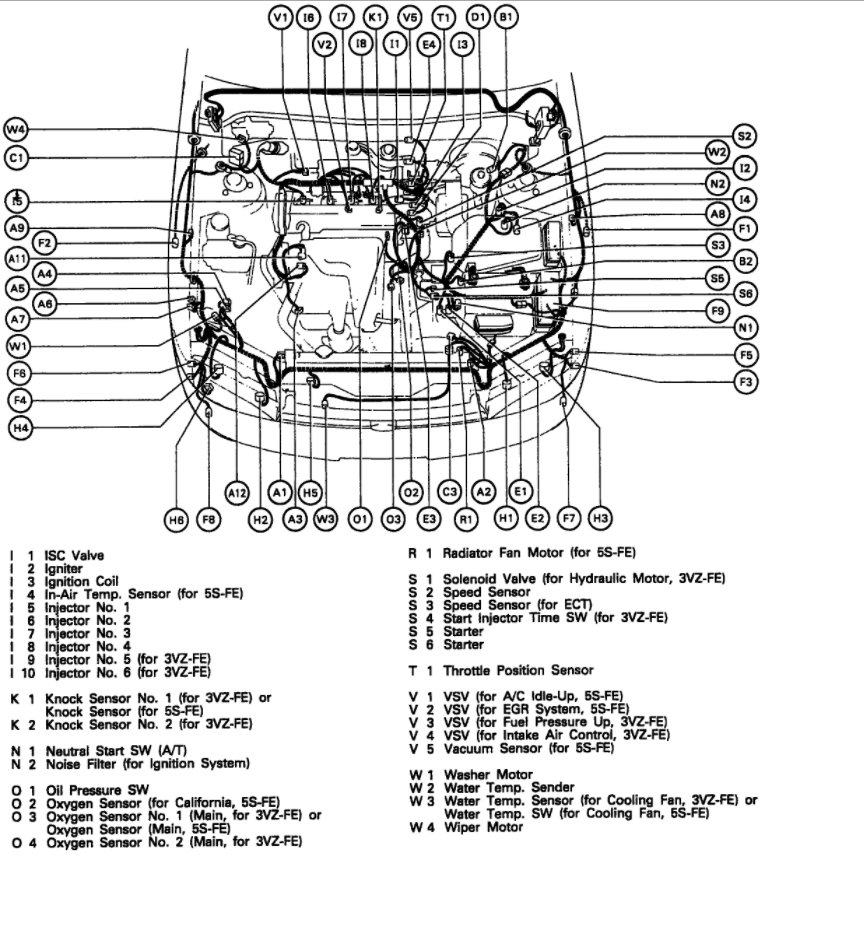

I have noticed right after I bought the vehicle that nothing on the dashboard cluster worked except the PRND2L lights. I went to a scrap yard and got another cluster and replaced it. Now everything works except the speed odometer and the odometer. What can be the issue?
Jun 10, 2017 at 8:26 AM
  • 55,710 POSTS
It sounds like you have a vehicle speed sensor that is out. Here is its location so you can try a new sensor to see if that fixes it.
Please let us know what happens, we are interested to see what it is.
