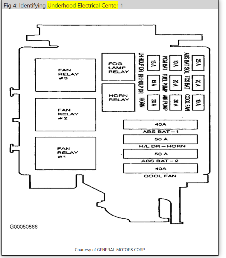

2000 HOLDEN COMMODORE
162,000 MILES • V6 • 2WD • AUTOMATIC
JACQUELINE MORRIS
Dashboard lights speedometer fuel gauge nothing works
Aug 28, 2020 at 8:24 AM
  • 55,433 POSTS

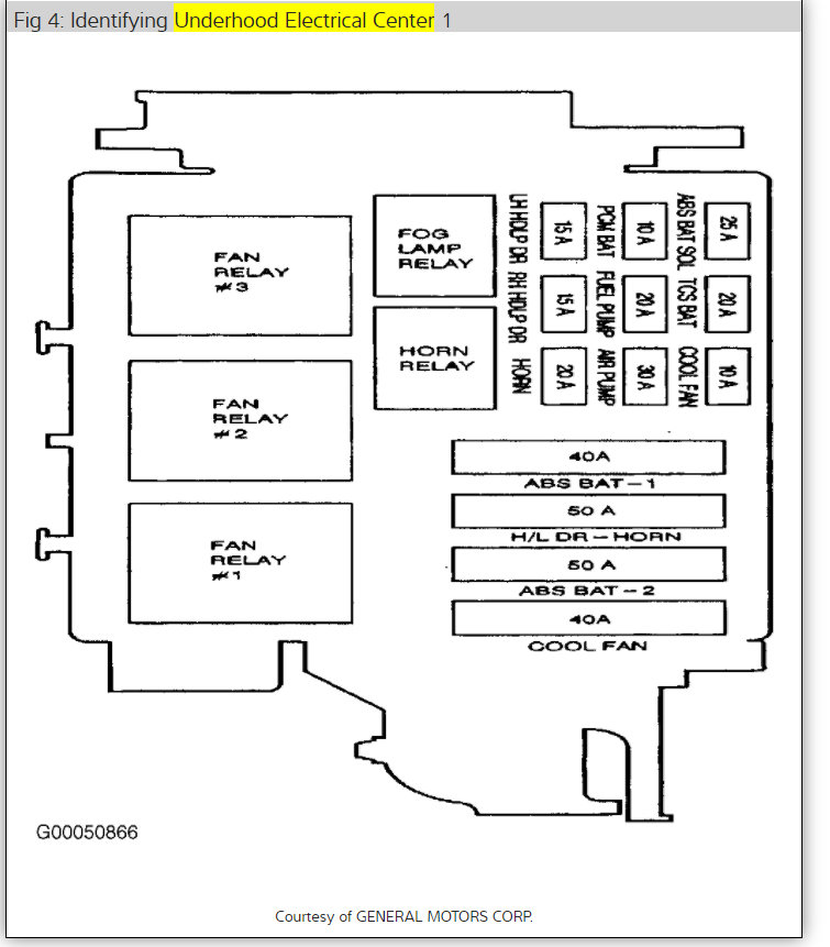

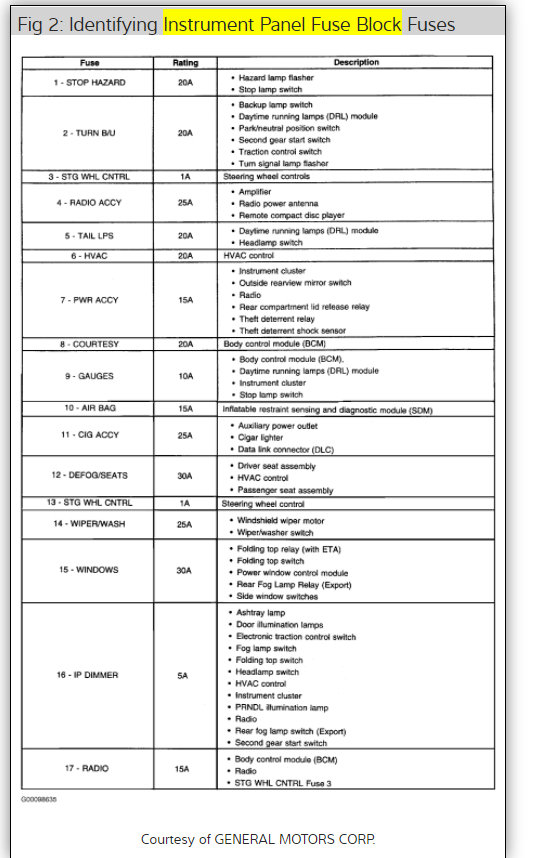

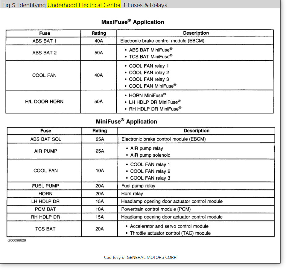

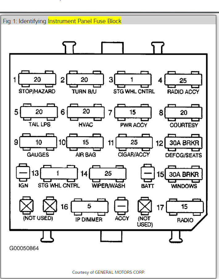

Sorry for the slow response. lets start by checking the fuses that control the panel. This guide will help with the wiring diagrams to show you how the system works and which fuses to check I have also included the fuse locations as well:
