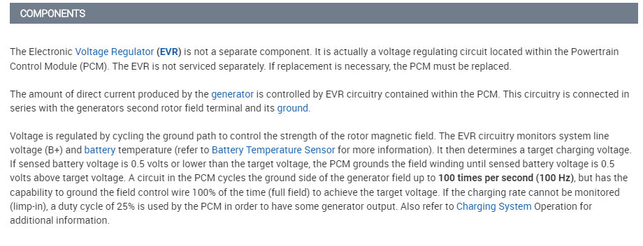

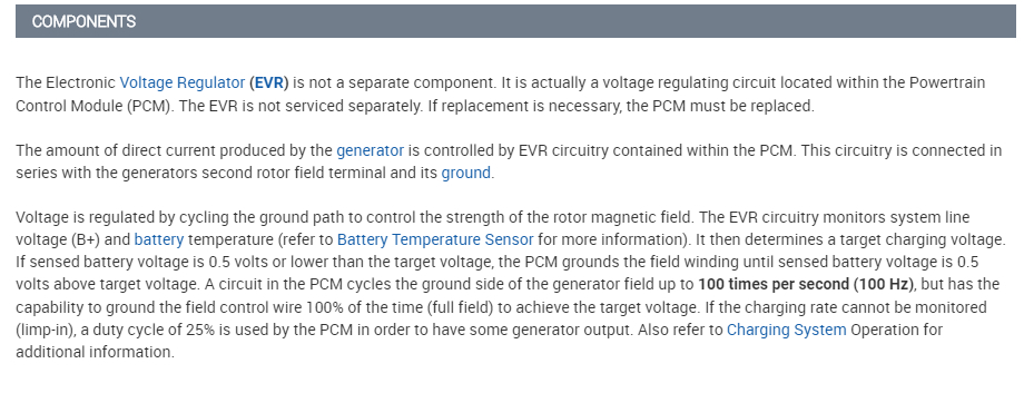

Is this possibly an internal voltage regulator failure?

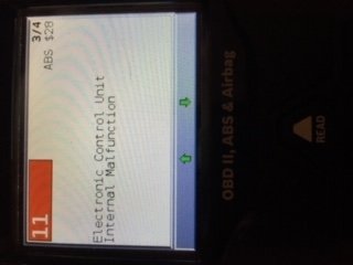

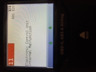

If there are no codes, what is telling you that this is an internal module failure? Maybe send a picture of the scan tool to get us on the same page. Thanks

I didn't connect my thoughts well when I brought up the internal voltage regulator as the cause of the running rough. I'll try again. Since the digital odometer and the rough running consistently and simultaneously occur at 1000-1100rpms, my thought is that they're connected. Since the alternator output reaches 17.0-17.1 volts at that rpm, my thought is that the PCM output is jumbled at that voltage. It starts without error. Under 1000rpms, it'll rum for 30 minutes with out error.
I bought the scan tool specifically for this problem. Prior to this usage, I have no experience with one. In getting the tool screen image I noticed the big red box with "11" in it. So my earlier claim that there wasn't a DTC number could be wrong. I don't know where to find what the "11" means. Hopefully the scan tool screen image that you asked for will attach.

So I'm fairly confident that the high alternator output is the problem. Based on internet research, there are (3) options available to me. I'm choosing the external voltage regulator path.

I installed an external regulator and an auxiliary control relay for it. The regulator eliminated the alternator over-voltage condition, bit it didn’t entirely solve the rough running condition. I decided that the PCM was damaged beyond what I could fix.
I bought a reconditioned PCM online. That process was really easy-fill out an online form, pay, and 3 days later the rebuild unit arrived. Installed it and the vehicle ran flawlessly. Alternator is totally controlled, no rough running at any RPM, volt meter works, no problems. I even created an engine fault to verify that the CEL works.
So my lesson here is to keep looking until enough puzzle pieces are found. I wouldn’t have ever thought a PCM would fail partially.
