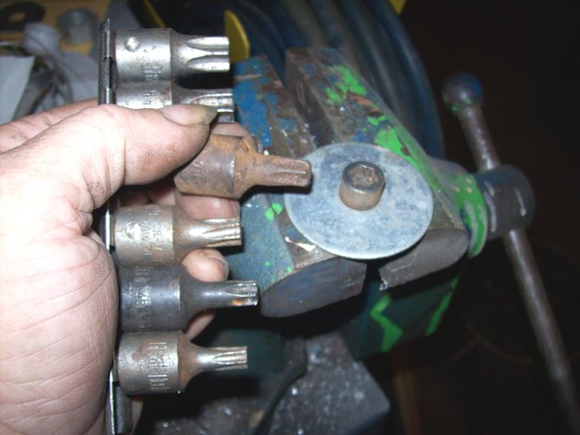

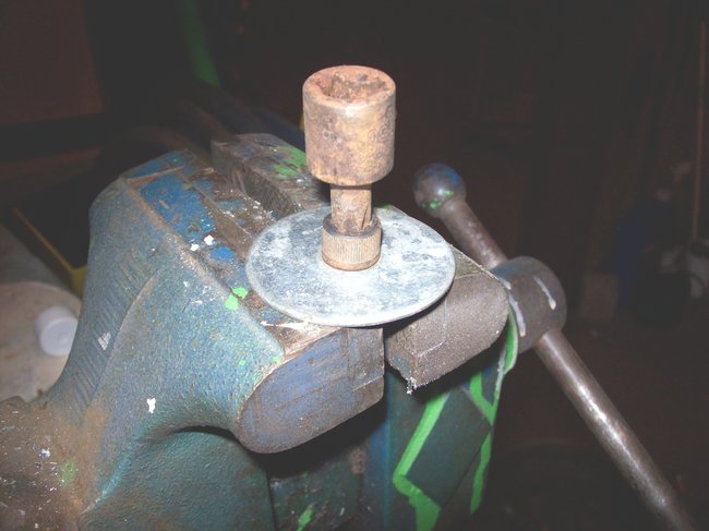

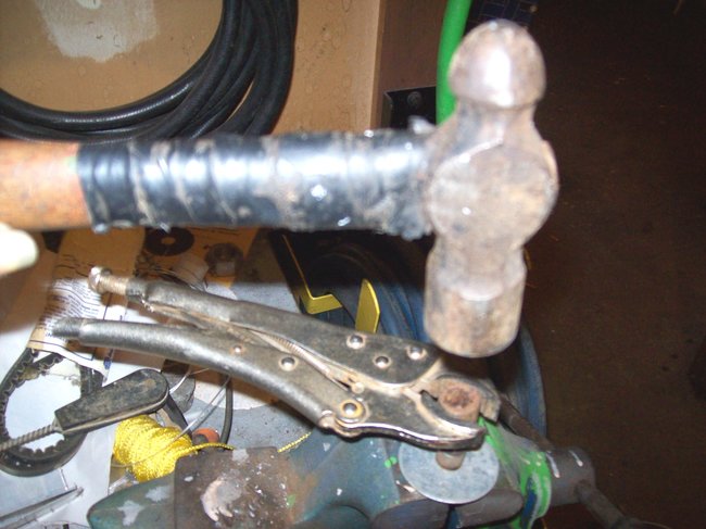

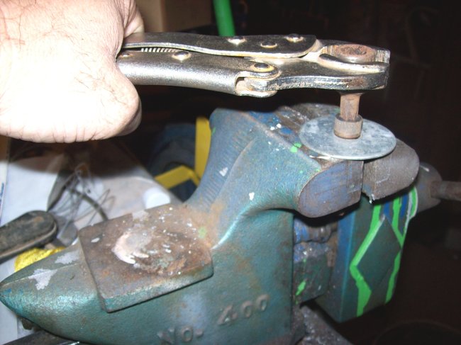

This might help if you have some stubborn torx bolts. See my link and pics below. Before you really get on one hard (may break your bit off) Try my technique.
https://www.2carpros.com/questions/jeep-wrangler-1997-jeep-wrangler-swaybar-link-replacement
Keep us posted on progress!
See-uns how I have done threw all of my torx bolts into the woods, I had to demonstrate with a allen bolt in my pics. Also you wanna hold good pressure on the torx with the vise grips while you tap the torx socket with the hammer. I only had 2 hands in the pic, So I held the hammer and the camera!
