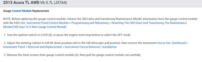

I'm just wondering how to go about changing the light bulbs behind my cluster (like the speedometer etc.) i bought lights that said they'd fit my car but can't find light bulbs in it anywhere. Also, don't know where they are for the heated seat buttons either.

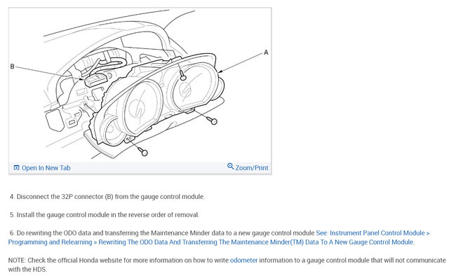

The bulb should be accessible from the rear of the cluster. here is how you can remove the cluster and get to the bulbs, if you have any trouble, please let me know. Check out the diagrams (below). Let us know what happens and please upload pictures or videos of the problem.

I removed it but saw no bulbs. They're LED tiny little bulbs on like a circuit board. And in the process of looking for them, i somehow messed up my gauges, because my temperature gauge doesn't work at all and the speedometer is off.

Sometimes it is best to get a rebuilt cluster from a place like AER, but you can do a search to find someone that can send one out to you, have your VIN number and milage ready.

Well, I know how to get the instrument cluster out but then where do i find it and how do i get to the bulb?

You will have to disassemble the cluster to see the bulbs, they may be soldered in.
