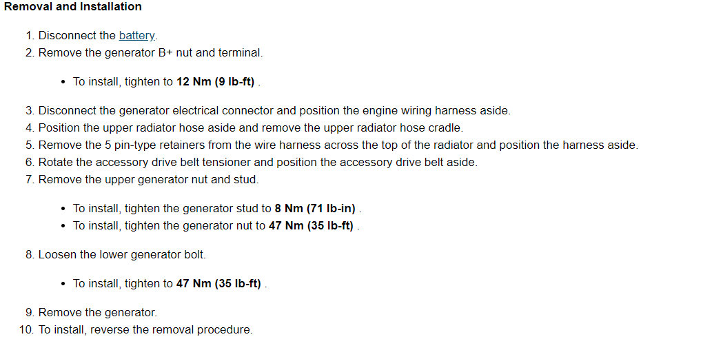

All my dash light come on, the check charging system and low fuel come on. The speedometer goes to zero. It does not do it all the time only when I drive the car too much. The car runs fine with all the dash lights on.

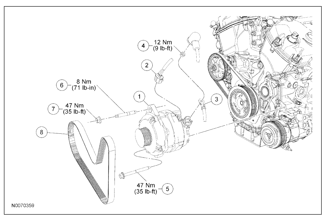

This sounds like you have an alternator that is going out. Here is a guide to help you see how to test it:
and if bad here is what it will be like to change it out.
https://www.2carpros.com/articles/how-to-replace-an-alternator
You can get the alternator from Amazon for $177.00.
https://www.amazon.com/gp/product/B002E3L42E/ref=as_li_qf_asin_il_tl?ie=UTF8&tag=2carprcom-20&creative=9325&linkCode=as2&creativeASIN=B002E3L42E&linkId=615ae18d4d88ac4b12630ee5c944e676
Below is how to change the alternator on your car.
Please run this test and get back to us.
