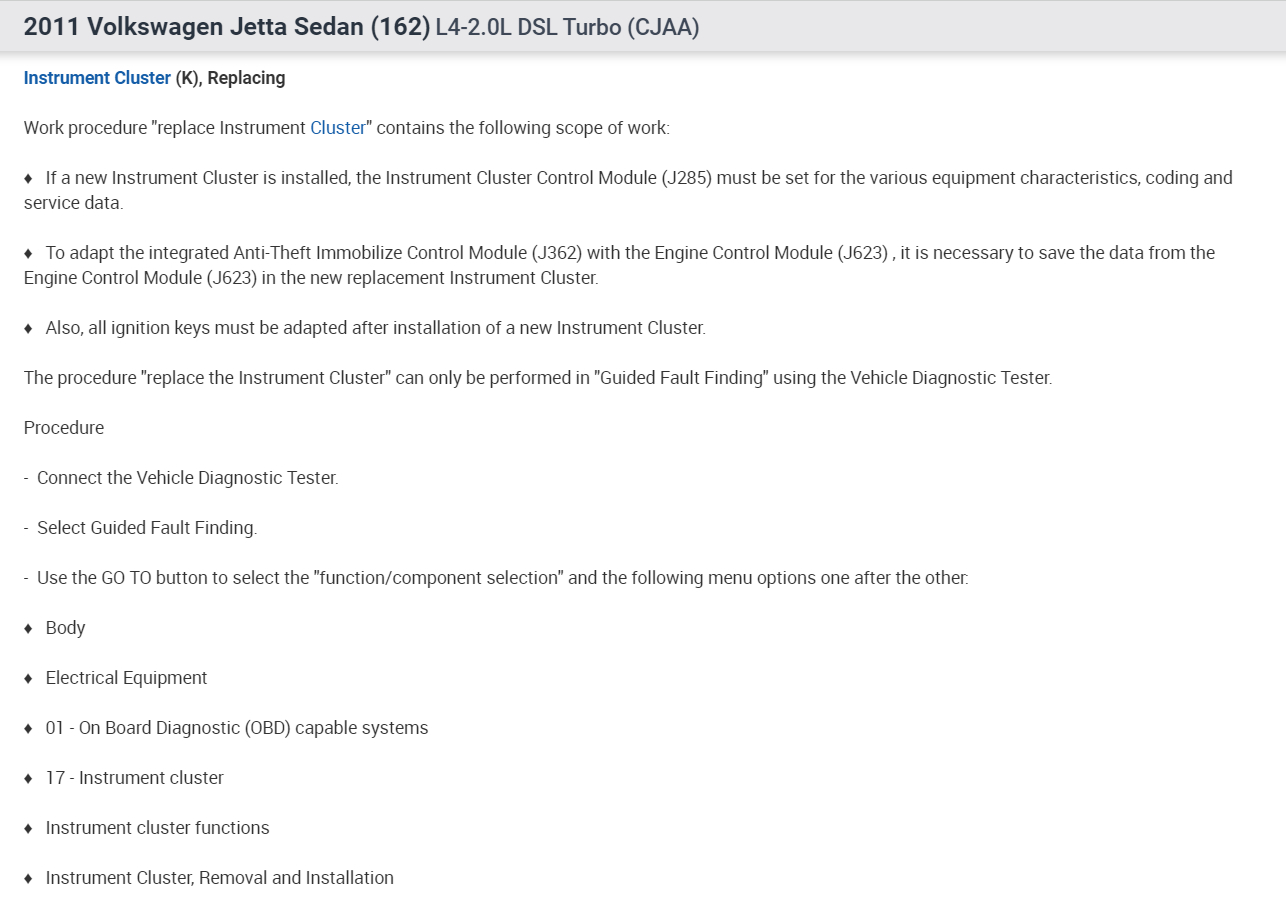

In the cold morning when i start my car after few minutes, my dash light of the warning of the parking brake, airbag, epc,drl. i pull over, turned off the car and restarted it again, it not on. what can cause this?

It sounds like the dash module is going out and restarting the process resets the module. To be sure we should do a CAN scan you can get a CAN scanner (Controller Area Network) from Amazon from about $32.00.

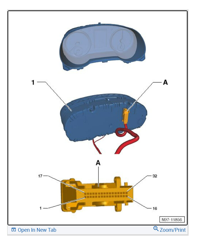

Here is how to change out the cluster module in the images below in case you need it. You can get a rebuilt unit by searching google or eBay. Check out the images (below). Please let us know what you find. We are interested to see what it is.
