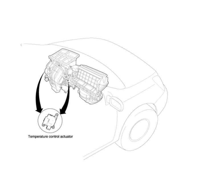

I have no heat on the passenger side of my van. I was told it probably was the damper actuator. I could only find instructions for a 2007. The dash is not the same as my van. How do I get to the damper actuator? I cannot find any information for year and model of my van.
Oct 15, 2017 at 4:50 AM
  • 55,433 POSTS

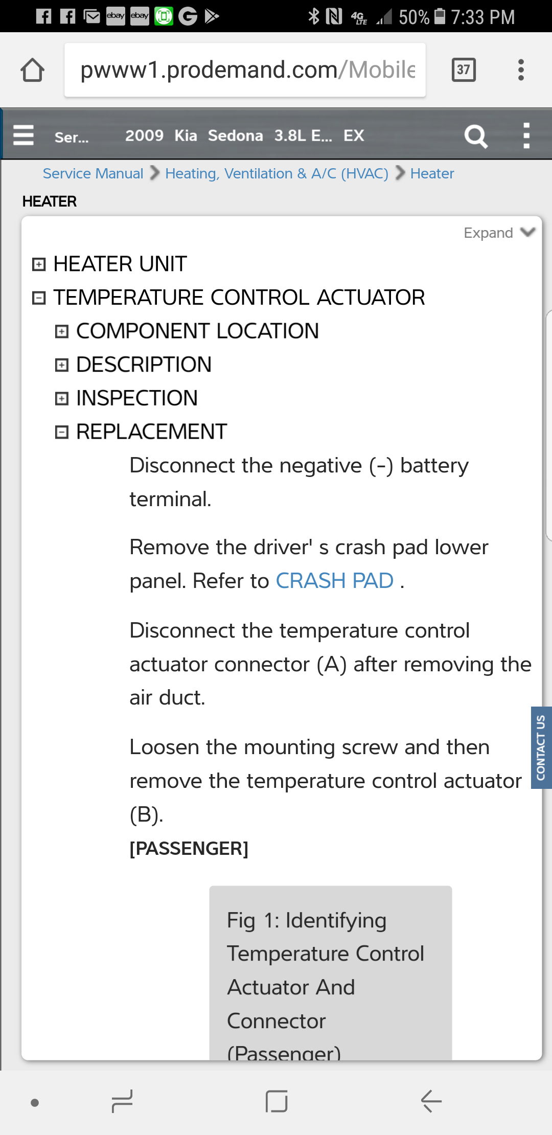

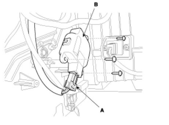

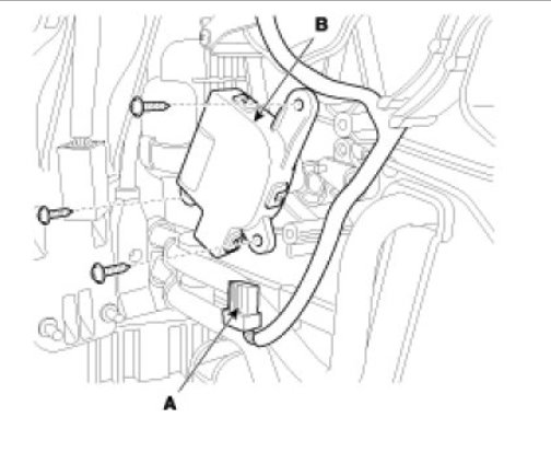

It sounds like you have a temperature blend door actuator that needs to be replaced.
Here is a guide to give you an idea of the repair:
Here is what it is like on your car (below).
Oct 16, 2017 at 9:43 AM
SATURNTECH9
  • 30,869 POSTS

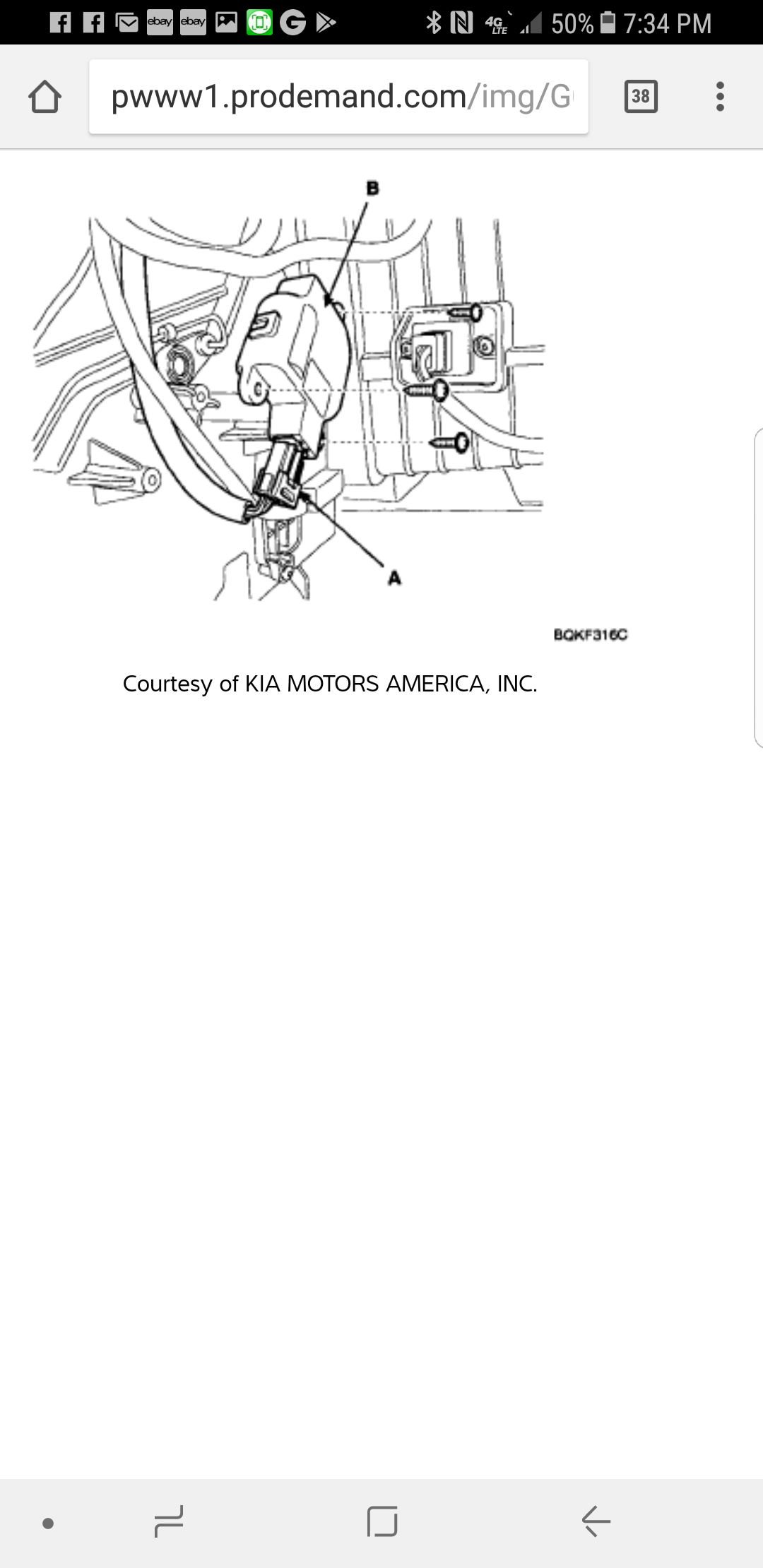

I posted instructions and diagram of your exact car.
