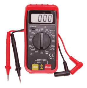

What is the meter that I need to get?
-Dan
Sep 21, 2009 at 1:12 PM
RACEFAN966
  • 5,029 POSTS
Here is a pic of the meter. Should be more then about 20 dollars.
https://images.2carpros.com/forum/automotive_pictures/249564_14572_1.jpg
