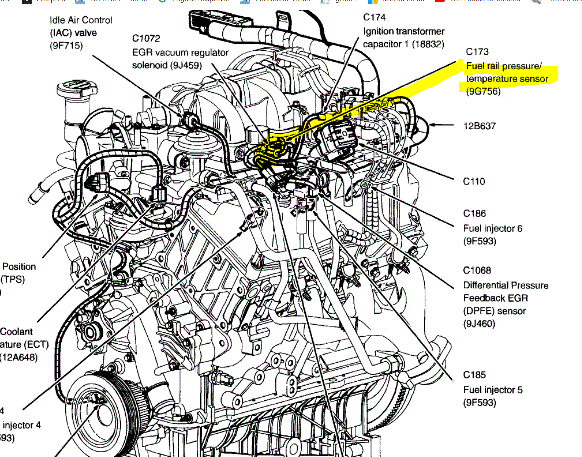

I also need to know if the fuel rail or fuel tank pressure sensor was replaced. This code is specific to the fuel rail pressure sensor. I realize you indicated the code definition, but I just want to make sure that is the one that was replaced. See pic below
See attached pic.

Hi Joe, it was the fuel rail pressure sensor that I replaced. I have also replaced the evap canister purge solenoid about 2-3 months ago.

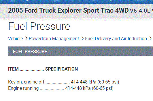

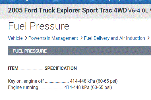

If they are wet, either we have too much fuel or a temporary loss of spark to the plugs.
As far as the pressure, 72.5 is too high. It should be between 60 and 65 with the key on the engine off or when it's running.
I attached the manufacturer's fuel pressure specifications below. (pic 1)

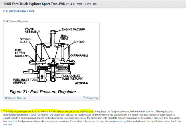

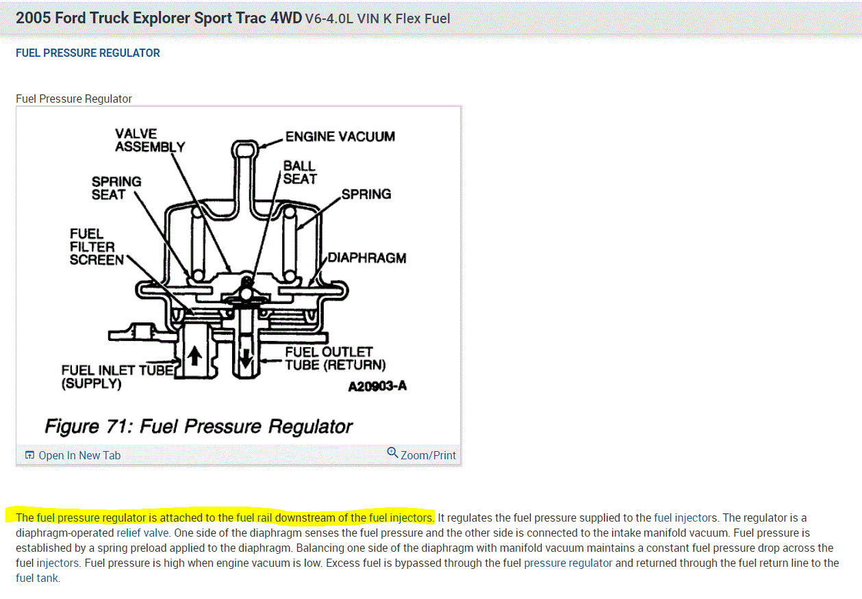

The second pic shows a pic of the fuel pressure regulator and describes its function and location. There will be a vacuum hose to it. Make sure that hose is attached and not cracked or damaged in any way. Then, remove it and check to see if there is fuel in the vacuum hose.
