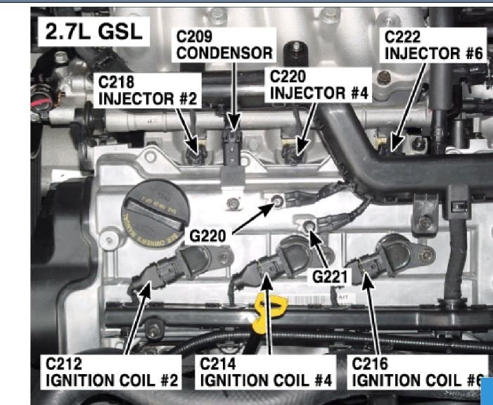

I am having a cylinder 2 misfire. I am not sure which cylinder that is. I believe it is the far left one closest to the radiator, but the guy at AutoZone thought it was the furthest left closest to the closer the body. If anyone knows for sure which cylinder is number two i would appreciate it.
Is this the correct order of the cylinders?
135
246

I attached the cylinder order for you.
The front bank is 2-4-6.
As far as the misfire, make sure you test the compression.

That is the correct firing order. I figured it out. Ended up being the ignition coil.
Jun 6, 2020 at 7:23 AM
BRIANPAULF
Thank you so much for the information. I switched the coils around and the code changed to the other cylinder. Once again, thank you so much for the time and information. I greatly appreciate it.
