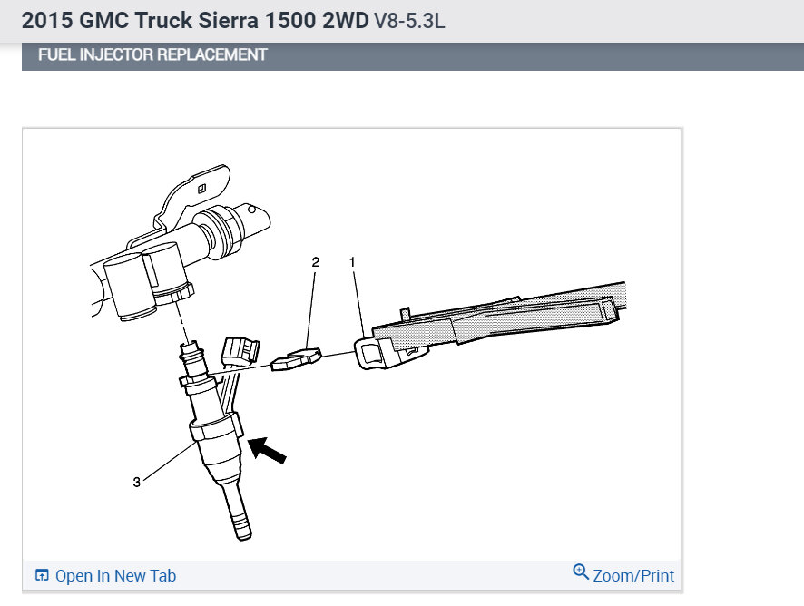

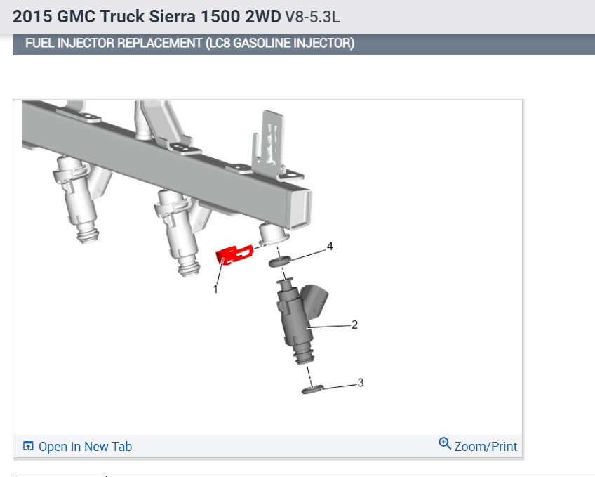

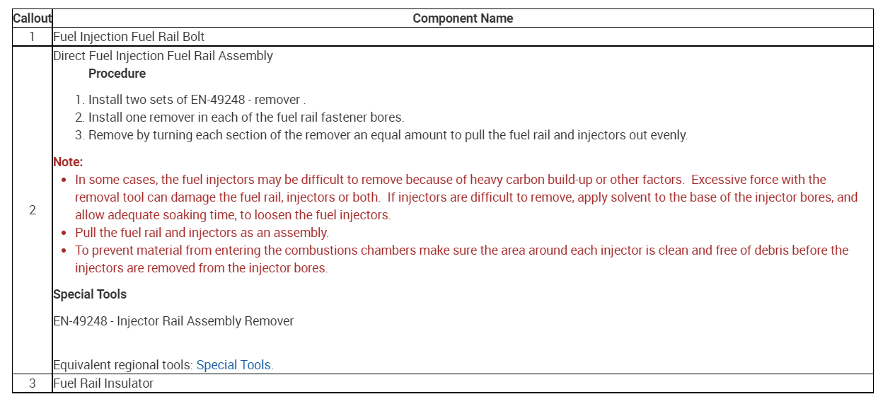

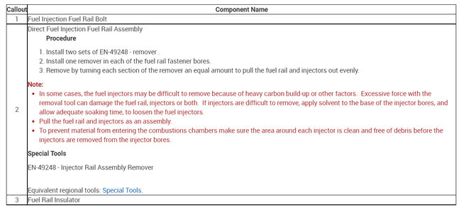

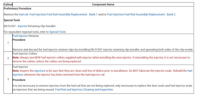

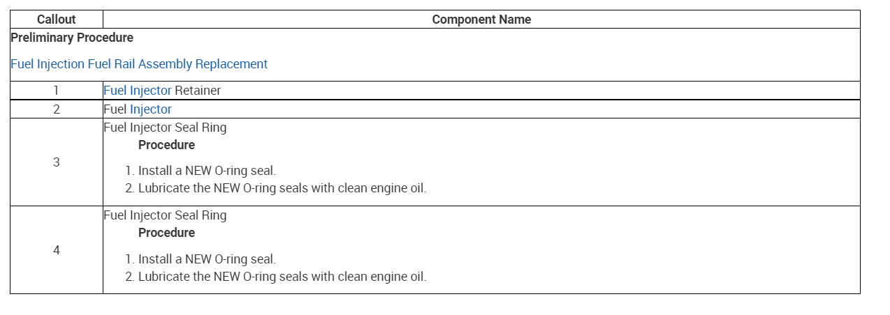

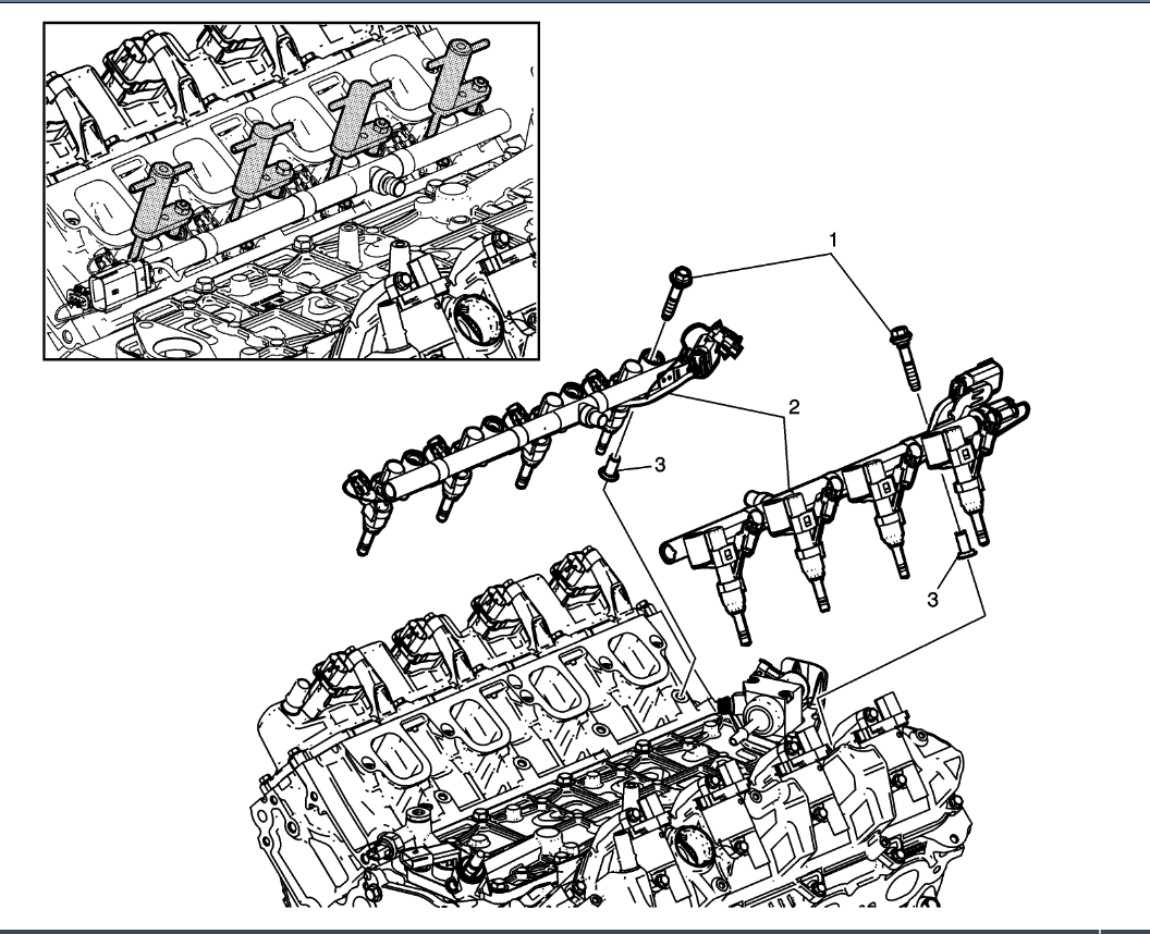

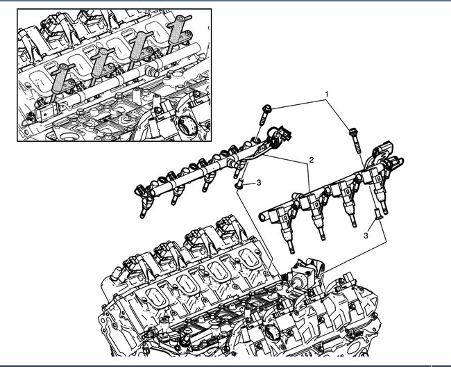

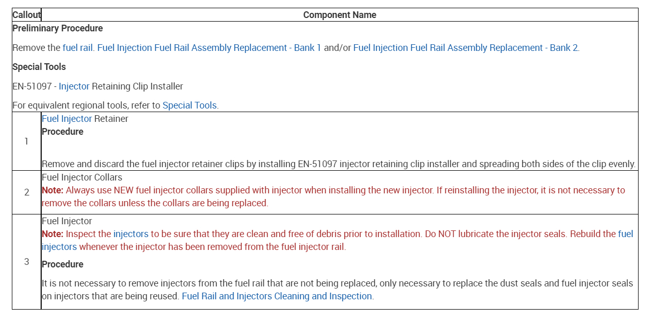

I already replaced the plug on that cylinder and there was no change. I also moved coil packs with no improvement. We hooked it up to the scanner and the injector for cylinder 8 wasn’t running the same as the others so we believe that’s the issue.
Oct 3, 2022 at 10:59 AM
  • 55,433 POSTS
Yep, that was going to be my next suggestion. here is how to change it out, I would use AC Delco parts. Check out the images (below). Please let us know what happens.
