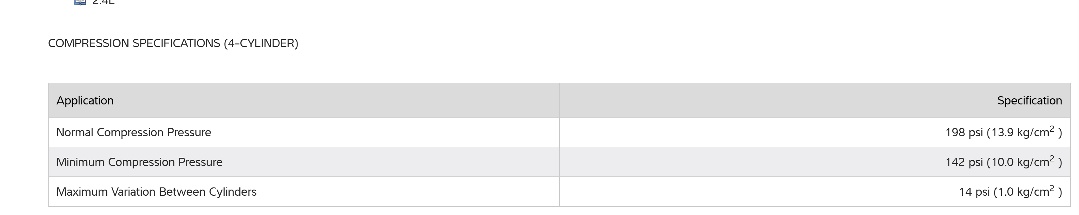

According to my information you should have 198 PSI for compression with no more than a 14 PSI difference between cylinders. The minimum compression you should have is 142 PSI.
So, it is more than likely misfiring because the compression is so low.

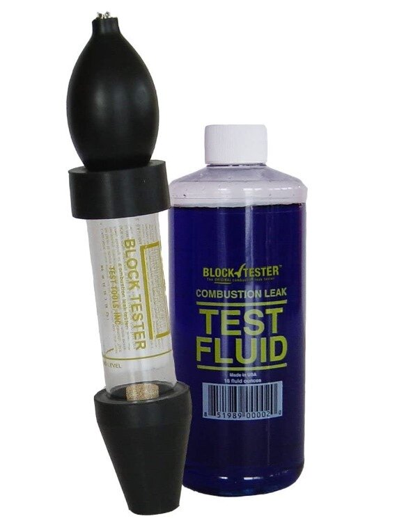

A head gasket is another option. If it is a head gasket you will have Nitrogen Oxides or NOx for short, in your cooling system as part of the combustion process.
You can test for this using a special color changing liquid called block tester.
Here is a link but any auto parts store will have it:
https://www.amazon.com/Block-Tester-BT-500-Combustion-Leak/dp/B06VVBSFTF/ref=asc_df_B06VVBSFTF?tag=bingshoppinga-20&linkCode=df0&hvadid=80333123589171&hvnetw=o&hvqmt=e&hvbmt=be&hvdev=c&hvlocint=&hvlocphy=&hvtargid=pla-4583932709121118&psc=1
Make sure to reduce the amount of coolant in the system so it doesn't get sucked into the tester.

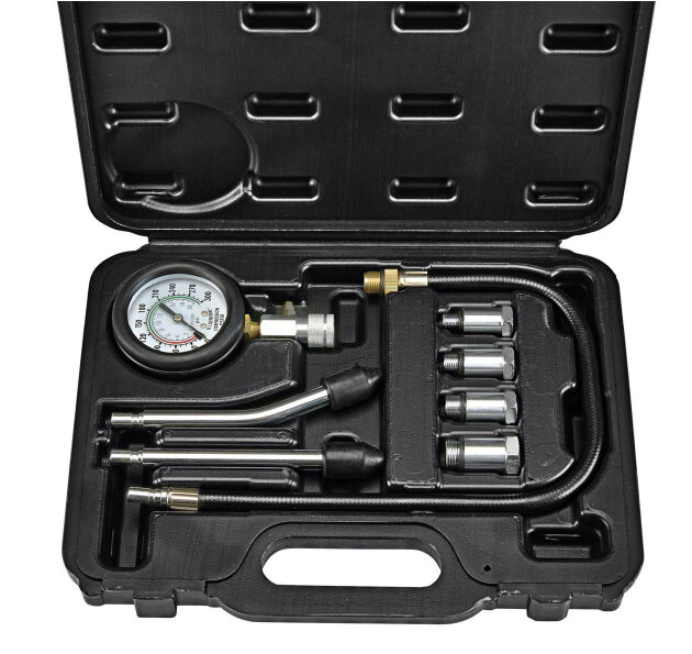

Unless the compression test was done wrong or the tester you have is broken or wrong, you have a compression issue. If you are renting it from an auto parts store it could be a bad tester because people rent them and throw them around. You might want to just get your own if that's the case.
I found one for you. It' s a good brand Pittsburgh Automotive.
https://www.harborfreight.com/compression-test-kit-8-piece-62638.html?utm_source=bing&utm_medium=cpc&utm_campaign=425671834&campaignid=425671834&utm_content=1154488236059904&adsetid=1154488236059904&product=62638&store=639&msclkid=2b4fde147aac1f88b4caba6d9e86d986
