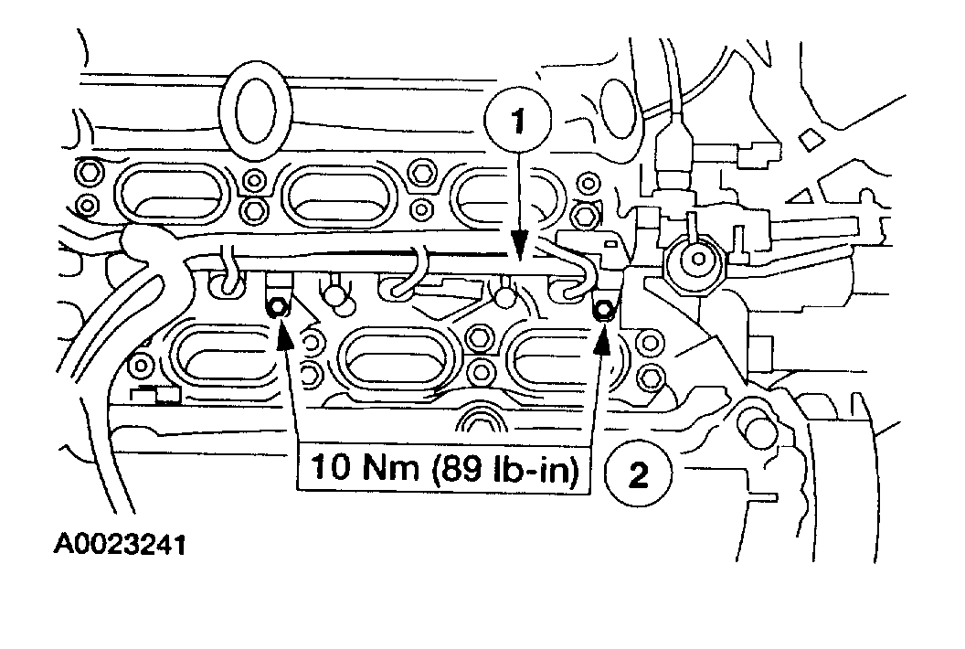

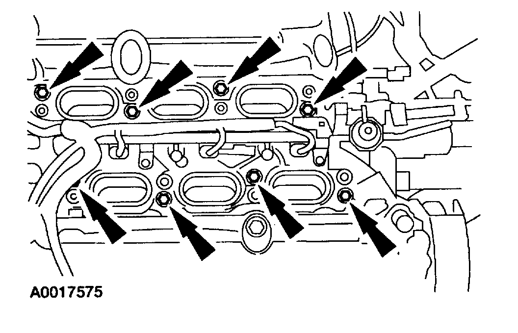

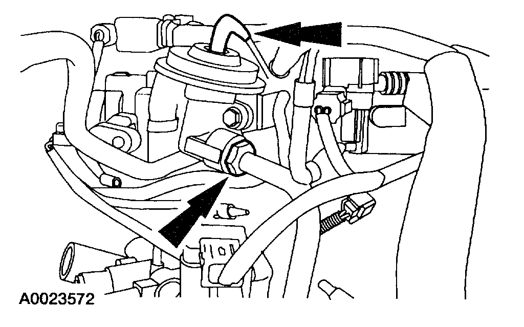

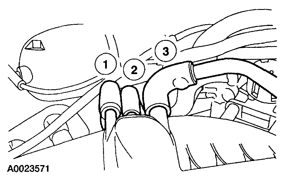

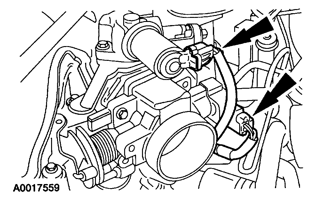

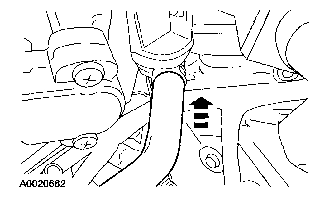

What I would suggest is to remove the intake. If the bolt is stripped, an air leak can be causing the misfire. By chance, is the bolt that is loose near cylinder 3?

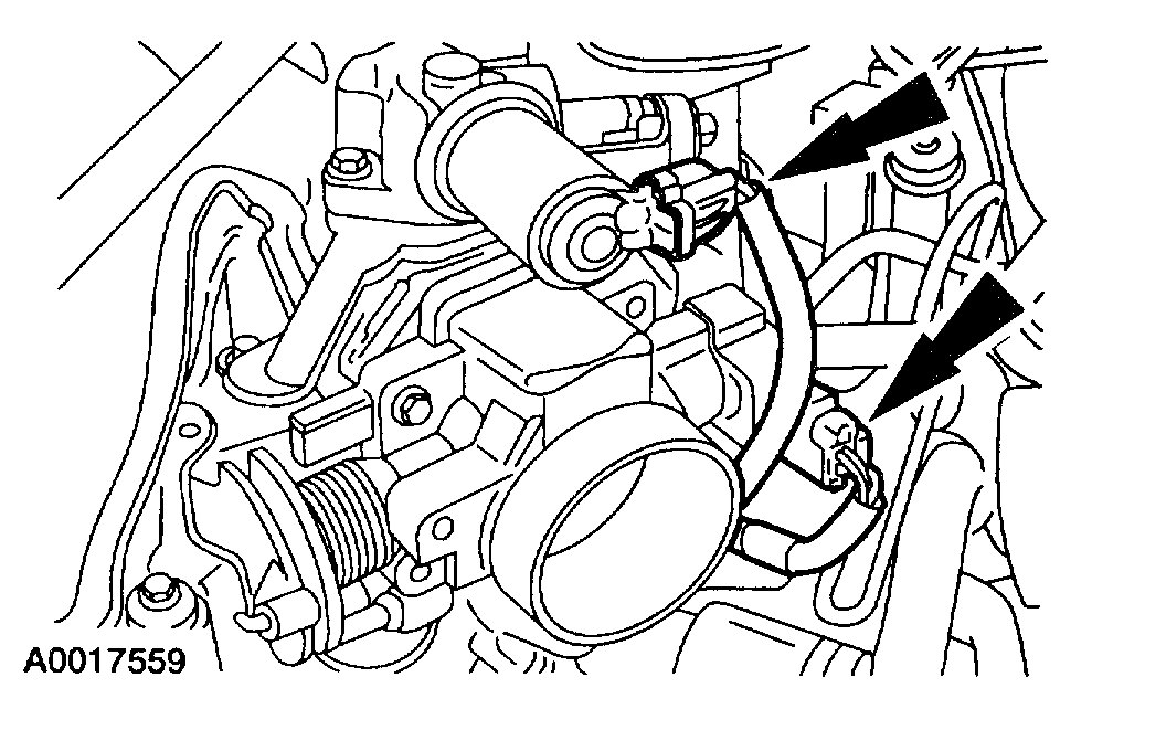

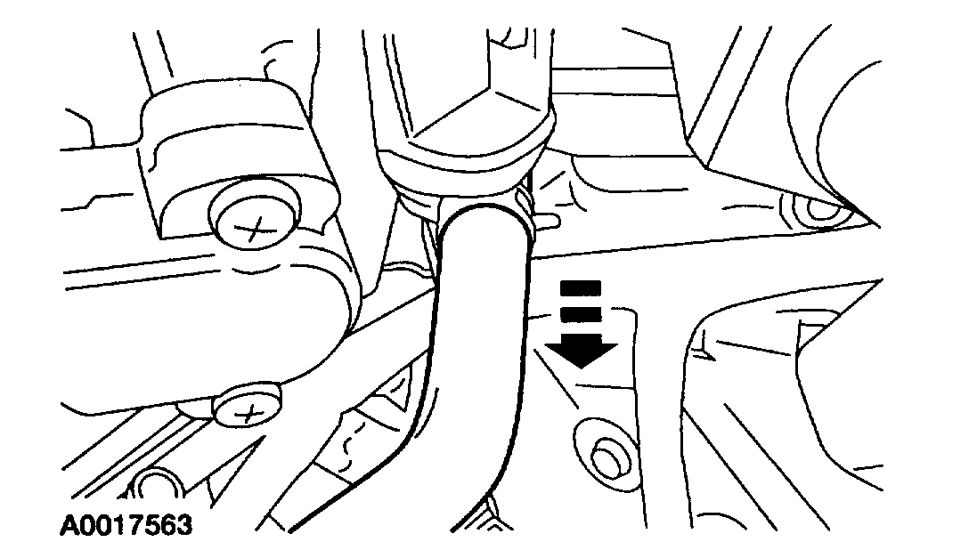

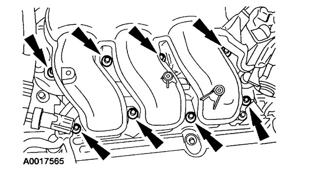

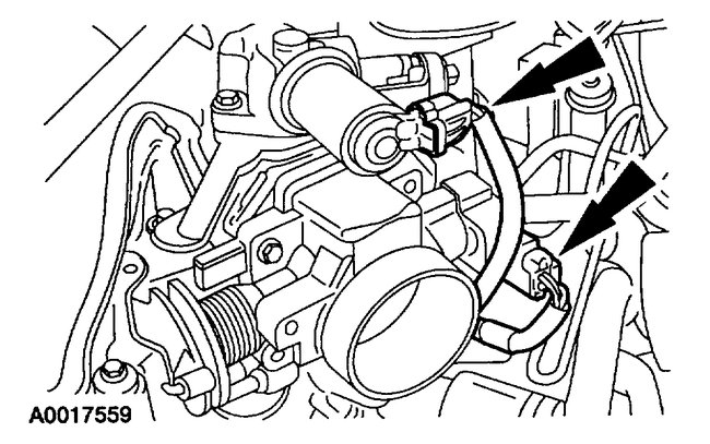

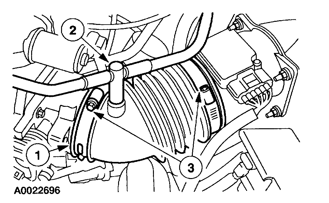

Here are the directions for the upper intake. The attached pics correlate with the directions.
2001 Mazda Truck Tribute LX 4WD V6-3.0L DOHC
Upper Intake Manifold
Vehicle Engine, Cooling and Exhaust Engine Intake Manifold Service and Repair Procedures Upper Intake Manifold
UPPER INTAKE MANIFOLD
Removal
pic 1

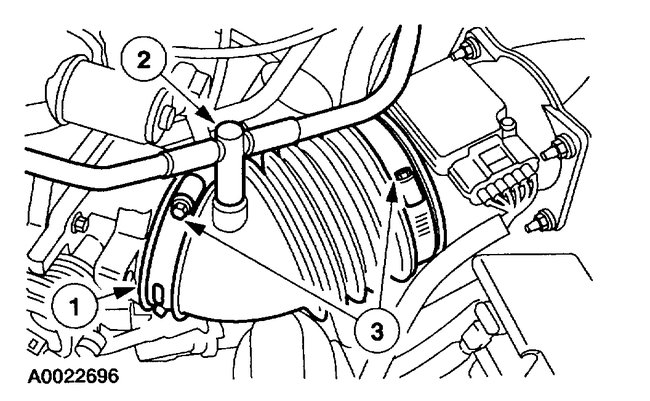

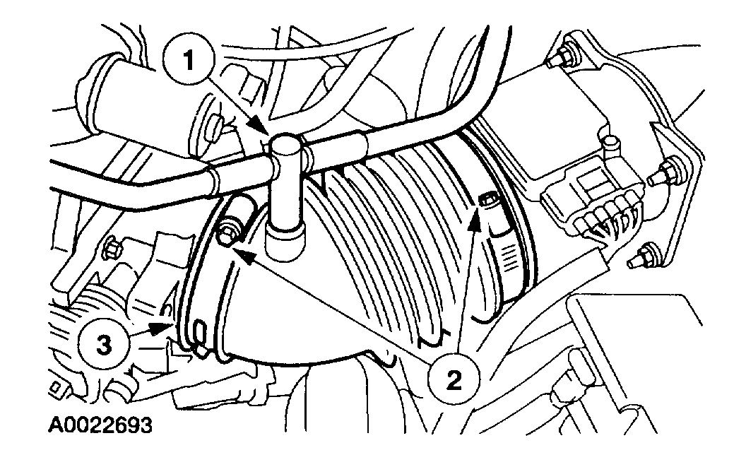

1. Remove the air cleaner outlet tube.
1. Remove the vacuum hose.
2. Loosen the clamps.
3. Remove the air cleaner outlet tube.

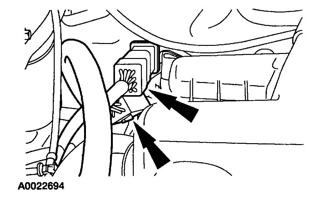

pic 2

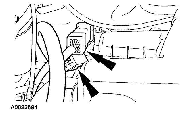

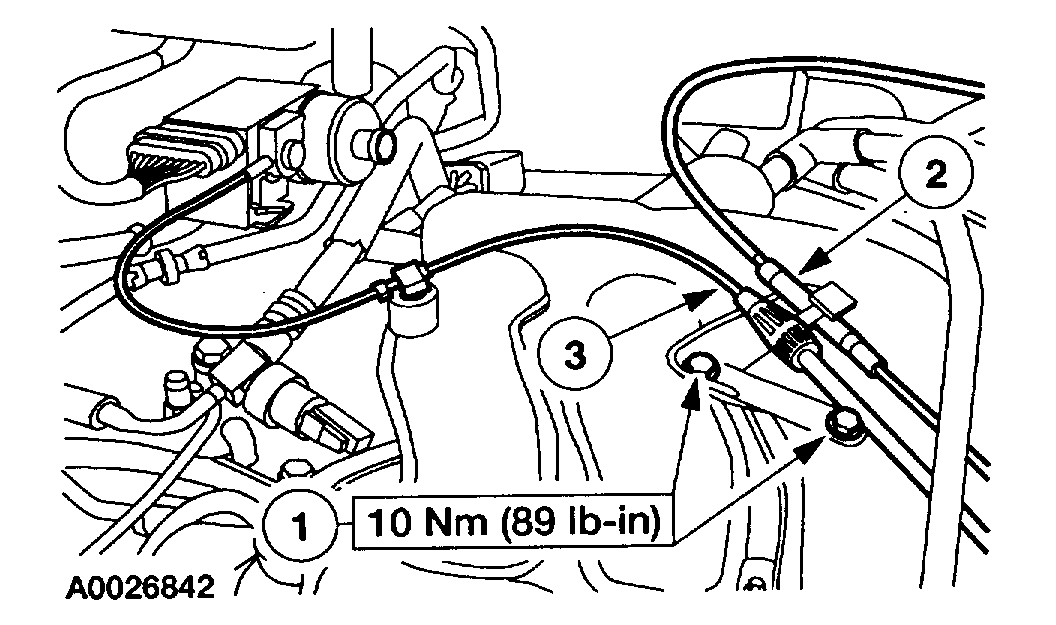

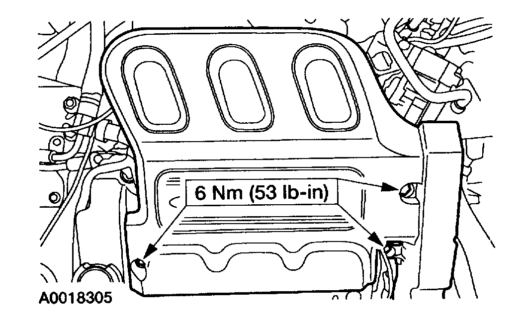

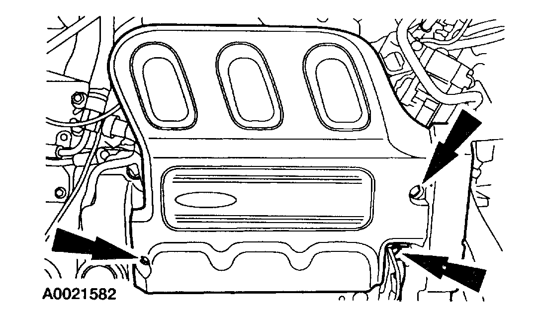

2. Remove the three nuts and the engine appearance cover.

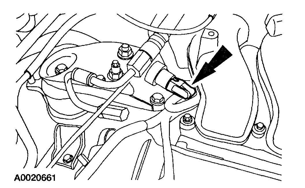

pic 3

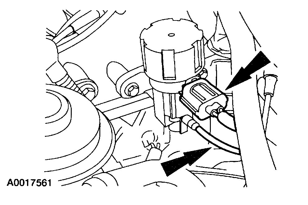

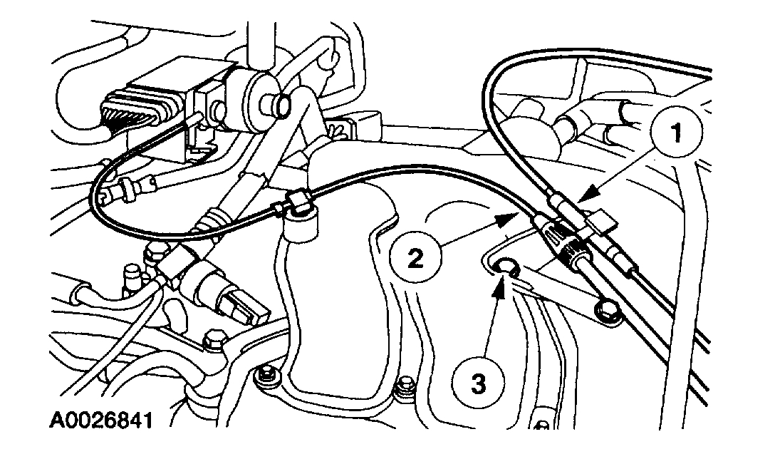

3. Disconnect the cables.
1. Disconnect the throttle cable.
2. If equipped, disconnect the cruise control cable.
3. Remove the throttle cable bracket bolts.

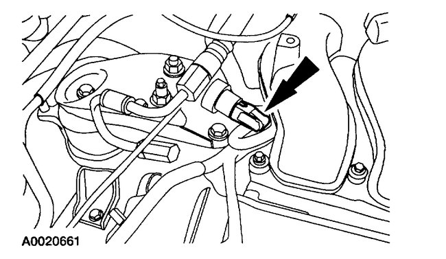

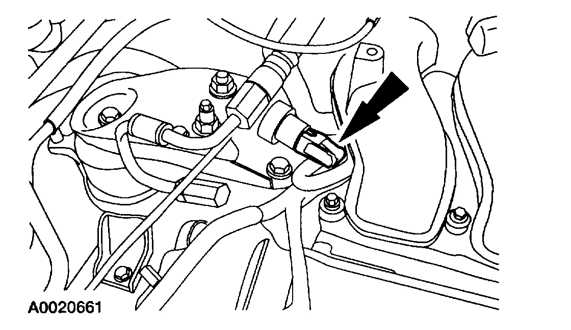

pic 4

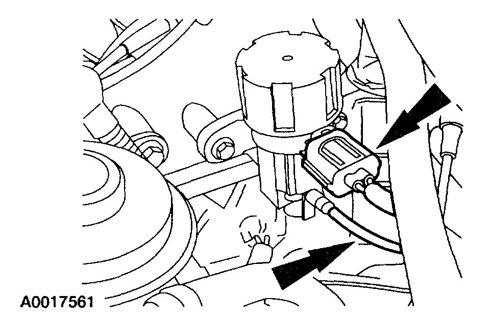

4. Disconnect the throttle position (TP) sensor and idle air control (IAC) electrical connectors.

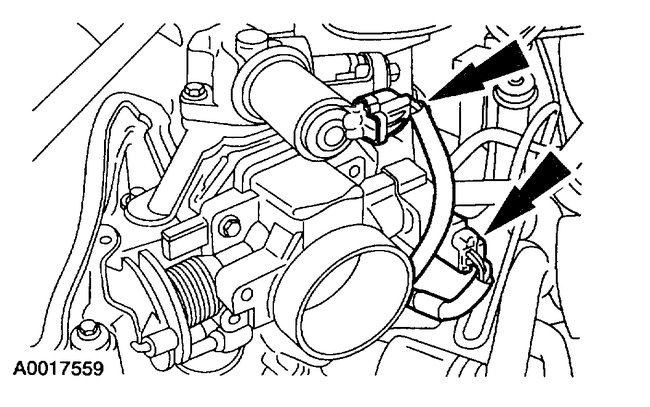

5. Disconnect the exhaust gas recirculation (EGR) valve vacuum hose and EGR tube nut.

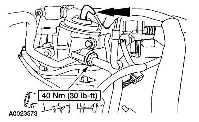

6. Disconnect the EGR vacuum regulator valve electrical connector and vacuum hose.

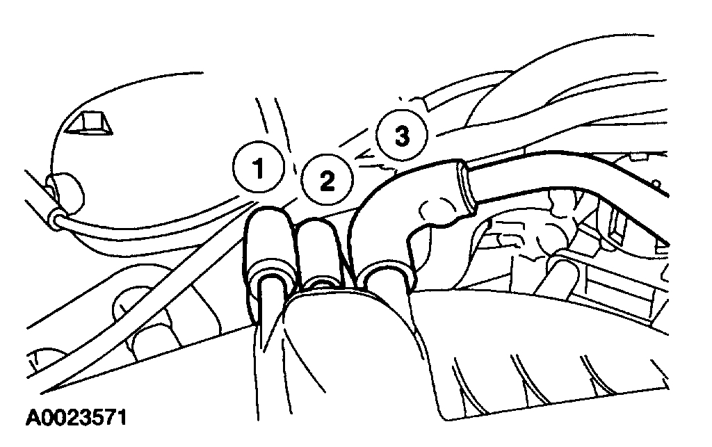

7. Disconnect the three vacuum hoses on the back of the intake manifold.
1. Connect the chassis vacuum hose.
2. Connect the engine vacuum hose.
3. Connect the positive crankcase ventilation (PCV) hose.

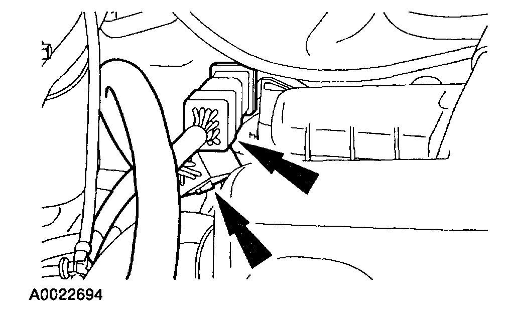

9. Disconnect the two electrical connectors attached to the left side of the upper intake manifold.
pic 10

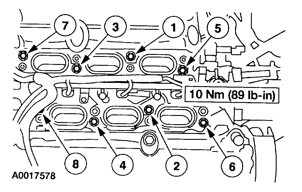

pic 11

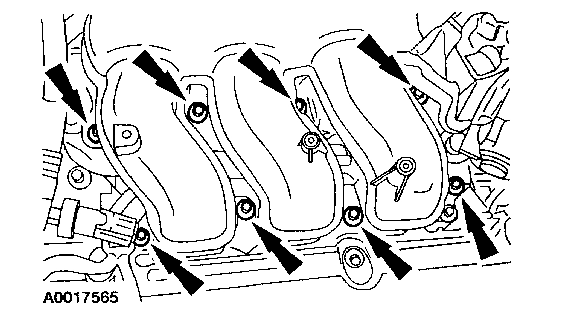

11. Remove the eight bolts and the upper intake manifold.
1. Remove and inspect the gaskets. Discard if damaged.
2. Clean all sealing surfaces.
Installation
1. Position the gaskets in the upper intake manifold.
pic 12

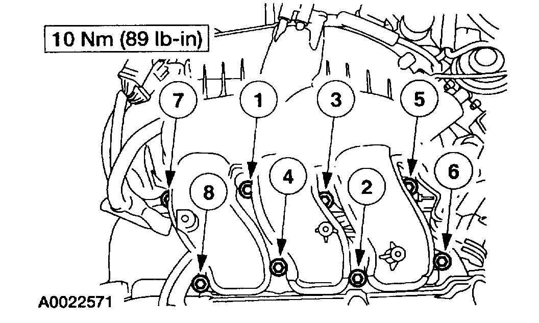

2. Position the upper intake manifold and tighten the bolts in the sequence shown.
pic 13

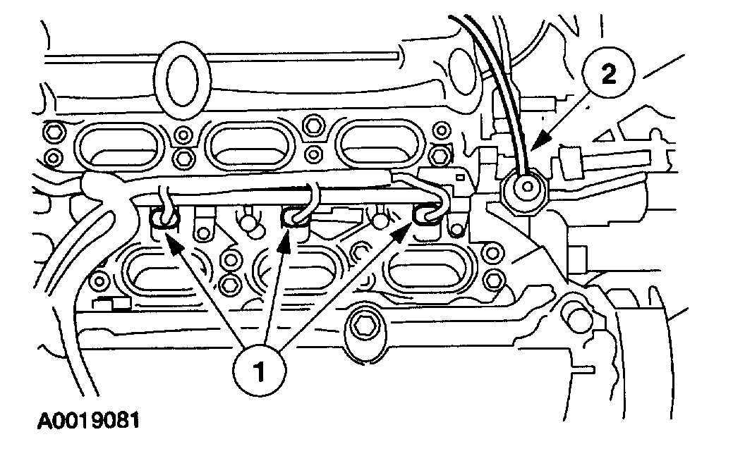

1. Disconnect the fuel line spring lock coupling.
Pic 23
2. Remove the upper intake manifold.
pic 24

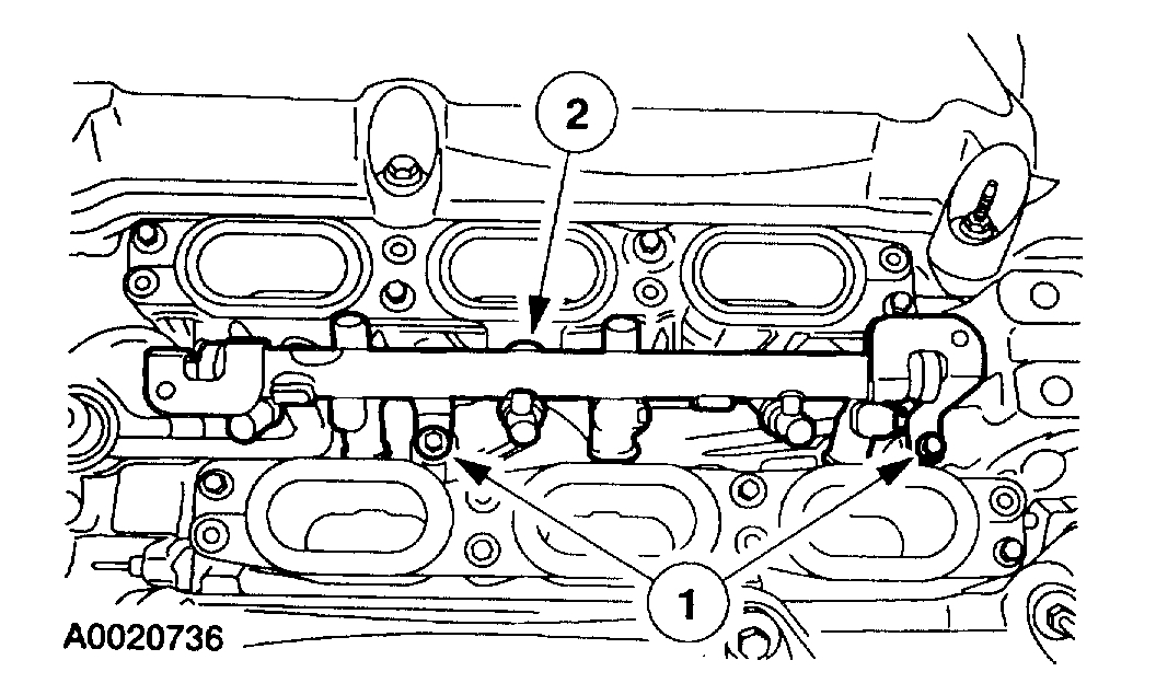

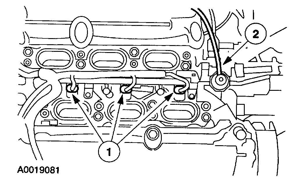

3. Disconnect the fuel rail.
1. Disconnect the six fuel injector electrical connectors (1).
2. Disconnect the fuel pressure damper vacuum line (2).
4. Remove the bolts and the lower intake manifold.
pic 25
5. Remove the fuel rail.
1. Remove the bolts (1).
2. Carefully separate the lower intake manifold from the fuel rail (2).
6. Remove the six fuel injectors from the lower intake manifold.
7. Remove and discard the gaskets if damaged.

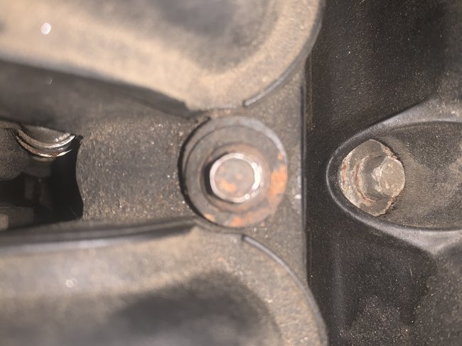

Here is the bolt on the front of engine:
Sep 14, 2020 at 12:41 PM
  • 110,244 POSTS
Is that the one that can't be tightened? If so, are you able to remove it? It looks like there is room.
Sep 14, 2020 at 12:53 PM
FARR2007
  • 244 POSTS
No those bolts are not made to come out.
Sep 15, 2020 at 9:28 AM
  • 110,244 POSTS
We have two choices here. First, replace or repair the ignition coil for cylinder 3 to see if that eliminates the problem. If it doesn't, check the intake for vacuum leaks. I suspect there could be one simply because the bolt can't be tightened.
If it was me, I would tighten the loose coil and see if that chances it.
