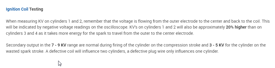

It could be the coil. You have what is called a coil pack so you may want to test it first. I attached that process. However, if you want to just replace it to be sure, then I would understand that because they don't appear to be too expensive.
