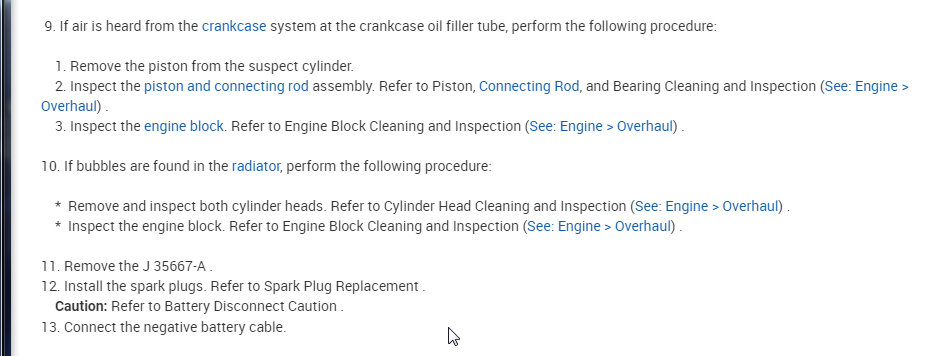

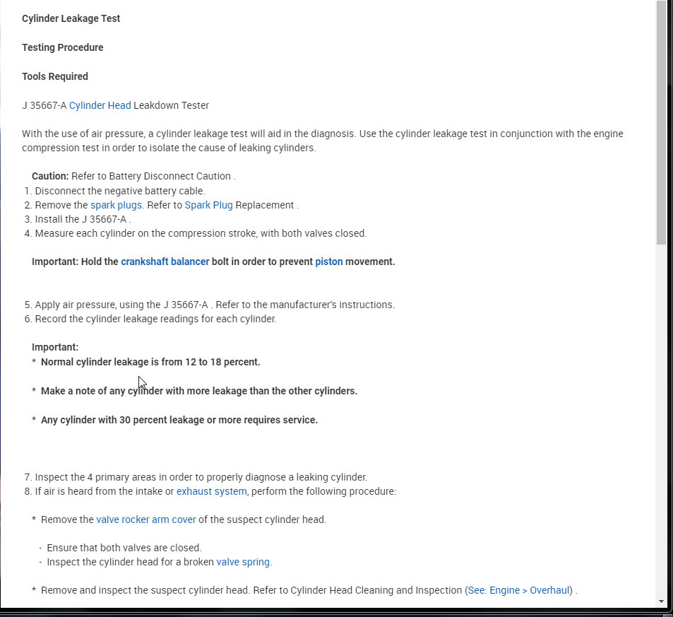

We need to check to see if we have a valve sticking. The exhaust valve check you can use a dollar bill over the tail pipe and see if it is pulling the dollar into the pipe. It won't be much but it should feel consistent pressure outwards.
Then put a vacuum gauge on the intake to see if the intake valve is sticking. The needle should be steady and not shaking.
Depending on that we can run a compression check and cylinder leakage but that is if the valves are not sticking.

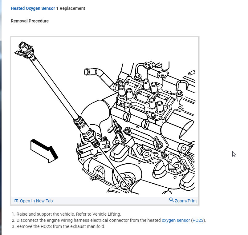

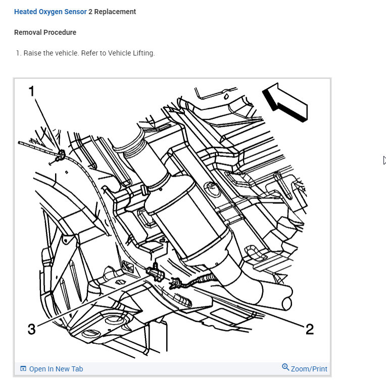

I unplugged injector and o2 voltage dropped down to around 40 on both o2’s . I tried to switch o2’s the tool broke trying to loosen upper o2. I will try again later.
Dec 31, 2019 at 10:55 PM

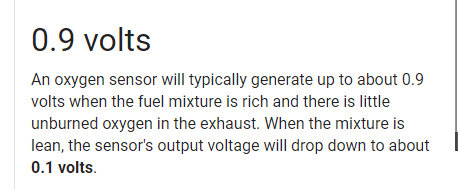

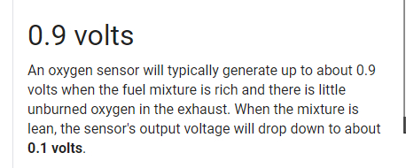

So when you say it dropped to 40 what was the reading measured in? Was it volts or a percentage?
Typically the sensor voltage is from .1 volts (lean) to .9 volts (rich). I expected to see just that side go lean so it is odd that both sides would move equally.
You may need to let the sensor soak in penetrating oil overnight so it can loosen up.
