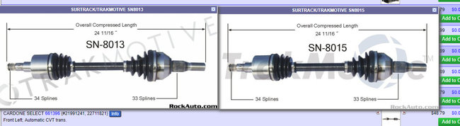

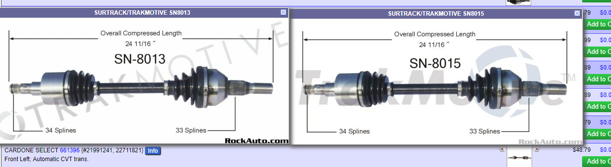

What issue led you to find out they are the wrong axles? There are many cars that the same axles are used for automatic and manual transmissions?
I attached the one for automatic and the one for manual. They are the same length and the same splines. The only difference is the thickness if the shaft. The manual is thicker than the automatic.
There should be no issue at all.

Not at all. From all the specs, you are good to go.

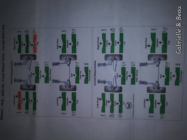

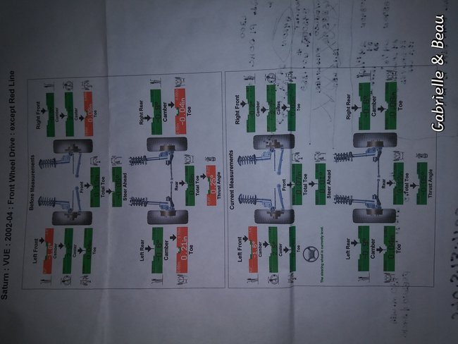

The first image is one before and immediately after replacement of axles.
The second image is the next day after driving home and back. That is when the swapped front left and right tires.

My concern is the camber being out of adjustment in the first image after the alignment. Nothing should be in the red.
Did they check the joints and the axle?

Okay. Going back to the alignments. The first image after repair and next day after repair before another alignment.
Although camber still red
Did you notice difference in caster being red after I drove short distance?
Thursday, November 29th, 2018 AT 10:24 AM
  • 52,797 POSTS
Yep, that will cause pulling on the front end.
They are not adjustable. When those readings are off, something is bent or worn out in the suspension.
+1
Thursday, November 29th, 2018 AT 11:06 AM
GABBYGILBO
  • 55 POSTS
OMG. So the caster being in red after repair and after driving indicates something in suspension.
