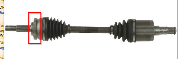

CV axle with ABS installed and car driven for about a month before correct CV axle installed. What damage could result?

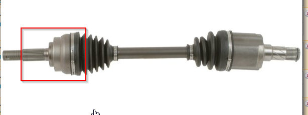

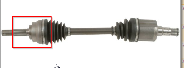

The CV axle that was initially installed was for a 2002 Altima with ABS. The correct CV axle without ABS was installed about a month after using the Altima with the ABS axle. Could this have caused any damage?
Mar 22, 2020 at 2:14 AM
Okay. This will not cause any damage. The only difference is one with ABS has a tone wheel/ring so the speed sensor can pick up the speed on that wheel. The non ABS does not have this ring. You could have left it on there and it would have been fine. In fact, people knock off that ring on some applications when an ABS axle is their only option.
The only way that it matters is if you have ABS and you use a non-ABS axle that does not have the tone ring. Then you will have an ABS code and the system will not work.
Take a look at the pictures. Clearly you have things they way they are supposed to be now so you are good to go.
