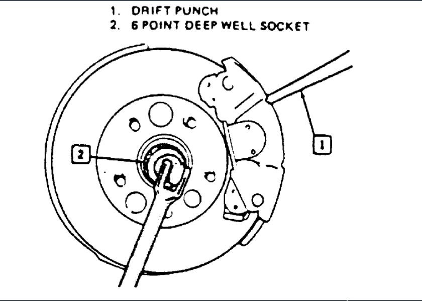

Am I going to be able to replace the driver side axle without taking the strut bolts out?
Mar 6, 2021 at 5:29 AM
Good afternoon,
It is much easier with them removed but you could also remove the or release the lower ball joint to give the hub enough play to get the axle out.

1. Raise and support vehicle, then remove tire and wheel assembly.
2. Install a brass drift or a screwdriver to prevent the rotor from turning, Fig. 7 .
3. Remove axle nut and washer.

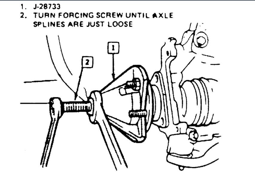

4. Remove stabilizer shaft or link from control arm.
5. Remove nut from ball joint, then separate ball joint from steering knuckle using separator tool No. J-36226, or equivalent.
6. Remove drive axle from hub and bearing assembly using front hub spindle remover tool No. J-28733-A, or equivalent, Fig. 8 .

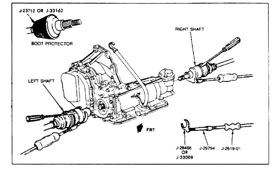

7. Remove drive axle from transaxle using axle shaft remover puller tool Nos. J-33008, J-29794 and slide hammer tool No. J-2619-01, or equivalents, if necessary, Fig. 9 .

1. Install drive axle into the transaxle using seal protector J-37292-B, or equivalent
2. Seat snap ring by placing a screwdriver into the groove on the joint housing and tapping until seated, Fig. 9 .
3. Grasp the inner housing and pull outward. If the snap ring is properly seated, the axle will remain in place.

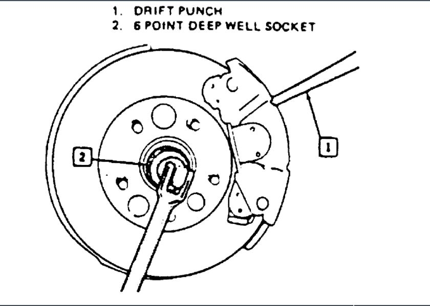

7. Insert a screwdriver or drift into caliper and rotor to prevent rotor from turning, Fig. 7 .
8. Install new hub nut and washer, tighten to specification.
