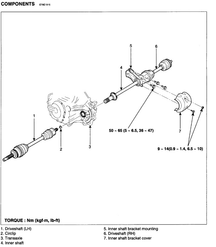

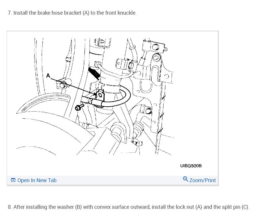

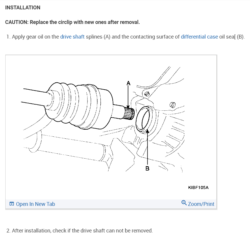

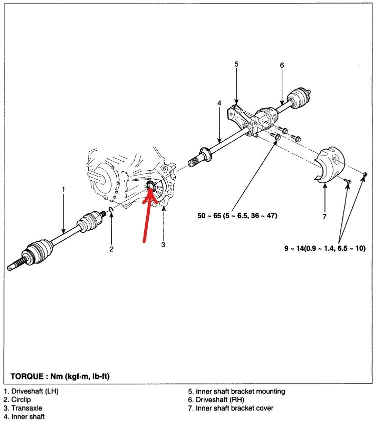

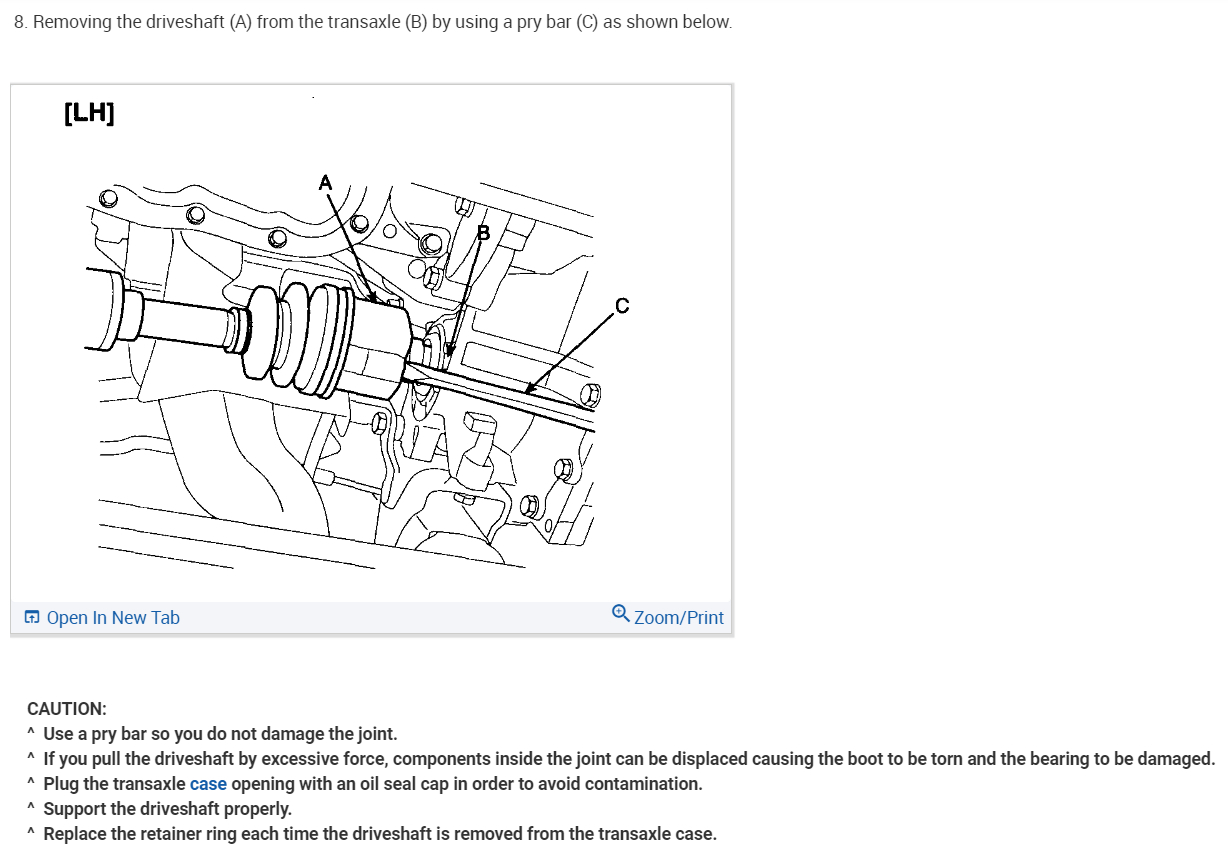

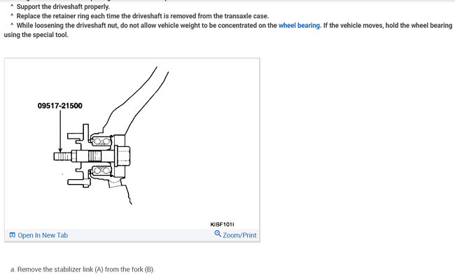

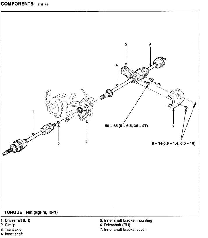

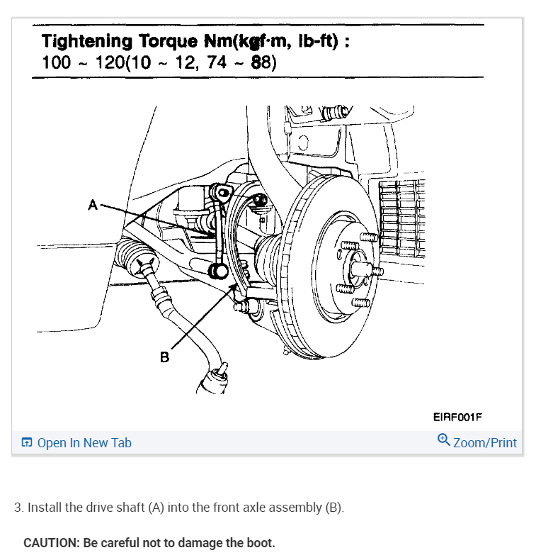

I just had two new CV axles installed but driver side is leaking fluid at transaxle, does this mean CV spine isn't all way in transaxle to cause it to leak?
Oct 5, 2023 at 3:27 AM
  • 55,423 POSTS

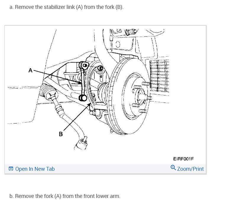

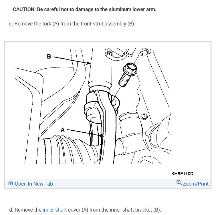

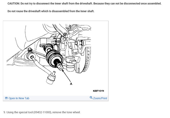

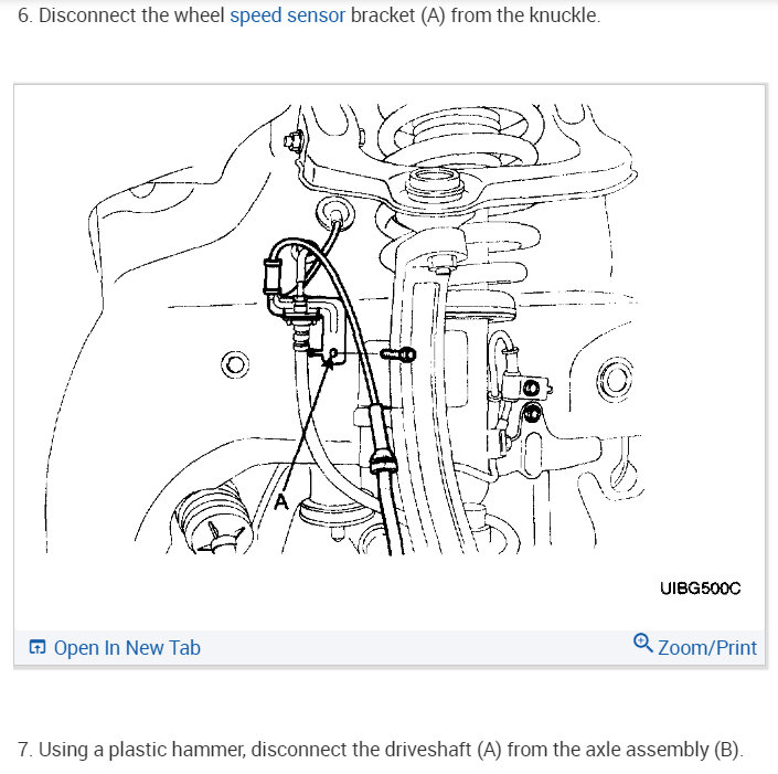

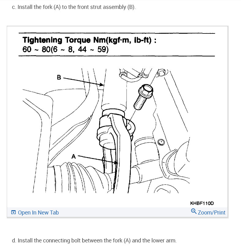

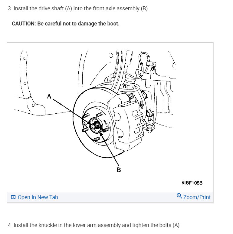

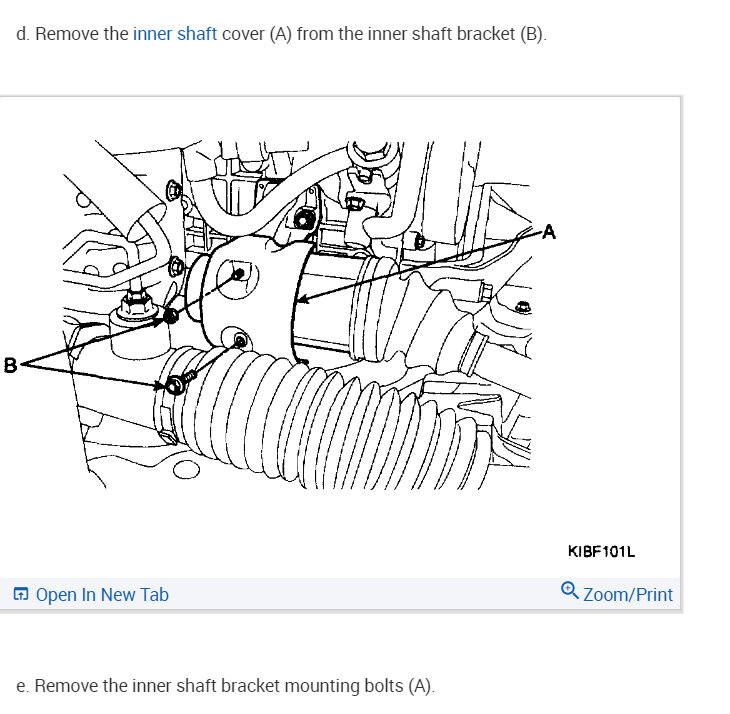

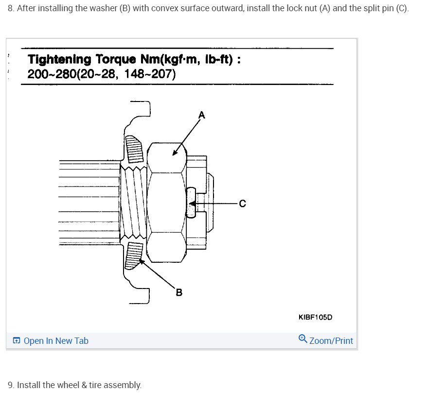

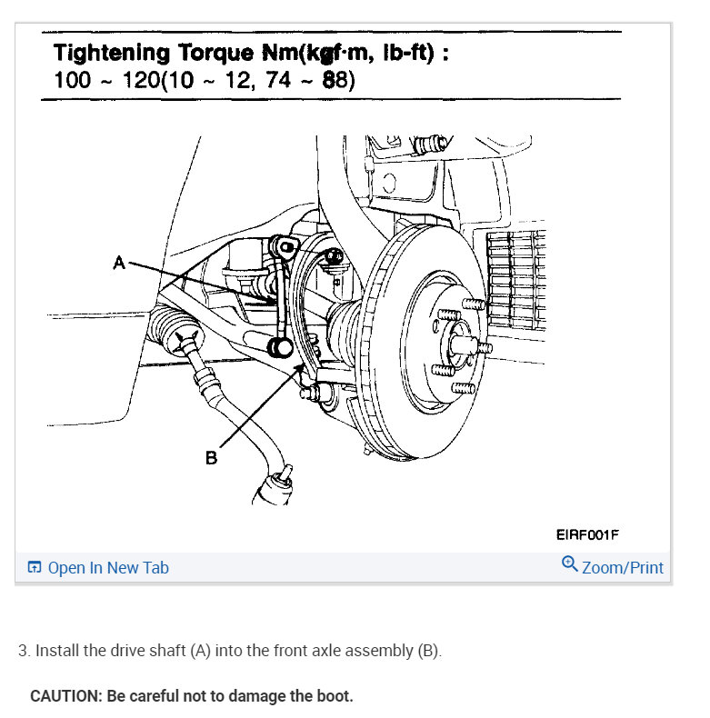

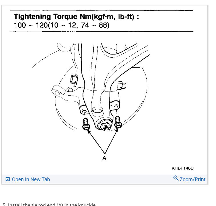

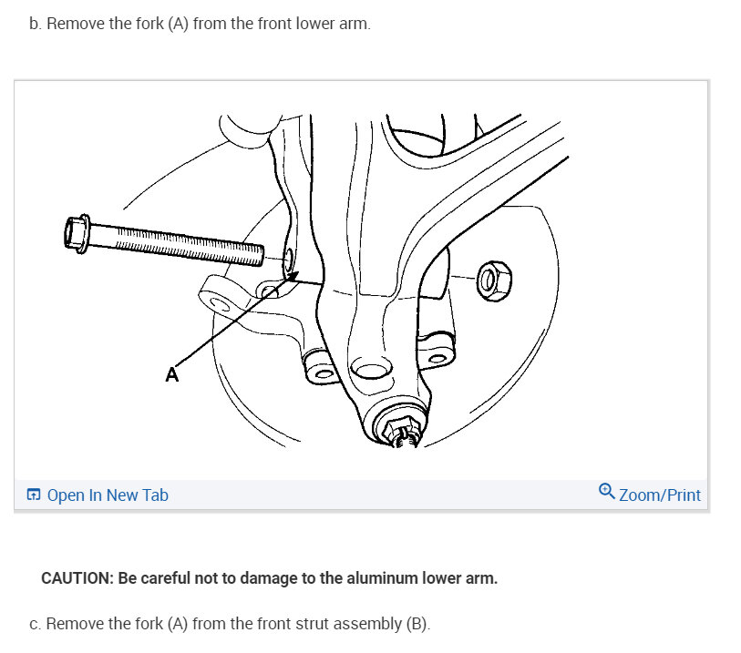

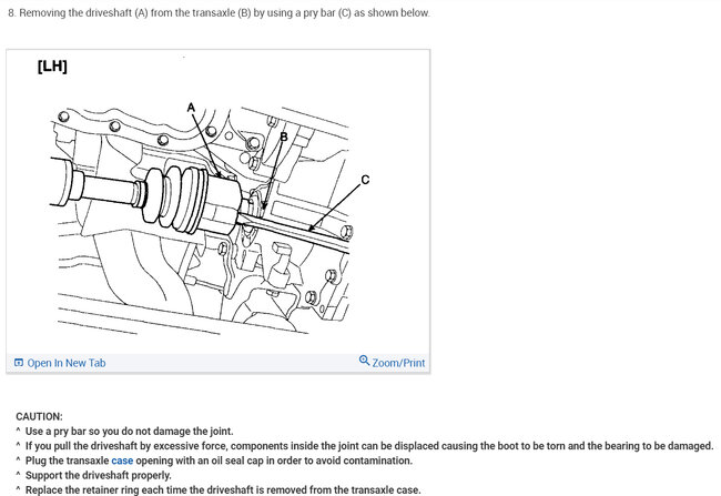

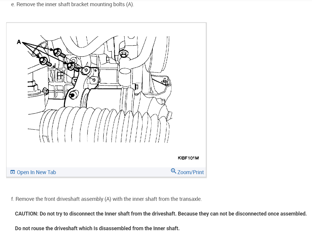

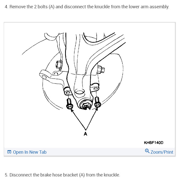

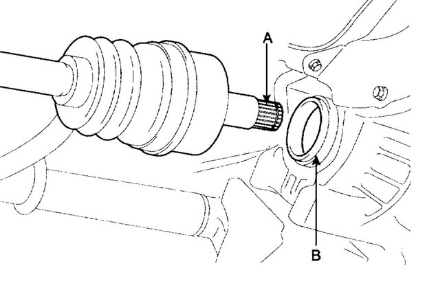

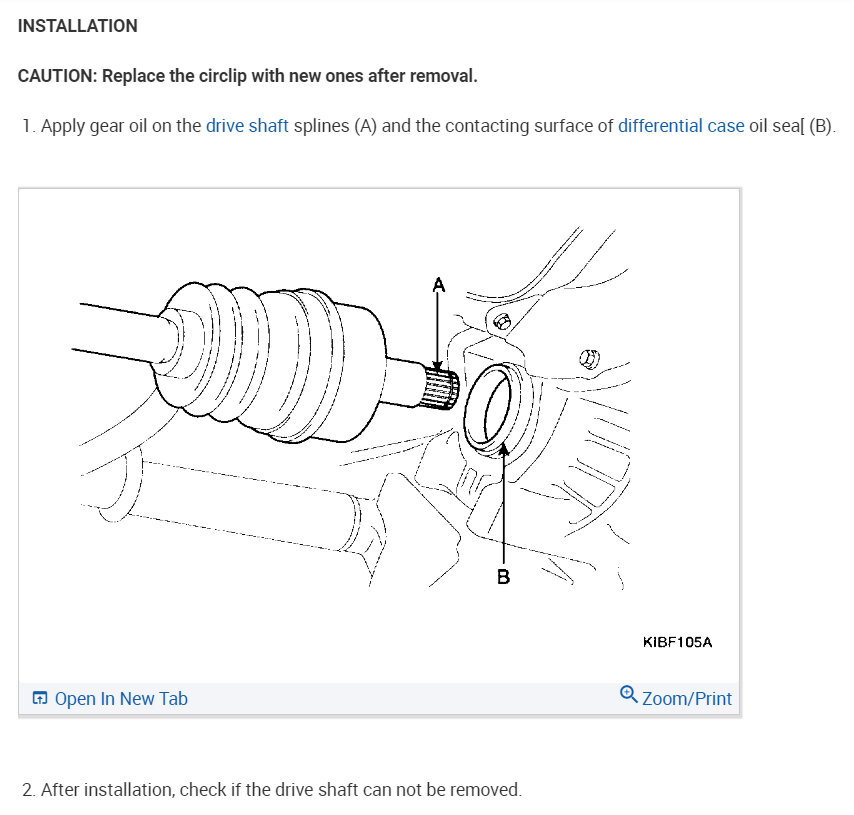

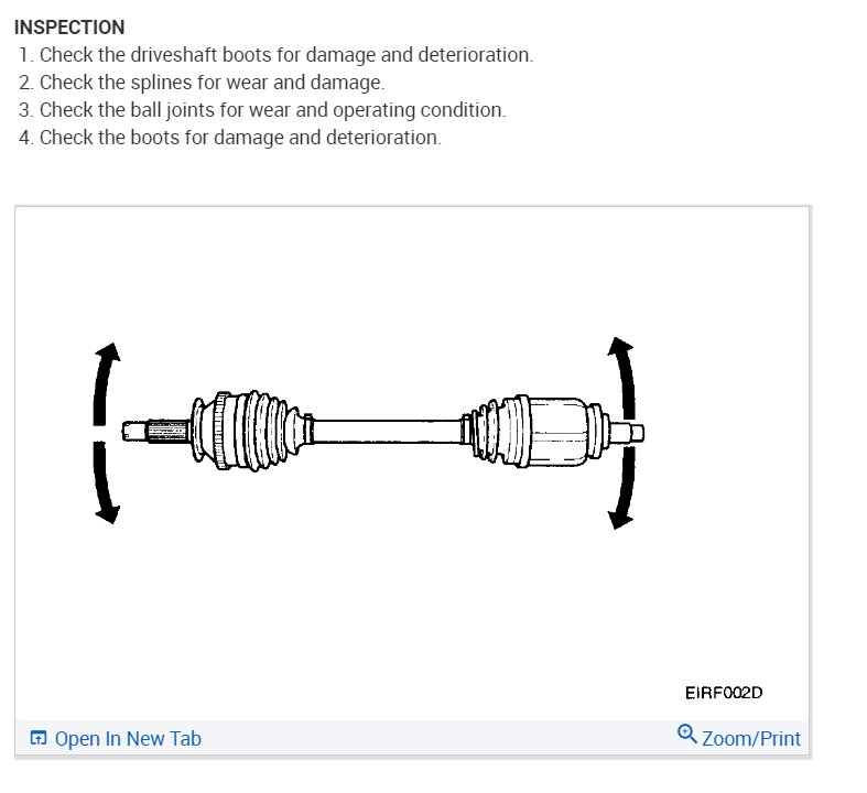

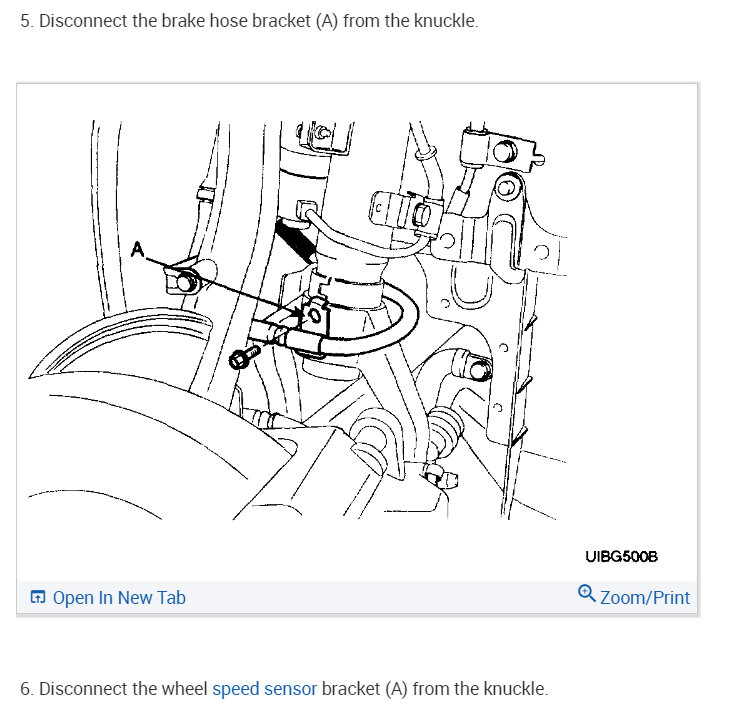

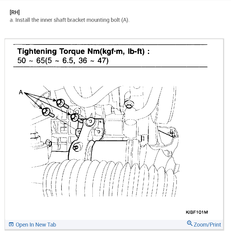

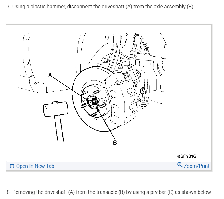

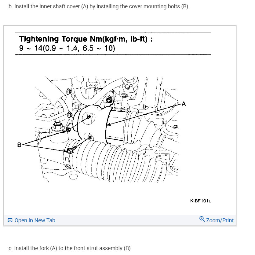

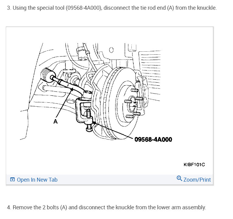

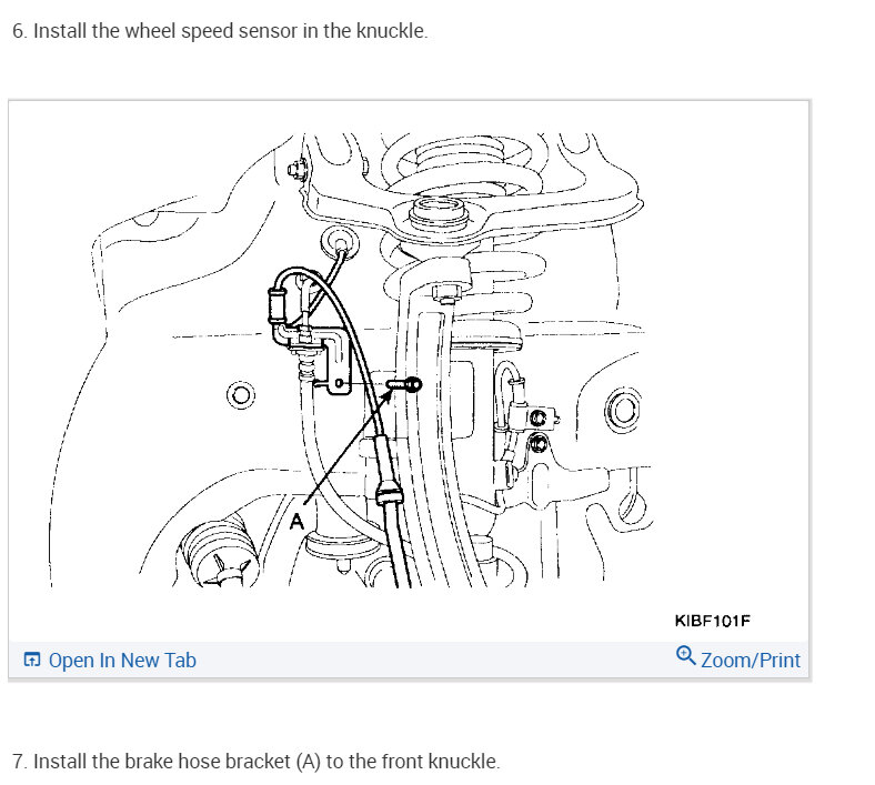

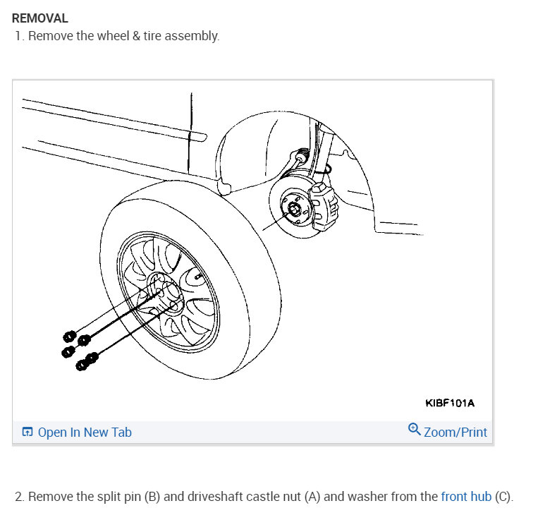

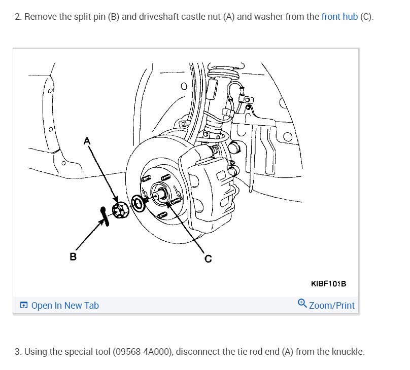

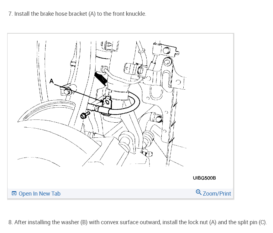

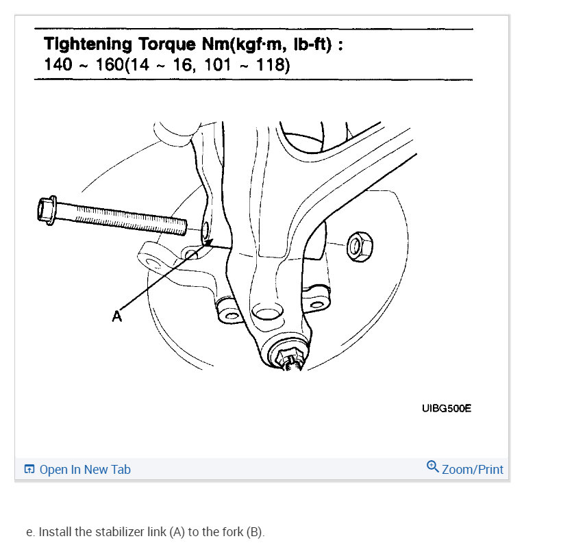

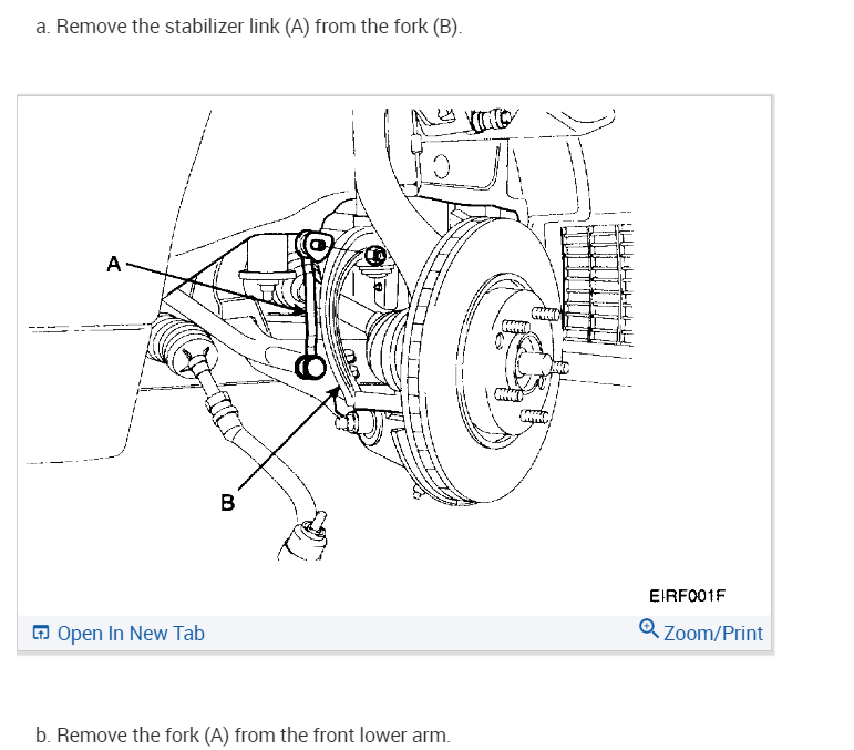

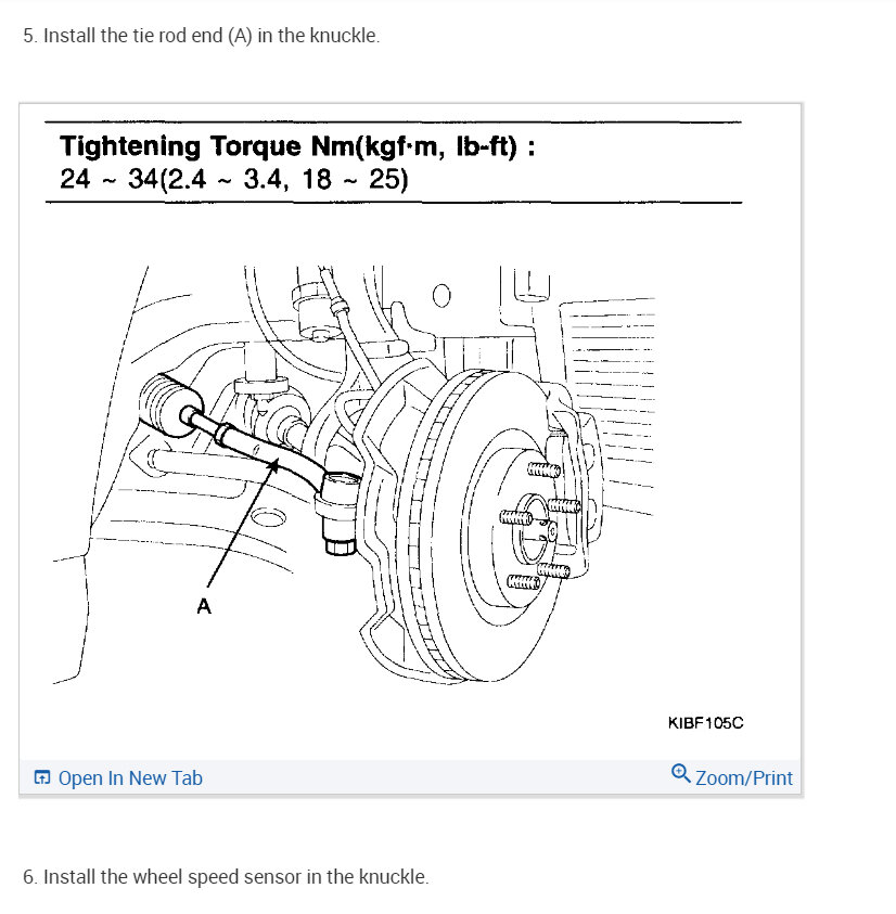

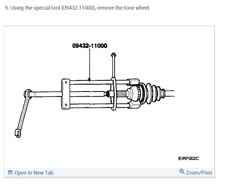

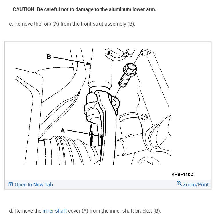

Yep, if the axle is not installed completely, it will leak, and the car will go into neutral as well without warning so keep that in mind. Also, the seal could have been damaged when installing the CV axle. Here is a video that shows how the job is done on a similar car, the process is the same and I have included the instructions for your car in the images below.
https://youtu.be/vOVpWpXsJfk?si=_bnxM7QoVzVUgR1t

The more common reason is that the seal was damaged when the axle was changed. The seal isn't hard to replace, you remove the CV axle, then use a seal puller to remove the old seal. Install the new one (being sure the expander spring stays in place inside it) and re-install the axle.
https://www.2carpros.com/articles/replace-cv-axle
