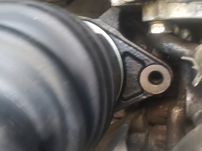

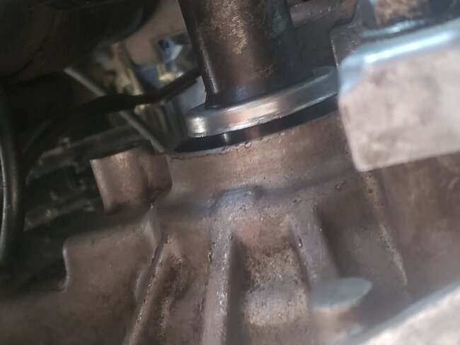

so, I'm replacing my CV axle on the front passenger side and i can't get it all the way inside the transmission because where i put the 2 bolts in the triangle shaped part prevents it from going any further is it possible that it's just too short or i was sold the wrong one because regardless of how I've tried i can't get it to go any further due to that triangle.

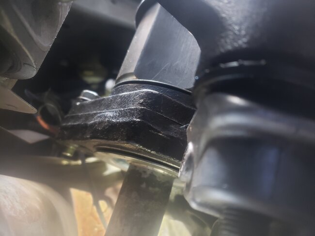

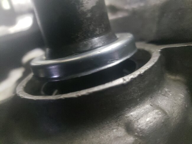

here are some pics of the issue and my vin in case its needed:
Mar 2, 2023 at 9:31 AM
  • 55,104 POSTS
Thanks for the images, can you match up the old axle to the new one to make sure the lengths are correct? Also, the dust shield on the new axle could be in the incorrect place, which can happen during the CV axle manufacturing process. Does it seem like the axle is in the transmission all the way? The second to last image seems like it is installed correctly. I do not see the triangle part you are talking about?

the triangle part I'm talking about is the bracket that takes 2 bolts that's by the wheel area the 1 you bolt the axle into but its not going in any further because this bracket that cant be moved the axle cant go completely inside my transmission it just falls out if i don't bolt it into that bracket I've changed this axle several times due to letting a idiot work on it to begin with but this time i just cant get it to stretch long enough on the other side of this bracket.

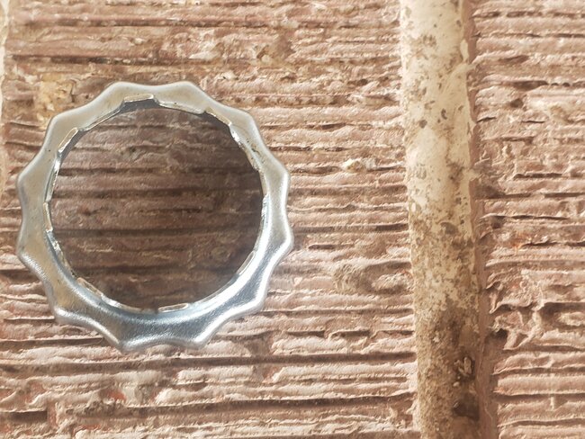

what's the retainer clip look like is it this it came in a bag with the cotter pin?
Mar 4, 2023 at 1:11 PM
  • 55,104 POSTS
That is the outside nut retainer that works with the cotter pin. It must be the wrong axle, or the axle you have is defective.

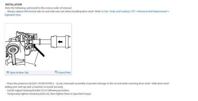

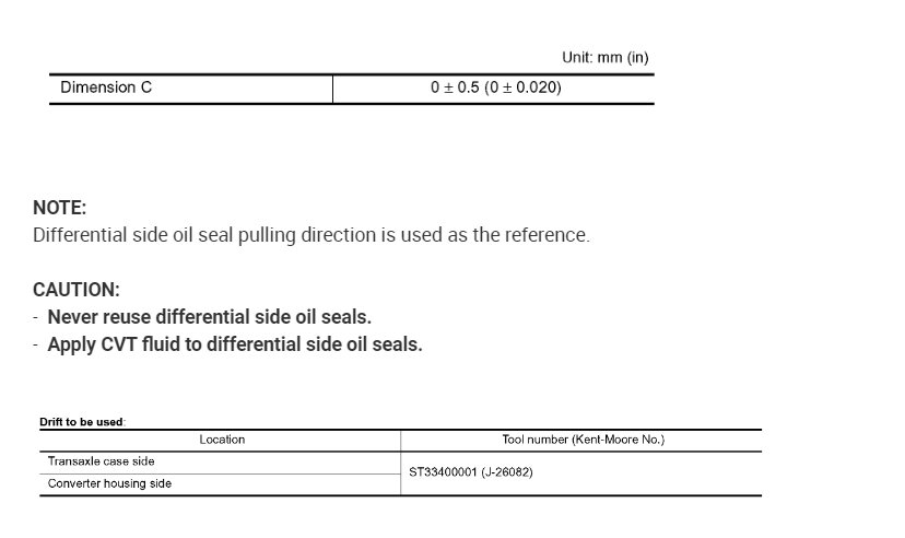

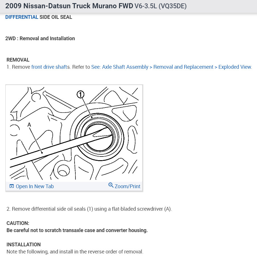

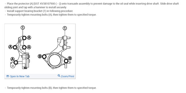

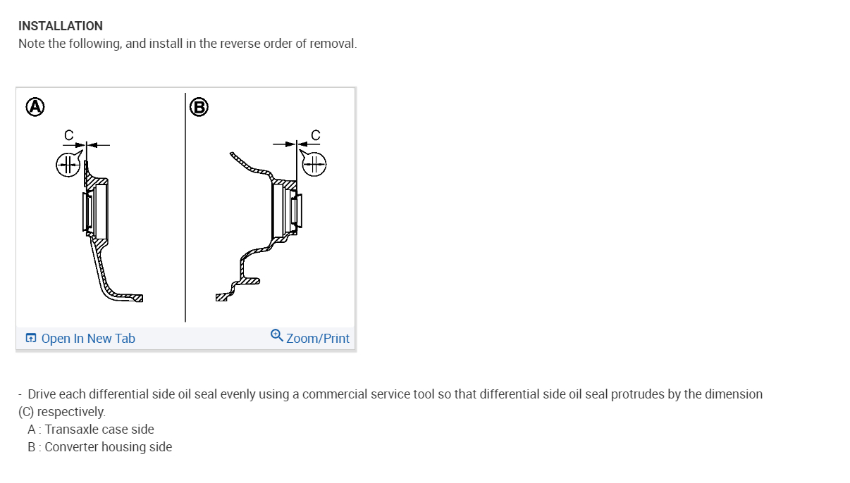

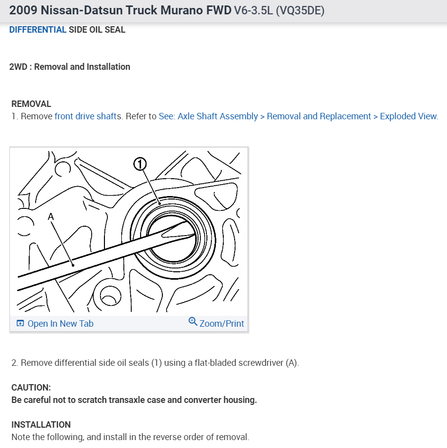

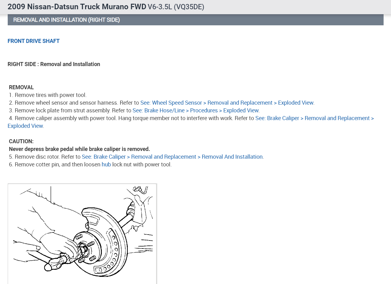

Is there any tool i can use to help get the new seal back in without damaging it for the 10th time and how far does it need to go inside the opening to the CVT all the way or just inside of the opening?
Mar 6, 2023 at 9:14 AM
  • 55,104 POSTS

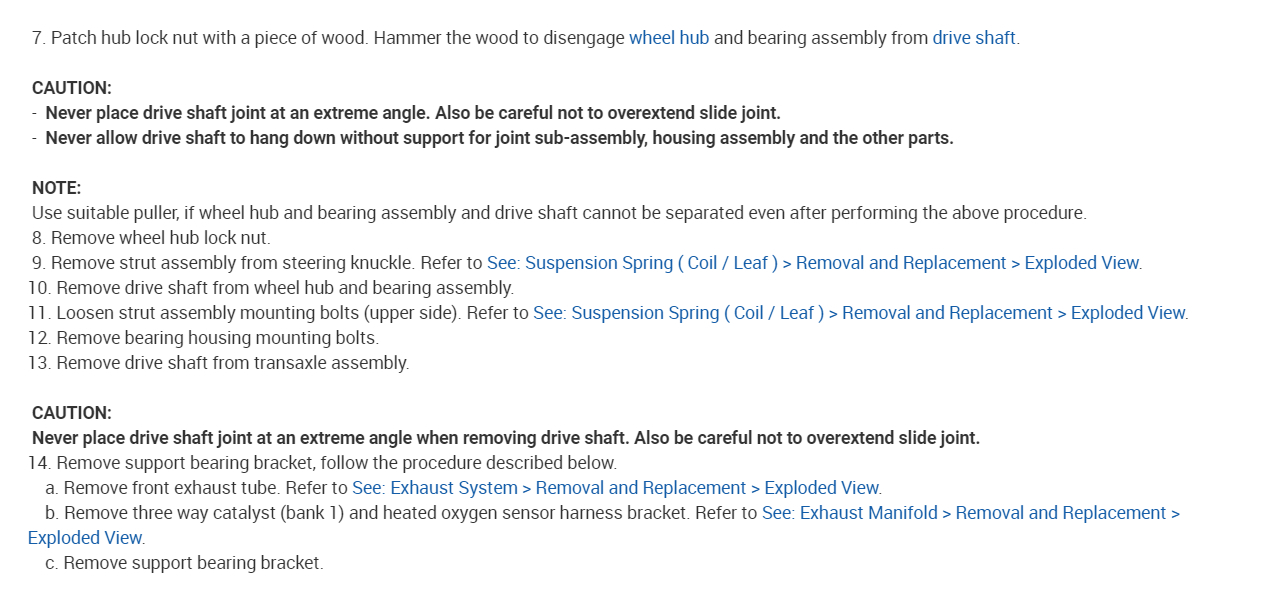

It looks like there is a special protector tool that is used for this job which I have included the instructions over and diagrams in the images below. Please let us know if you need anything else to get the problem fixed.
