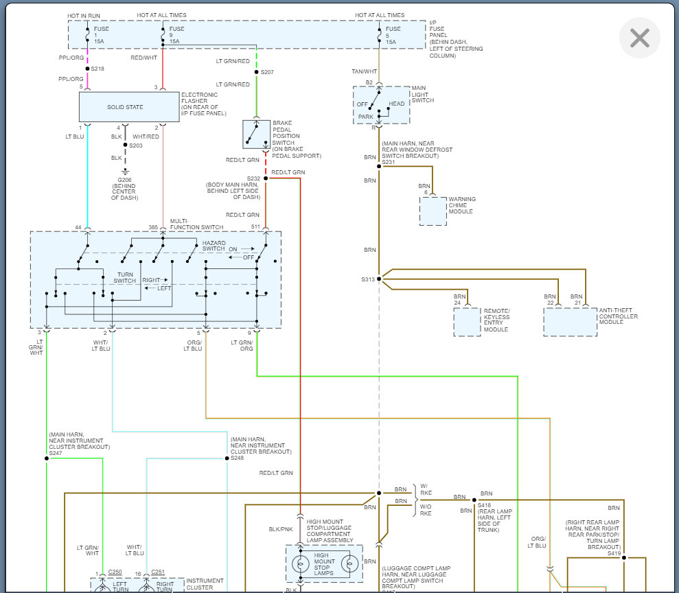

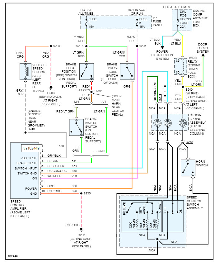

Cruise works if headlight switch is left off. Cruise won't work if lights are on. Cruise quits if it is engaged then lights are turned on.

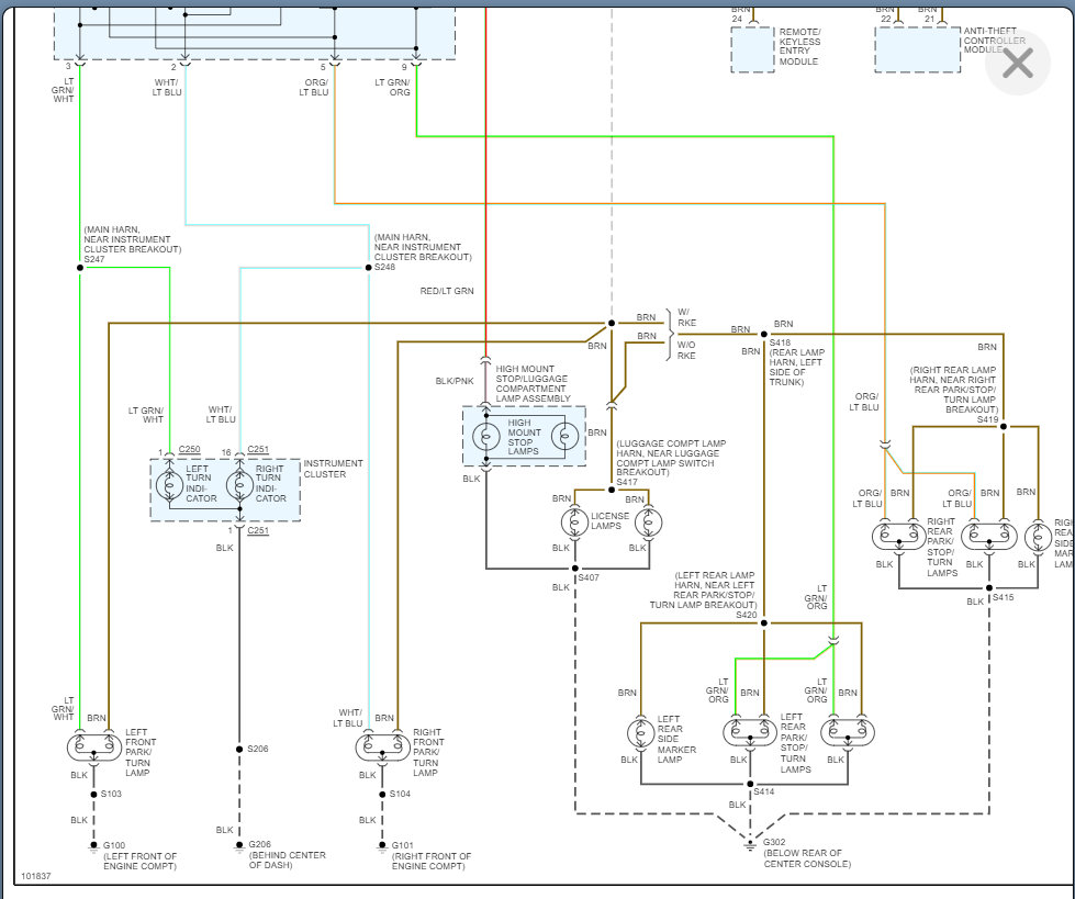

More than likely we have an issue with a taillight bulb or brake light switch.
What I would suggest is we need to go to reach taillight and check voltage on the brake light circuit when the head lights are on. If you have any voltage on the brake light circuit, then this is back feeding, and the vehicle thinks the brake is being depressed.
Here is a guide that will help with this:
The next likely cause of this is the brake light switch itself.
So, if nothing else, I would replace this and then retest the operation.
Please see the wiring diagram below which will help with this.
Let me know if you have questions and we can go from there.
Thanks

I gave up, went around and changed every exterior bulb and the problem cleared up.
I found that Ford designed the ECU to disable the cruise if it detected any perceived defect with any brake or tail bulb and even though they all worked one must have had a high resistance or whatever and now new bulbs have cured the problem.
