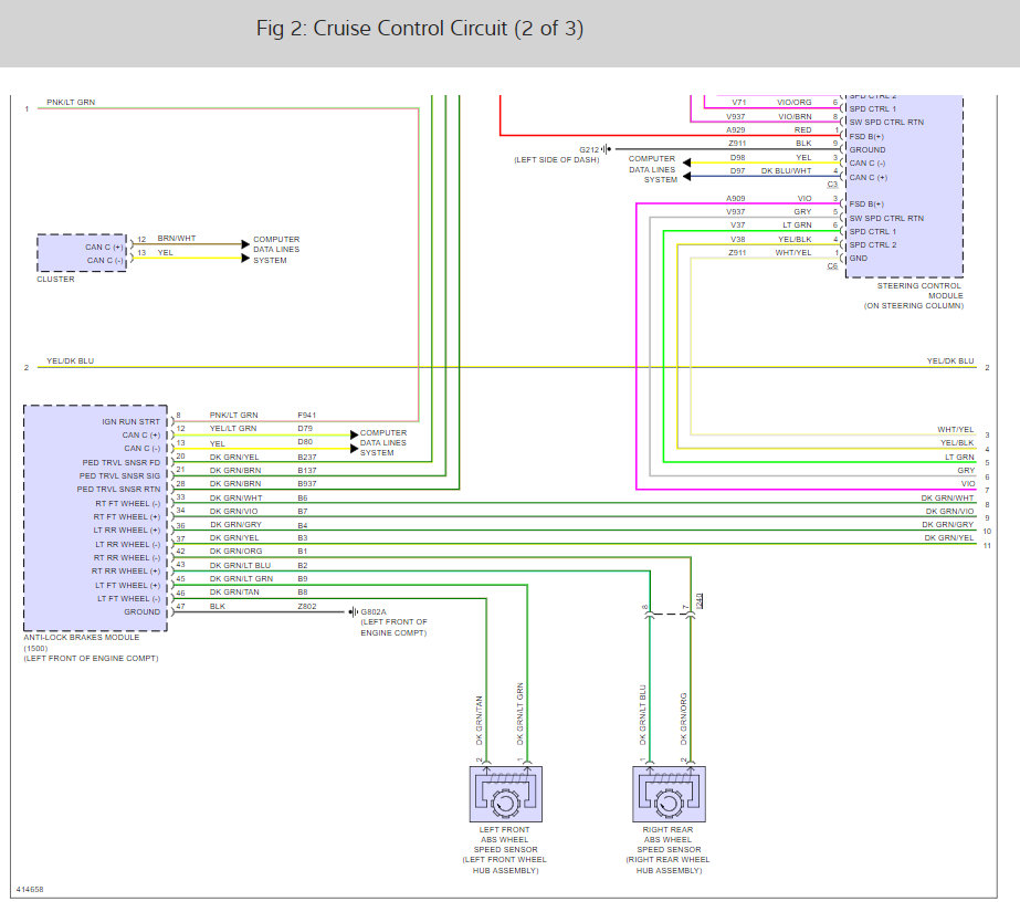

A few months back I was not able to get the switch to work. Checked the fuse and at that time, if I reset the fuse and started the truck it would work until I started driving. Then resetting the fuse would not even get it to work so I replaced the switch. It still does not work after that. So I am looking for any other suggestions. Thanks
(Eight speed)
May 23, 2018 at 4:43 AM
  • 55,399 POSTS

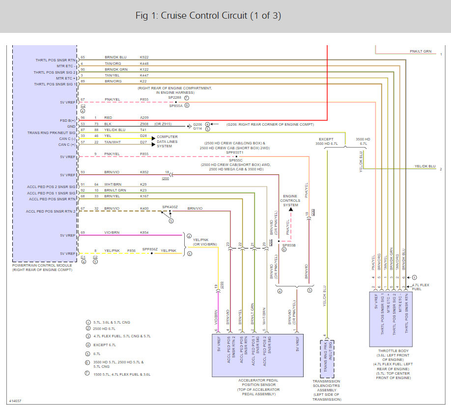

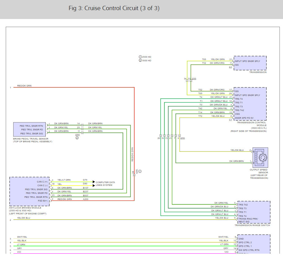

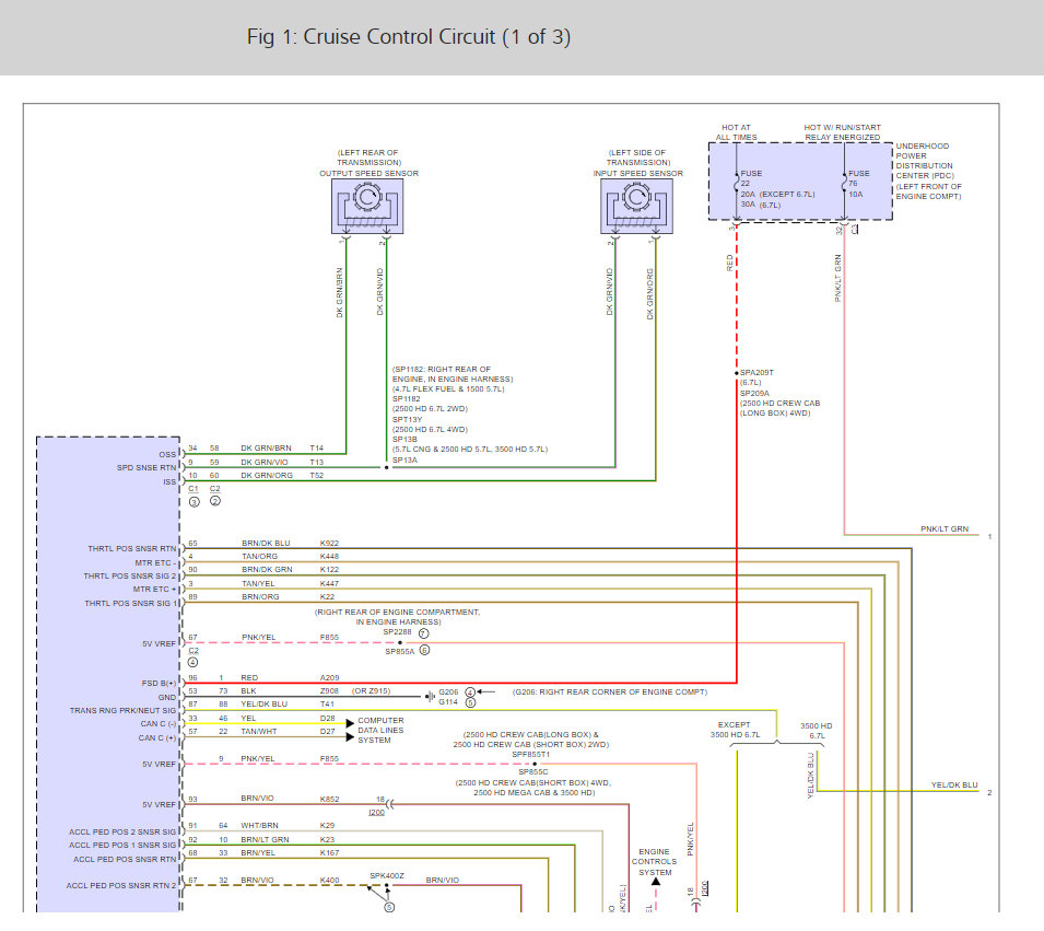

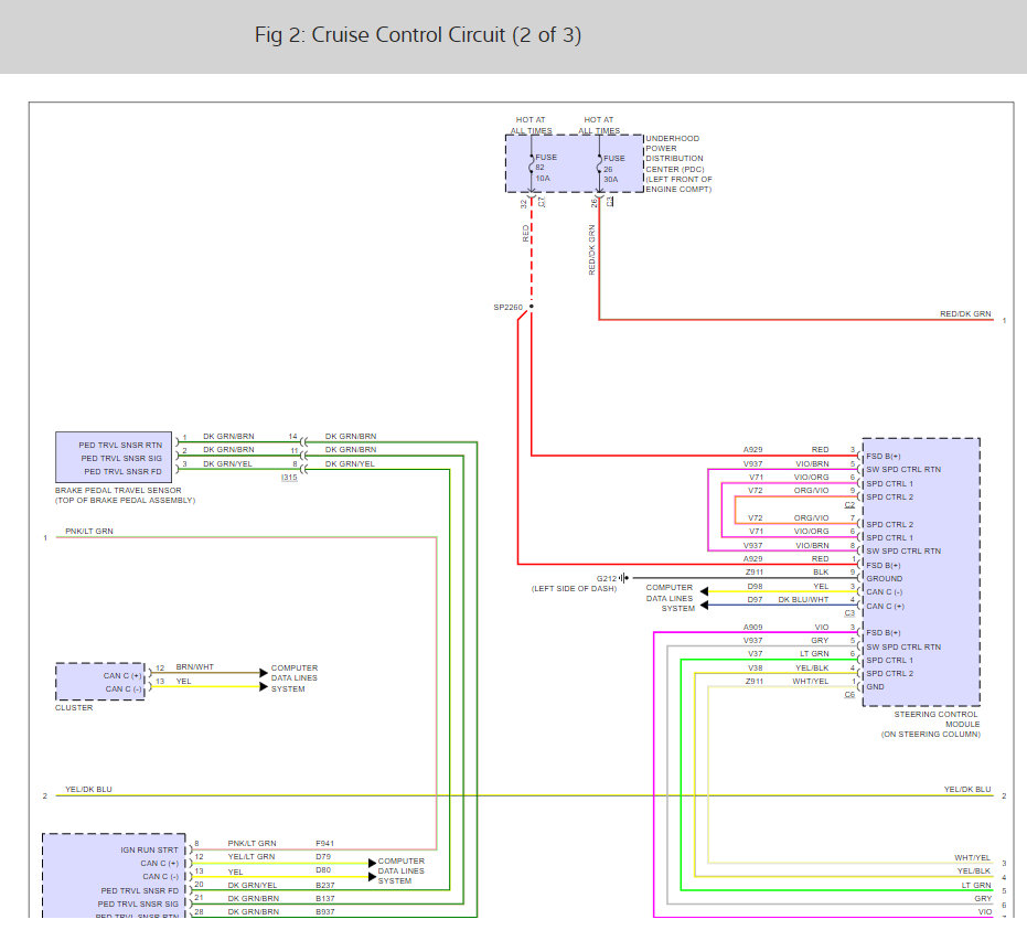

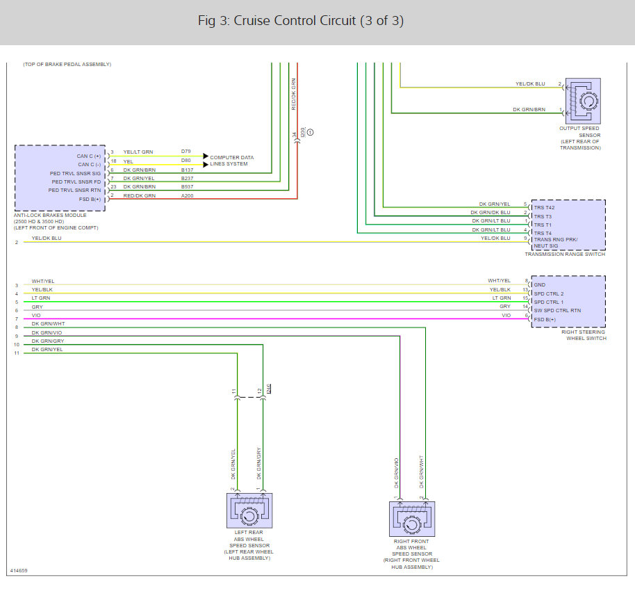

The fact that you reset it and it works is telling me PCM problem but we should check the basics. Here is a wiring diagram so you can see how the system works. Lets run the codes to see what comes up.
