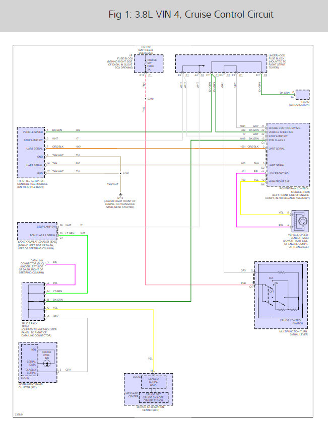

Cruise control engages then kicks out immediately
2006 PONTIAC GRAND PRIX
137,000 MILES • 3.8L • 6 CYL • 2WD • AUTOMATIC
KELSI STAPLETON
Cruise control engages then kicks it out immediately after. All brake lights work no codes or lights on on dash. Fuse is good.
Mar 21, 2018 at 8:26 AM
  • 54,840 POSTS
I would start by checking the codes because an input shaft speeds sensor can cause the cruise to kick out.
Here is a guide to help you get the codes:
Here is the cruise control wiring diagrams so you can see how the system works.
