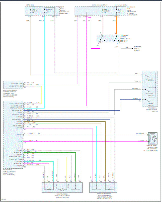

Cruise control stopped working.
Oct 11, 2020 at 1:48 PM
  • 110,248 POSTS
Has anything other than the cruise control stopped? Have you confirmed that the brake light is not staying on? Is the speedometer working properly?
I attached a pic below of the wiring schematic. There aren't too many things that can cause failure. What I would suggest doing is having the CAN bus system scanned to see if there are error codes related to the cruise control. CAN stands for computer area network. Here is a quick video showing how it's done:
https://youtu.be/InIlnsjOVFA
If the basic things above are all okay, this is what should be done.
