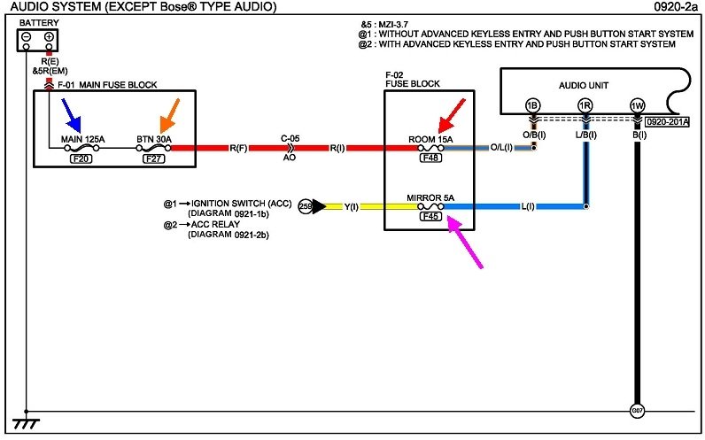

There are two fuses for the radio. One is for the switched circuit that turns the radio on with the ignition switch. The other one is always on to maintain the radio's station presets and clock in memory. Most computers also have memory circuits that are separate from their regular fused circuits. That radio's memory circuit is rarely on its own or with its own fuse. Instead, it is tied in with some other circuit that is always live. That is very commonly the interior light circuit. It could also be the horn or cigarette lighter circuit.

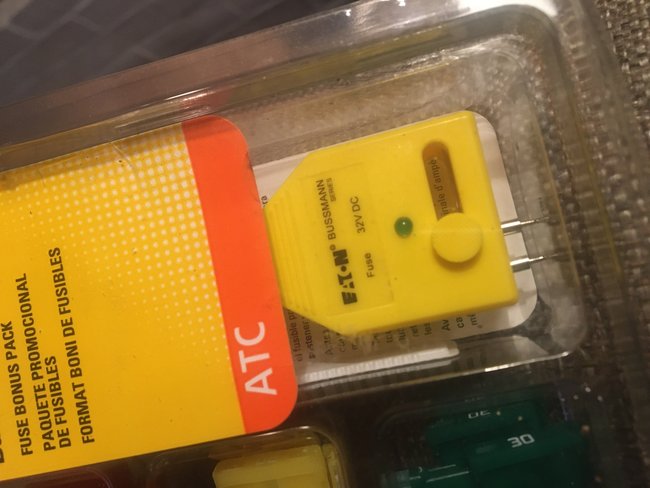

I used a Bussmann fuse tester (attached picture) to test the fuses, but I did not have the car turned on in any way while doing it. I’m guessing this only detects a blown fuse and not a fuse that does not have power flowing through it from another source. I did pull the radio fuse and visually checked it, and it did not appear blown.
Does this style tester tell me anything or do I need to go get a light tester to test all the fuses again with the ignition on?

I'm not familiar with that tester. If it has a small battery inside, it is checking for continuity through the fuse, which should be sufficient.
I was in tv / vcr repair for 35 years, along with auto repair including electrical for almost as long, so a test light is a standard part of my tools. With either a test light or your tester, they aren't of much use for the large fuses that don't have test points on them. All of us are frustrated that checking them can be a time-consuming, tedious job. It is often hard to tell visually if they're okay.

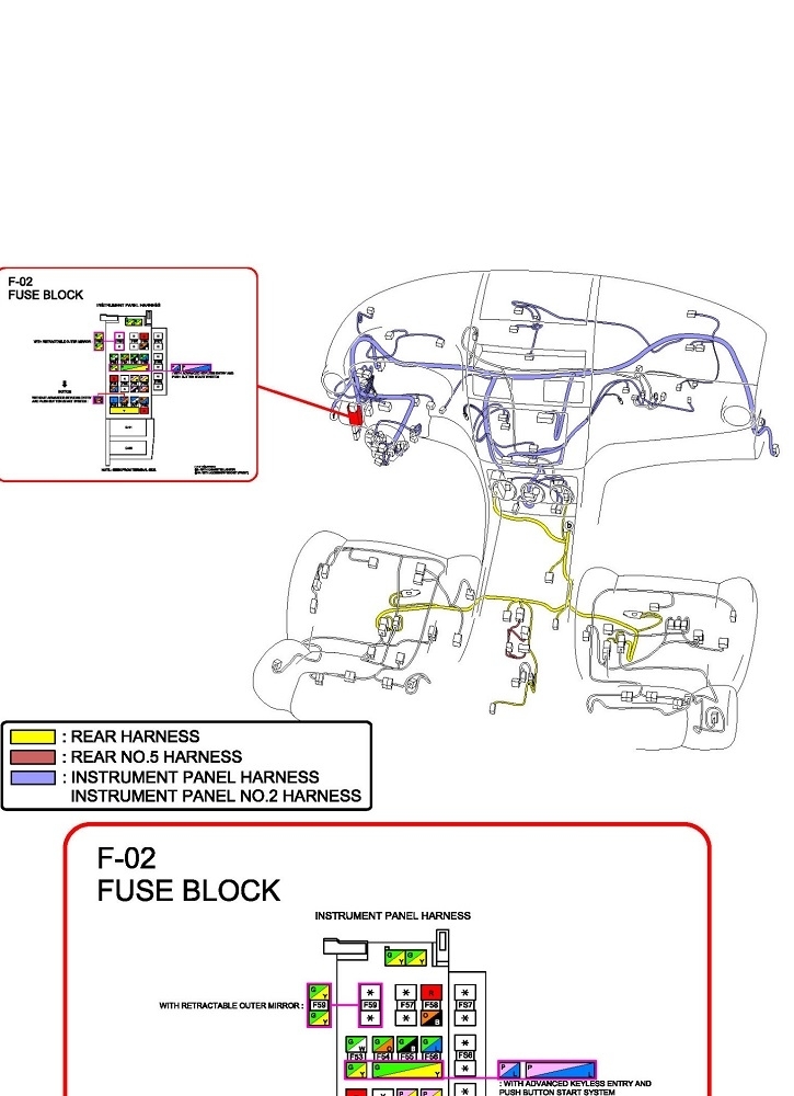

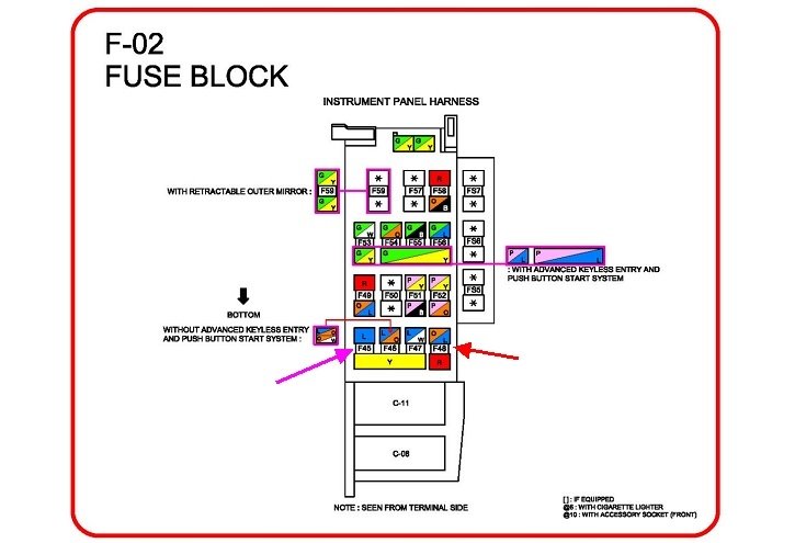

I still think there are some blown fuses that were overlooked. If not, we'll need to pick one dead circuit and concentrate on that. I'd pick the radio since those are the most similar between car brands and models. If we need to go that route, have the radio pulled out with the plug accessible for taking voltage readings. Here again a test light should work fine, but if you have a digital voltmeter, that will work too.
This diagram is part of the base radio system. Note there's actually four fuses shown. The two in question are shown in the drawing. It's hard to read, so I added the nifty pink and red arrows.
