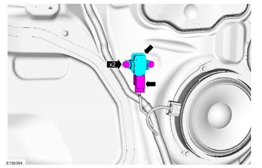

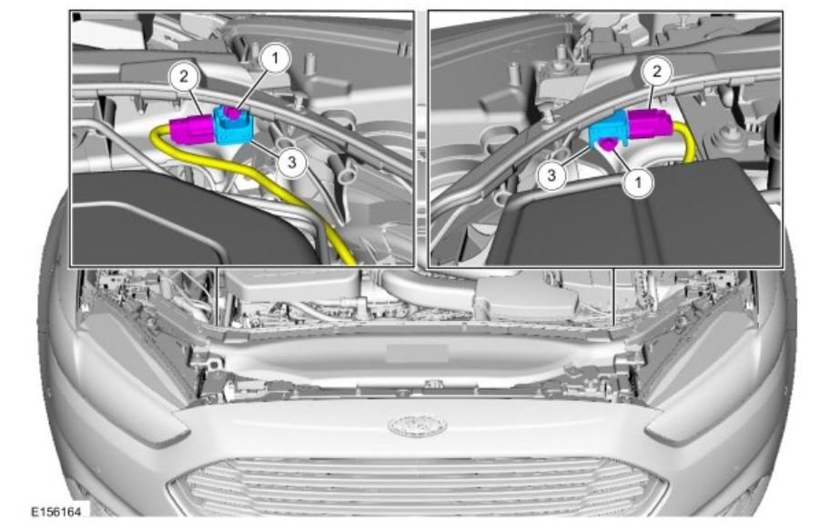

I do not know where is the airbag sensor. I cannot find it.
May 5, 2018 at 1:23 PM

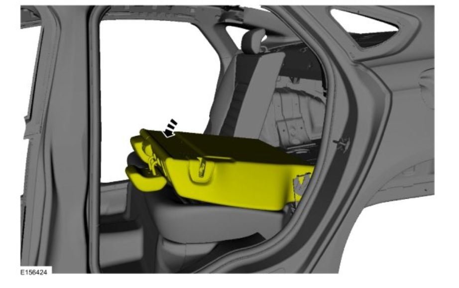

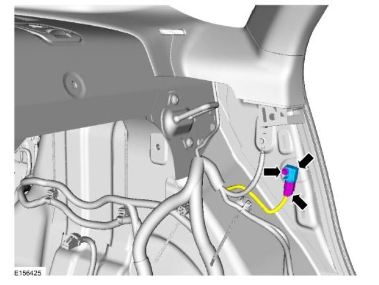

Okay, there are 3 different sensors for the impact system. I attached the location and procedure for a replacement for you.
Front Impact Severity Sensor
Removal
NOTE: Removal steps in this procedure may contain installation details.
1. WARNING: Turn the ignition OFF and wait one minute to deplete the backup power supply. Ignition must remain OFF until repair is complete. Failure to follow this instruction may result in serious personal injury or death in the event of an accidental deployment.
If installing a new component for a SRS (supplemental restraint system) fault, continue to Step 2. Otherwise, turn the ignition off, wait at least one minute and continue to Step 3.
2. Depower the SRS (supplemental restraint system).
Refer to: Supplemental Restraint System (SRS) Depowering and Repowering See: Air Bag(s) Arming and Disarming > Procedures > Supplemental Restraint System (SRS) Depowering and Repowering.
3.
1. Remove the bolt.
Torque : 97 lb.in (11 Nm)
2. Disconnect the electrical connector.
3. Remove the front impact severity sensor.
Installation
1. NOTE: Make sure the front impact severity sensor mating surfaces are clean and free of foreign material.
To install, reverse the removal procedure.
2. If the SRS (supplemental restraint system) was depowered, repower the SRS (supplemental restraint system).
Front Door Side Impact Sensor
Removal
If a SRS (supplemental restraint system) fault is present, continue to Step 2. Otherwise, turn the ignition off, wait at least one minute and continue to Step 3.
2. NOTE: The air bag warning indicator illuminates when the correct RCM (restraints control module) fuse is removed and the ignition is on.
3. Remove the door trim panel.
Refer to: Front Door Trim Panel .
4. Disconnect the electrical connection, remove the bolts and the front door side impact sensor.
Torque : 27 lb.in (3 Nm)
Installation
1. NOTE: Make sure the door and side impact sensor mating surfaces are clean and free of foreign material.
C-Pillar Side Impact Sensor
Removal
3. Remove the C-pillar lower trim panel.
Refer to: C-Pillar Lower Trim Panel .
4. Lower the rear seat backrest.
5. Disconnect the electrical connector, remove the bolt and the side impact sensor.

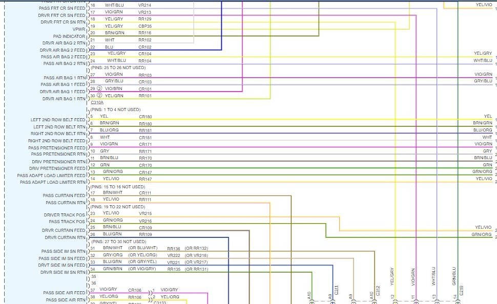

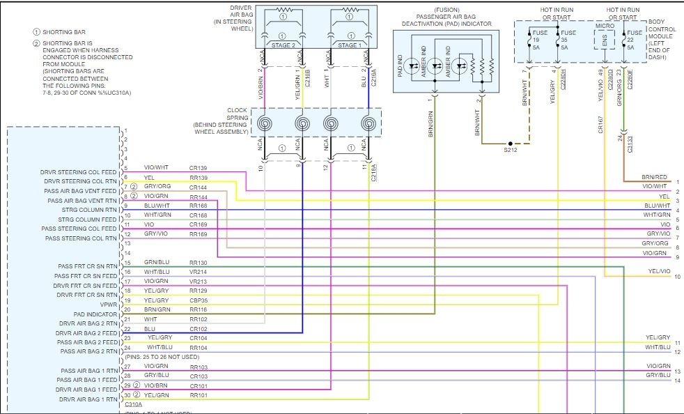

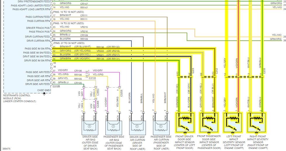

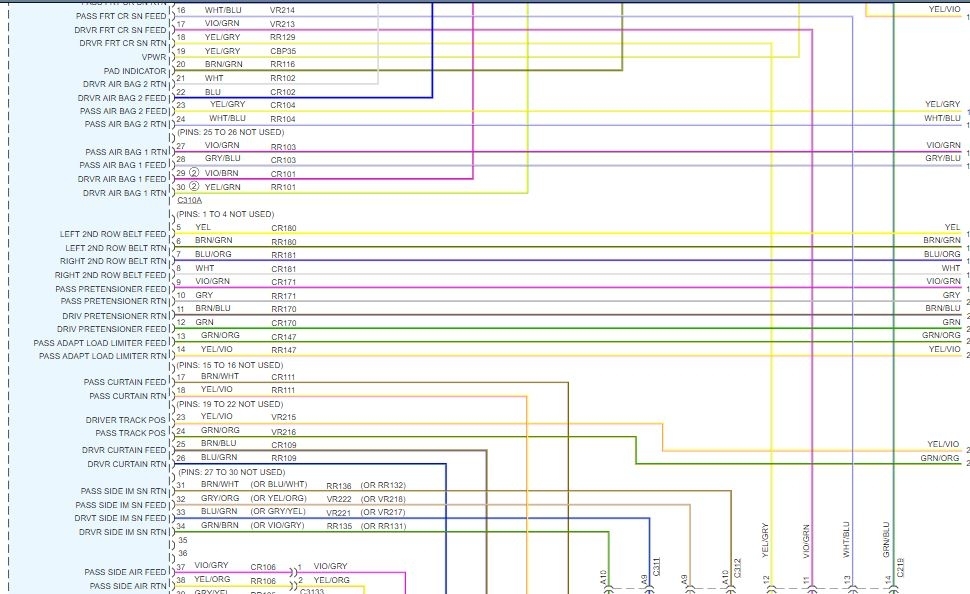

Can you give me the code that was set so I can help narrow the area of failure and pinpoint your issue?

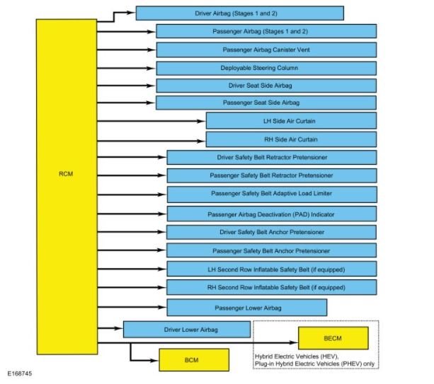

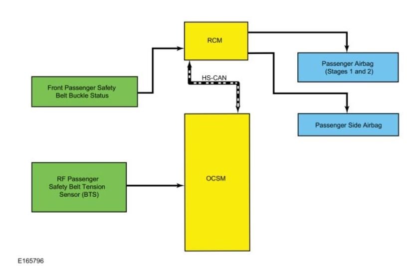

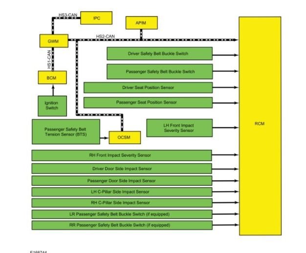

I attached the description of the system for you to view so you get a better understanding of how it works.
The SRS (supplemental restraint system) is controlled by the RCM (restraints control module) , which continually monitors various inputs. When these inputs indicate a frontal or side crash, the RCM (restraints control module) may deploy some components, based upon the severity of the crash and the sensor inputs. To view the SRS (supplemental restraint system) inputs and outputs:
Refer to: Airbag and Seatbelt Pretensioner Supplemental Restraint System (SRS) - System Operation and Component Description See: Air Bag Systems > Components > Airbag and Seatbelt Pretensioner Supplemental Restraint System (SRS) - System Operation and Component Description.
Although some deployable devices may not have activated for all occupants during a crash, it does not mean that something is wrong with the SRS (supplemental restraint system).
The RCM (restraints control module) performs a self-test of the complete SRS (supplemental restraint system) during each startup. In addition to the self-test at start up, the RCM (restraints control module) continuously monitors all of its SRS (supplemental restraint system) components and circuitry for correct operation.

Occupant Classification System (OCS)
The OCS (occupant classification system) classifies the size of the front passenger seat occupant and provides this information to the RCM (restraints control module).
Pressure is applied to the OCS (occupant classification system) bladder when weight of any occupant or object in the front passenger seat is present. The pressure is then transferred through a tube and sensed by the OCS (occupant classification system) pressure sensor within the OCSM (occupant classification system module). The OCSM (occupant classification system module) sends information concerning the weight of any occupant or object on the front passenger seat to the RCM (restraints control module) via the High Speed Controller Area Network 2 (HS2-CAN). The RCM (restraints control module) uses this information when determining if the passenger airbag needs to be deployed in the event of a crash.
The OCS (occupant classification system) is also used for operation of the passenger Belt-Minder(R).
Refer to: Seatbelt Systems - System Operation and Component Description .
To deactivate or reactivate the passenger Belt-Minder(R) feature, Refer to: Seatbelt Minder Deactivating/Activating .
The front impact severity sensors measure acceleration (g-rate) and are hardwired to the RCM (restraints control module). Mounting orientation is critical for correct operation of the front impact severity sensors.
The OCS (occupant classification system) is found only on the front passenger seat. The OCS (occupant classification system) classifies the size of the front passenger seat occupant.
The OCS (occupant classification system) is comprised of a silicone gel-filled bladder mounted between the seat cushion foam and pan, an OCSM (occupant classification system module) which is mounted to the seat frame, and a pressure sensor that is internal to the OCSM (occupant classification system module). Pressure is applied to the OCS (occupant classification system) bladder when weight of any occupant or object in the front passenger seat is present. The pressure is then transferred through a tube and sensed by the OCS (occupant classification system) pressure sensor and OCSM (occupant classification system module). The components of an OCS (occupant classification system) bladder system (bladder, tube, and OCSM (occupant classification system module) with integrated pressure sensor) are serviced as an assembly, and the OCS (occupant classification system) bladder system is serviced as a kit with the seat cushion and seat heater mat (if applicable).
The Belt Tension Sensor (BTS) is a Hall-effect sensor that modifies a reference voltage supplied by the OCSM (occupant classification system module). As the amount of tension applied to the belt varies, so does the voltage that returns to the OCSM (occupant classification system module). The Belt Tension Sensor (BTS) is part of the front passenger safety belt buckle and can only be serviced with the buckle.
Safety Belt Buckle Sensor
The safety belt buckles contain integrated sensors that are Hall-effect switches. The safety belt buckle sensors are serviced with the safety belt buckle.
Safety Belt Tension Sensor (BTS)
The safety Belt Tension Sensor (BTS) is a 3-wire Hall-effect sensor that is part of the front passenger safety belt buckle and cannot be serviced separately from the front passenger safety belt buckle assembly.
Seat Position Sensor
The seat position sensor is a Hall-effect sensor which indicates the position of the seat along the seat track. The sensor detects the presence of a shunt bracket on the track, indicating the seat has moved past a certain point in the adjustment range.
Side Impact Sensor - C-pillar
The C-pillar side impact sensors measure acceleration (g-rate), and are hardwired to the RCM (restraints control module). Mounting orientation is critical for correct operation of the C-pillar side impact sensors.
Side Impact Sensor - Front Door
The front door side impact sensors measure air pressure within the door in order to detect certain crashes, such as a side impact. Mounting position and orientation is critical for correct operation of the front door side impact sensors.
