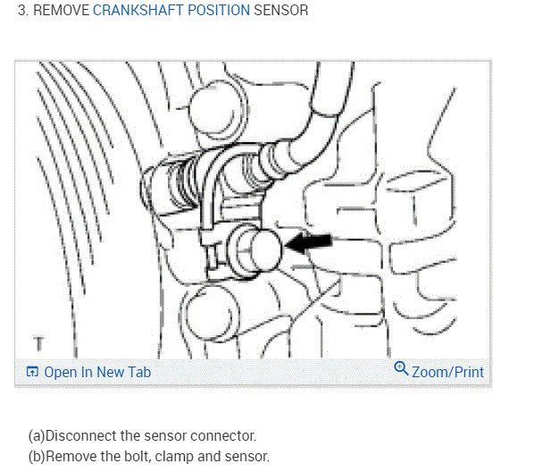

If you feel that could be the issue, the sensor is located beside the crankshaft pulley (harmonic balancer). Here is a link that explains in general how one is replaced:

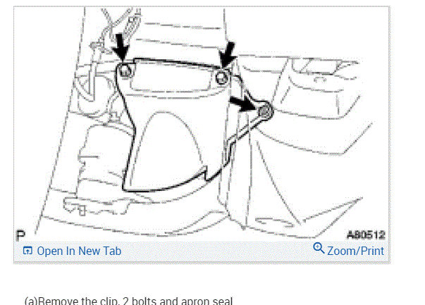

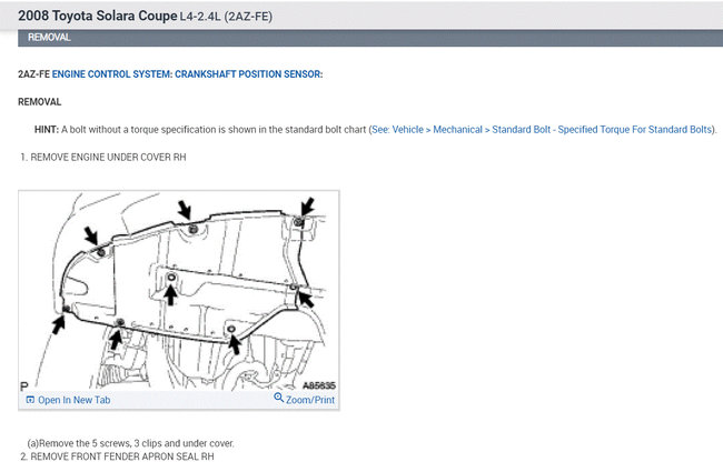

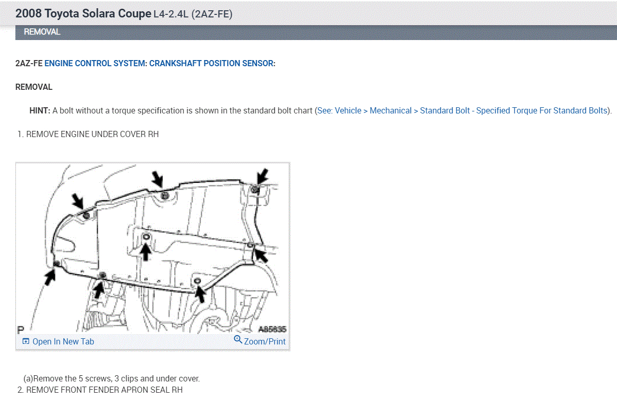

If you look at the pics below, they are the directions specific to your vehicle.

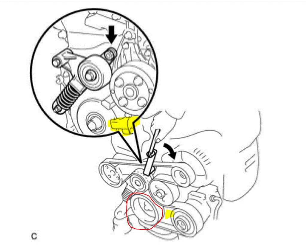

See pics below. The last pic shows the harmonic balancer and crankshaft sensor. I highlighted the sensor and where it will be found, and I circled the balancer.
