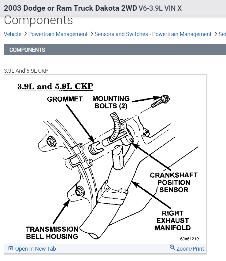

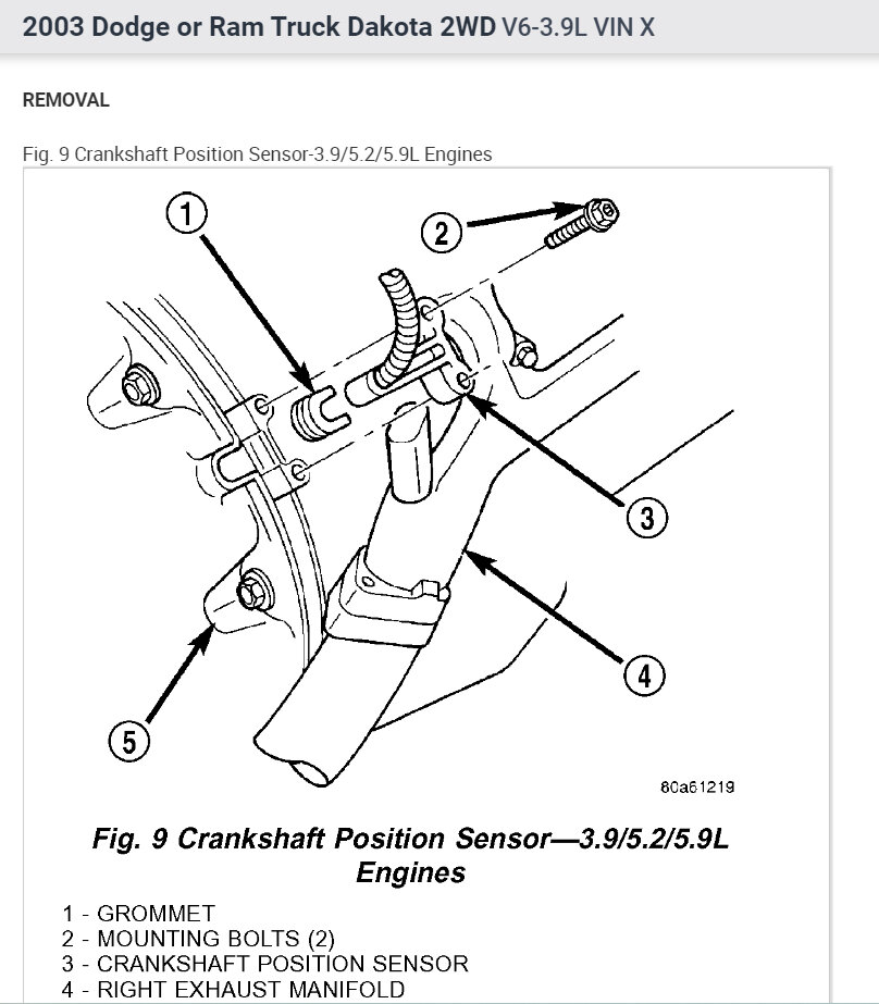

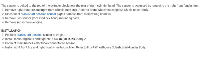

I received my new crankshaft sensor today and compared it to my old one. They are all the same size, but my problem is that the new one doesn't seem to be mounted as far down on the bracket as the original, making it longer by bout 1/4". Is it defective or do I compensate by adding washers?
Jul 27, 2023 at 12:58 PM
  • 55,399 POSTS
You can try that but I would get the OEM sensor, so it fits correctly. Check out the images (below). Please let us know what happens.
