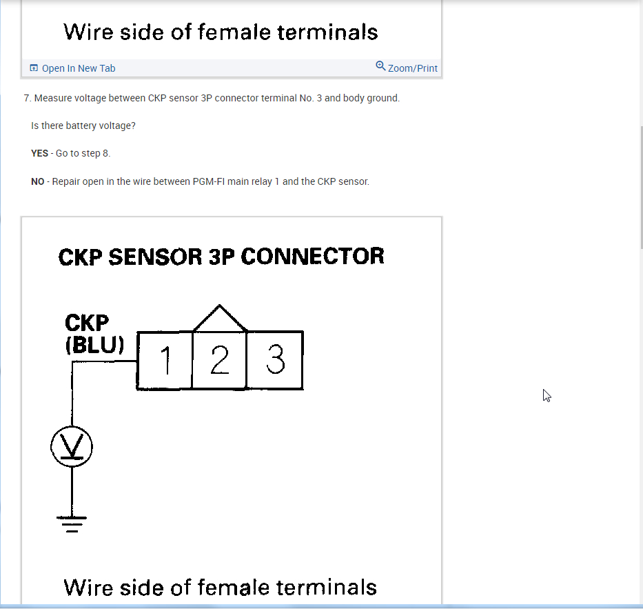

Code P0335, Crankshaft sensor
ALLY RAMSEY
  • 2004 HONDA JAZZ
  • 1.4L
  • 4 CYL
  • 2WD
  • MANUAL
  • 84,000 MILES
Bought new sensor fit in car but code still coming up as p0335.

Have you made sure that there are no connection issues at the crank sensor? Is the connector in good shape, the pins in it not pushed in or corroded?
Also, have you checked to make sure it is a spark related issue?
______________________

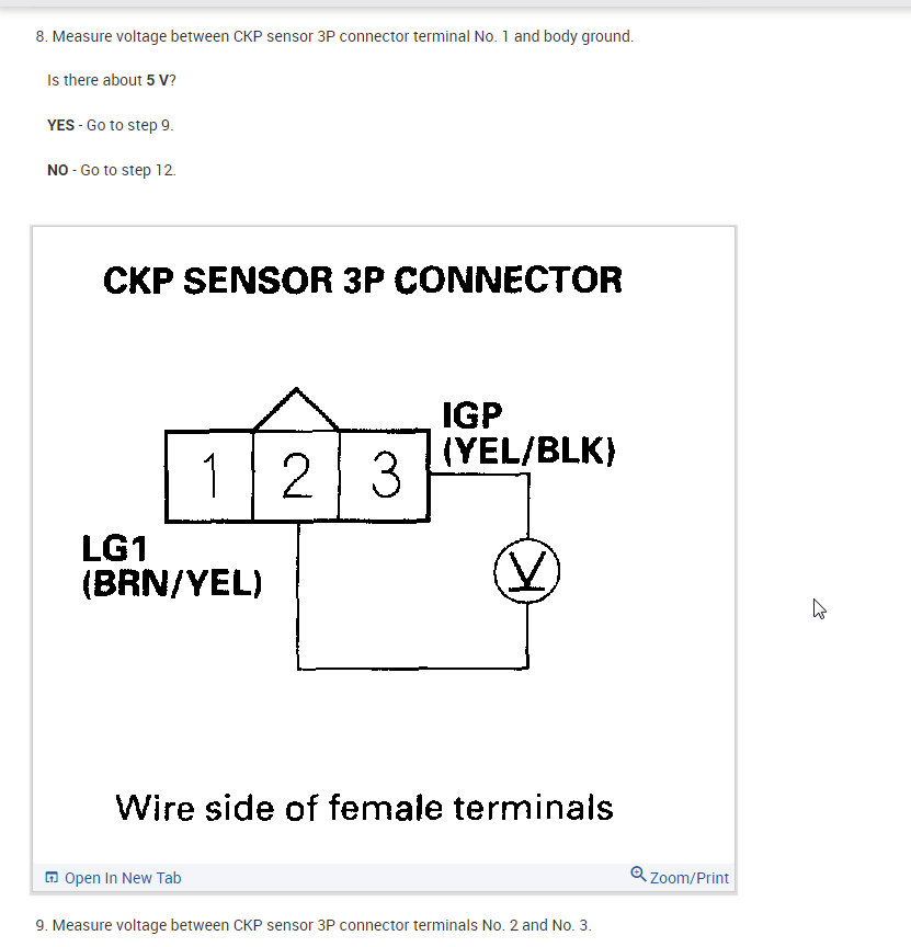

If you have no spark, run through this short diagnostic procedure. It should be very close to what you have. The attached pics correlate with these directions.
P0335
Vehicle ALL Diagnostic Trouble Codes ( DTC ) Testing and Inspection P Code Charts P0335
P0335

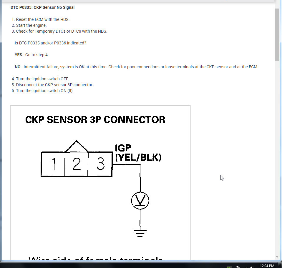

DTC P0335: CKP Sensor No Signal
1. Turn the ignition switch ON (II).
2. Do the DTC CLEAR in the CLEAR MENU with the Honda PGM Tester or the HDS.
3. Start the engine.
4. Check for Temporary DTCs or DTCs in the DTCs MENU with the Honda PGM Tester or the HDS.
Is DTC P0335 indicated?
YES - Go to step 5.
NO - Intermittent failure, system is OK at this time. Check for poor connections or loose terminals at the CKP sensor and the ECM/PCM.
5. Turn the ignition switch OFF.

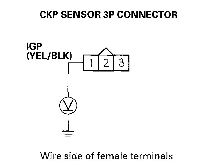

6. Disconnect the CKP sensor 3P connector.
7. Turn the ignition switch ON (II).
pic 1
8. Measure voltage between CKP sensor 3P connector terminal No.1 and body ground.
Is there battery voltage?
YES - Go to step 9.
NO - Repair open in the wire between the CKP sensor and PGM-FI main relay 1, then go to step 19.

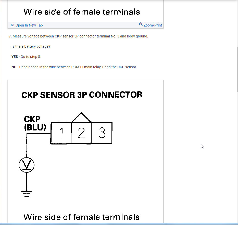

pic 2

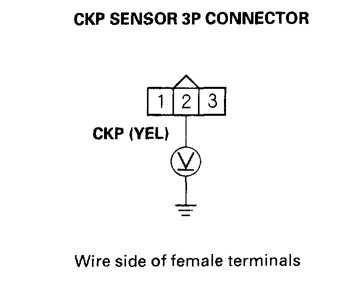

9. Measure voltage between CKP sensor 3P connector terminal No.2 and body ground.
Is there about 5 V?
YES - Go to step 10.
NO - Go to step 11.
pic 3

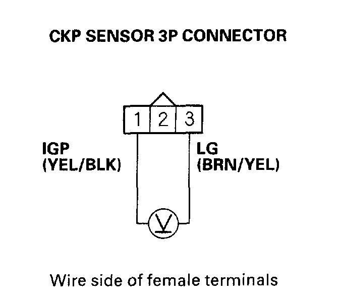

10. Measure voltage between CKP sensor 3P connector terminal No.1 and No.3.
Is the
re battery voltage?

Hi, voltage pin1 no voltage on other pins.
Monday, January 18th, 2021 AT 2:04 AM
  • 109,885 POSTS

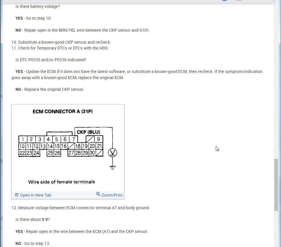

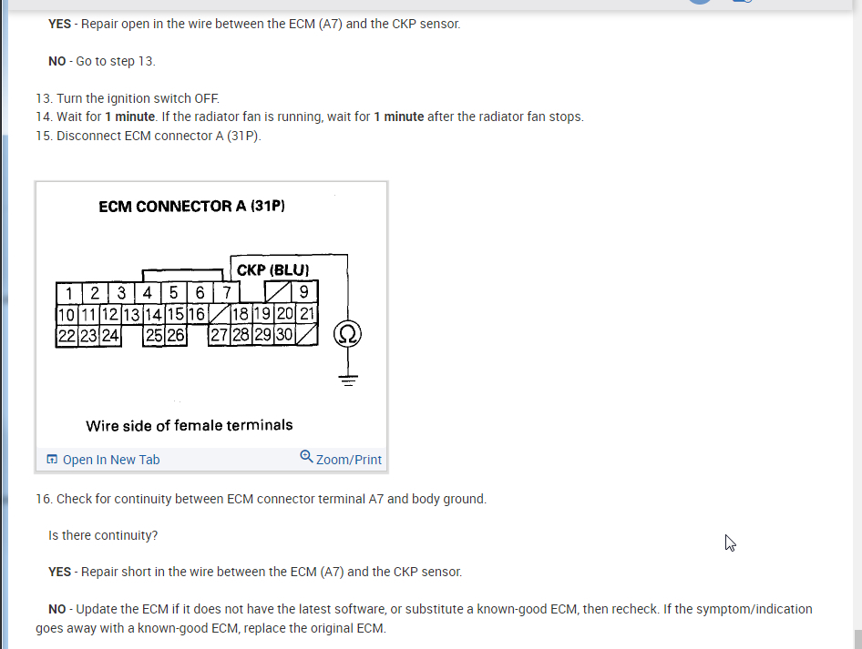

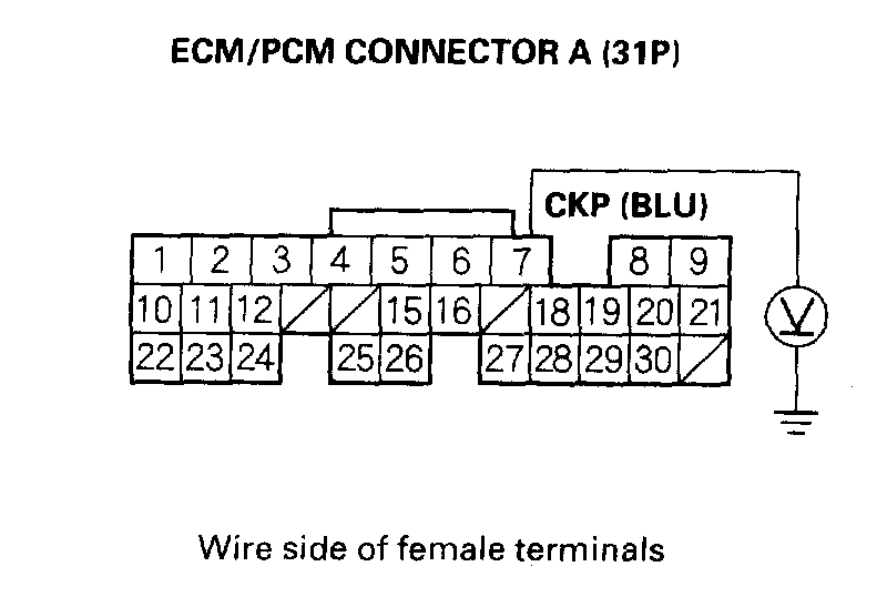

I have a feeling you got a bad sensor. Here are the pick up directions from where you left off. Let me know what you find.
9. Substitute a known-good CKP sensor and recheck.
Is DTC P0335 and/or P0336 (P0339)* indicated?
YES - Update the ECM/PCM if it does not have the latest software, or substitute a known-good ECM/PCM, then recheck. If the symptom/indication goes away with a known-good ECM/PCM, replace the original ECM/PCM.
NO - Replace the original CKP sensor

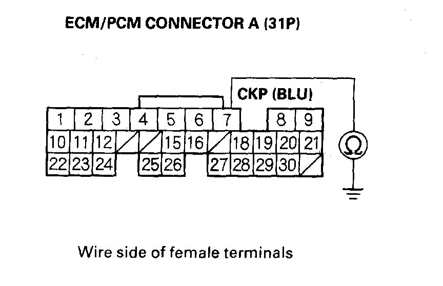

pic 1

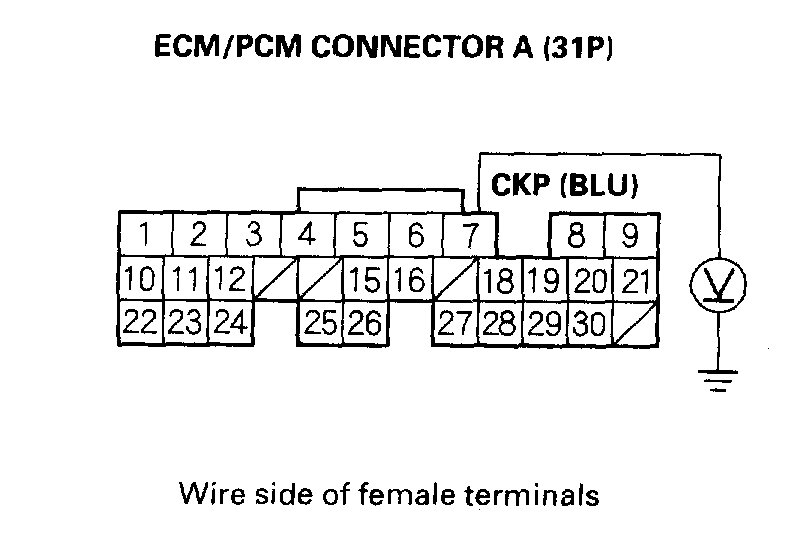

10. Measure voltage between ECM/PCM connector terminal A7 and body ground.
Is there about 5 V?
YES - Repair open in the wire between the ECM/PCM (A7) and the CKP sensor.
NO - Go to step 11.
11. Turn the ignition switch OFF.

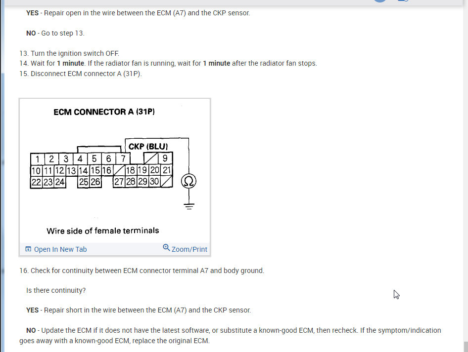

12. Disconnect ECM/PCM connector A (31 P).
Pic 2
13. Check for continuity between ECM/PCM connector terminal A7 and body ground.
Is there continuity?
YES - Repair short in the wire between the ECM/PCM (A7) and the CKP sensor.
NO - Update the ECM/PCM if it does not have the latest software, or substitute a known-good ECM/PCM, then recheck. If the symptom/indication goes away with a known-good ECM/PCM, replace the original ECM/PCM.

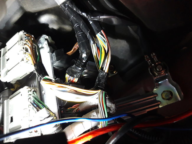

ALLY RAMSEY

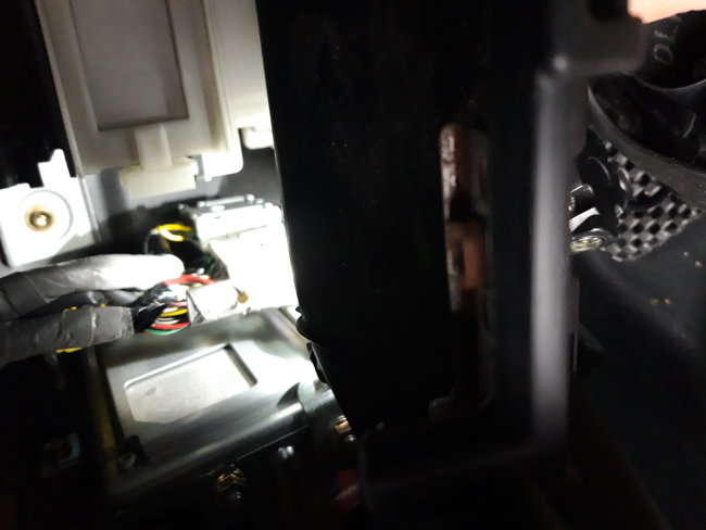

This is a pic of my ECU can you tell me which is the one I need to disconnect and how? Thanks
Wednesday, January 27th, 2021 AT 7:29 AM
  • 109,885 POSTS
I have to be honest, it's hard to tell from the pics. It looks it is the one in pic 1.
