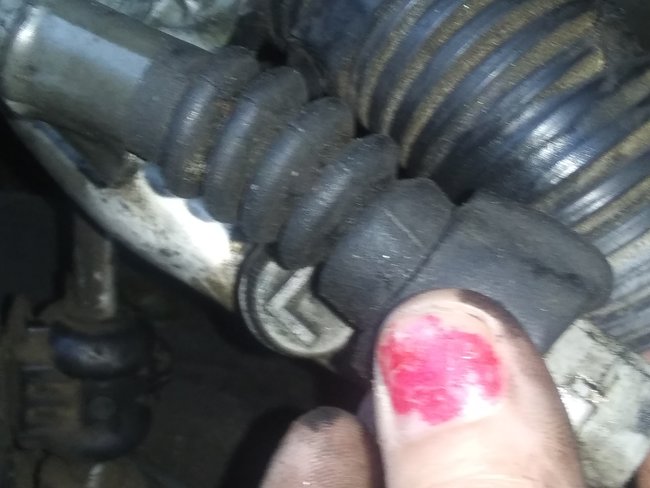

DEE DEE2
  • 7 POSTS

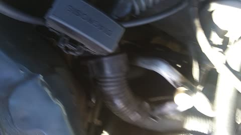

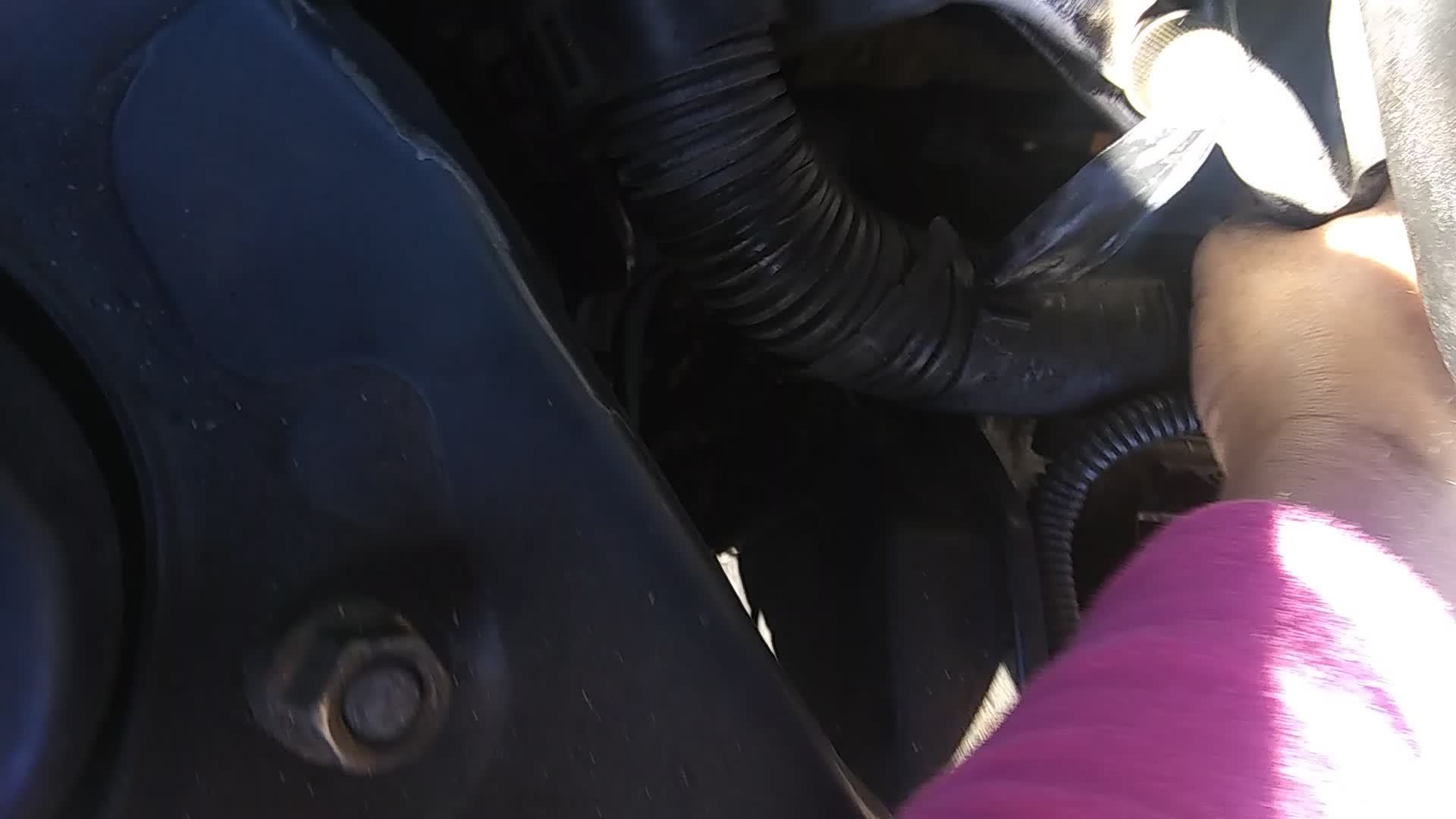

My ex vandalized my car and it won't start. i was looking under hood Of my car listed above CE model and the wiring harness that connects to fuel injectors has a connector. if standing on passenger side looking it goes to the left it circle connected and for the life of me can't find out where it hooks up at .
Feb 22, 2021 at 9:12 AM (Merged)
  • CERTIFIED EXPERT
Can you get a couple pictures of this connector and we should be able to find where it goes? Clearly there are quiet a few connectors so seeing it and the general location will help us figure out what it may be.
Also, if you can get codes that should help because I am sure you will have an open circuit code for whatever it is.

Here's a video:

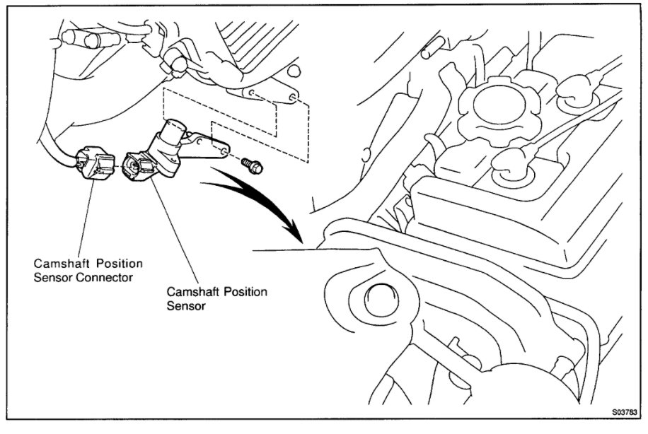

  • CERTIFIED EXPERT
okay . That looks like the cam sensor. Here is the location of that, can you try and see if that appears to be it? If not, can you get a picture of exactly where the harness is laying? That video helped but it was a little quick on where the harness was laying. Lastly these wiring harness have what we call a memory. Meaning they seem to fall where they are to be connected so we need to look all over the back of the engine and even from underneath to look for a sensor that does not have its connector.
The other thing we can do is get the codes. That will tell us what has an open circuit and we can get the info on that sensor.
Check out the location attachment for more info. Thanks

DEE DEE2
  • 7 POSTS

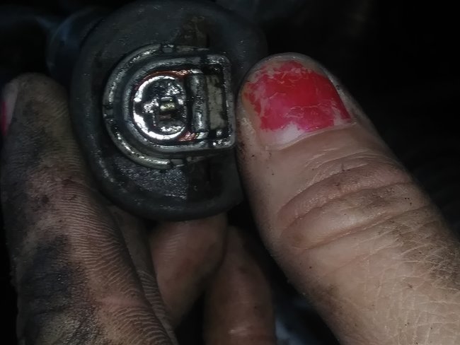

Wasn't camshaft position sensor . The black piece is rubber and the connected is gray it is coming off the same thing as fuel injectors but to the left.

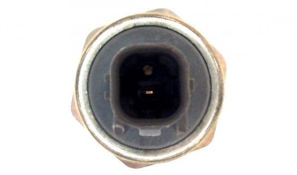

DEE DEE2
  • 7 POSTS

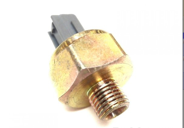

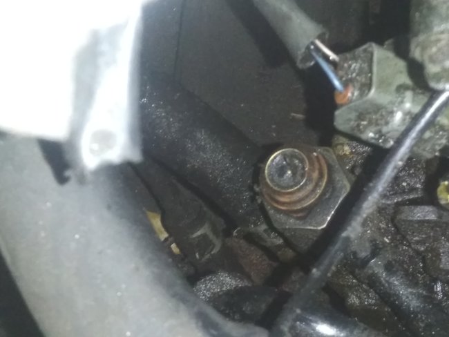

This is under the camshaft and looks as though it goes to something. Just copper piece standing straight up.

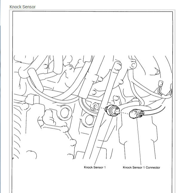

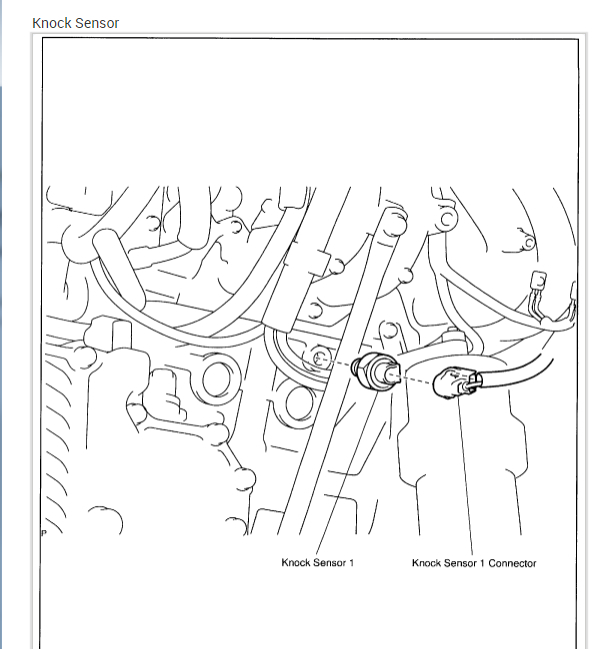

  • CERTIFIED EXPERT
Got it. Thanks for that. That is the knock sensor. Looks like the connector is broken off the actual sensor. Take a look at these attachments. That just simply unscrews and you install the new one. However, you need to most likely get the connector from the sensor off the actual connector. You should be able to release it and get it off. If not you will need to replace the connector as well.
The only thing I am concerned about is, that may not be the reason it is not starting. Normally they will not prevent the engine from running if unplugged. It may misfire but it should still run. So he may have done other things to it as well.
I would do what you have to in order to get the codes from it as we need to find out what else is possibly off.

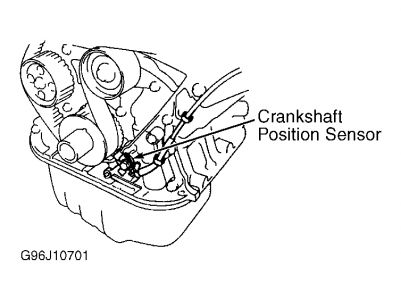

The crank sensor cold should read between 985-1600 ohms of resistance. Also, the car will crank with a bad sensor but it will not start.
I am with you - - change the crank sensor.

Problem solved. It was the crank position sensor. When I took the old one out ,I found the wire had a wear spot and a small break. Started with first turn with new sensor. I still don't know why I didn't a check engine light or a code in the PCM. Thanks for the idea toyotech ,I've run into that before.
