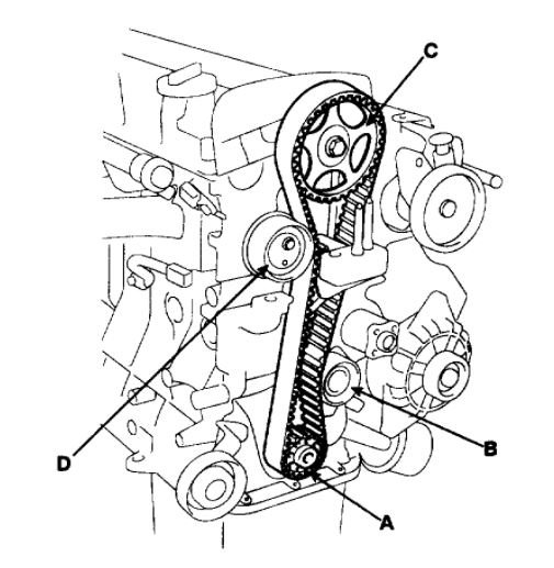

So I have the vehicle listed above and I'm in need of guidance. It cranks but won't start. It shut off while I was driving. No misfire, no shaking. Nothing. Just shut off of nowhere and wouldn't start. I checked the fuel pump and it works. I checked the plug wires and I have spark. I tried spraying starting fluid in the throttle body and got nothing. I checked the obd scanner for codes, but no codes. So I know it's getting fuel, fire, and air. I'm not sure what my next move should be. Compression test? Any help would be appreciated!

Good morning,
Yes, that is next. It could be a failed timing belt.
https://www.2carpros.com/articles/how-a-timing-belt-works
I attached a YouTube video of the procedure for you to view.
https://www.youtube.com/watch?v=5JnzptMePkM
