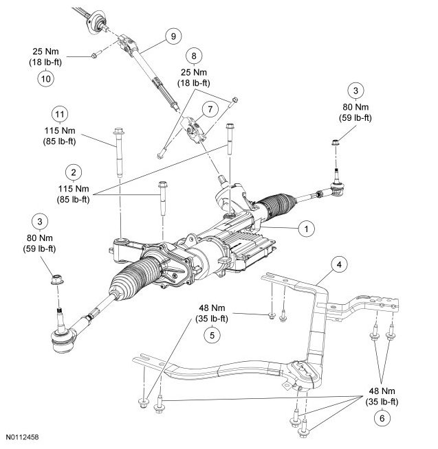

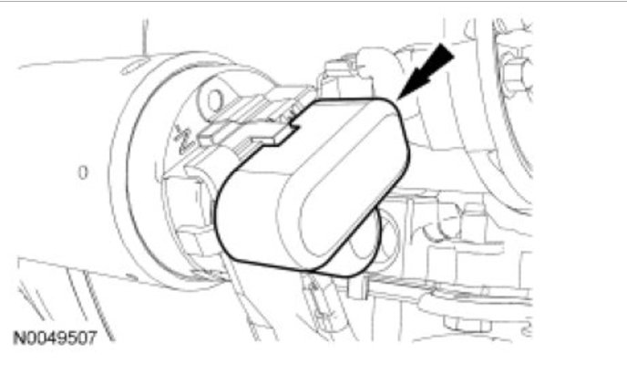

If the battery checks out then the electronic steering sounds like it needs replacing. Here are the instructions for that so you can see what needs to be done. Start with the battery disconnected.
Removal:
If installing a new steering gear, connect the scan tool and upload the module configuration information from the Power Steering Control Module (PSCM). For additional information, refer to Module Configuration See: Powertrain ManagementComputers and Control SystemsInformation BusTesting and InspectionProgramming and RelearningProgrammable Module Installation (PMI).
Disconnect the battery ground cable. For additional information, refer to Battery, Mounting and Cables See: Starting and ChargingBatteryBattery CableService and Repair.
Vehicles with 5.4L (4V) engine
Remove the battery and battery tray. For additional information, refer to Battery and Battery Tray-Exploded View in Battery, Mounting and Cables See: Starting and ChargingBatteryService and RepairBattery and Battery Tray - Exploded View. Remove the Air Cleaner (ACL) outlet pipe. For additional information, refer to Intake Air Systems Components-Exploded View, 5.4L (4V) in Intake Air Distribution and Filtering See: Powertrain ManagementFuel Delivery and Air InductionIntake Air DuctDiagrams.

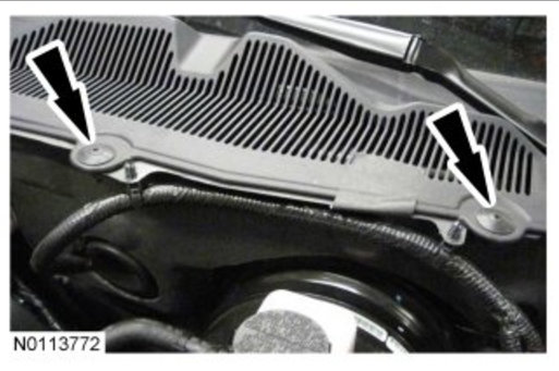

Remove the 2 LH cowl vent screen plastic rivets.

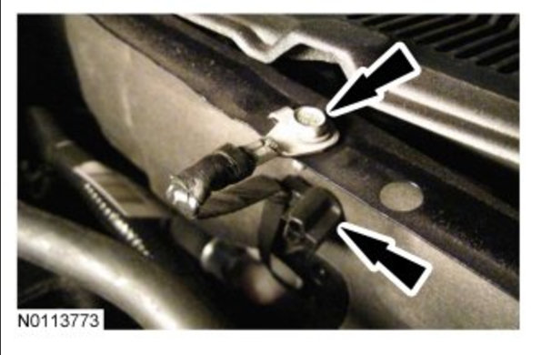

Lift the cowl screen and remove the ground strap bolt.
Detach the ground strap retainer from the cowl.
Disconnect the brake booster vacuum hose quick connect at the engine.

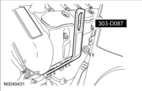

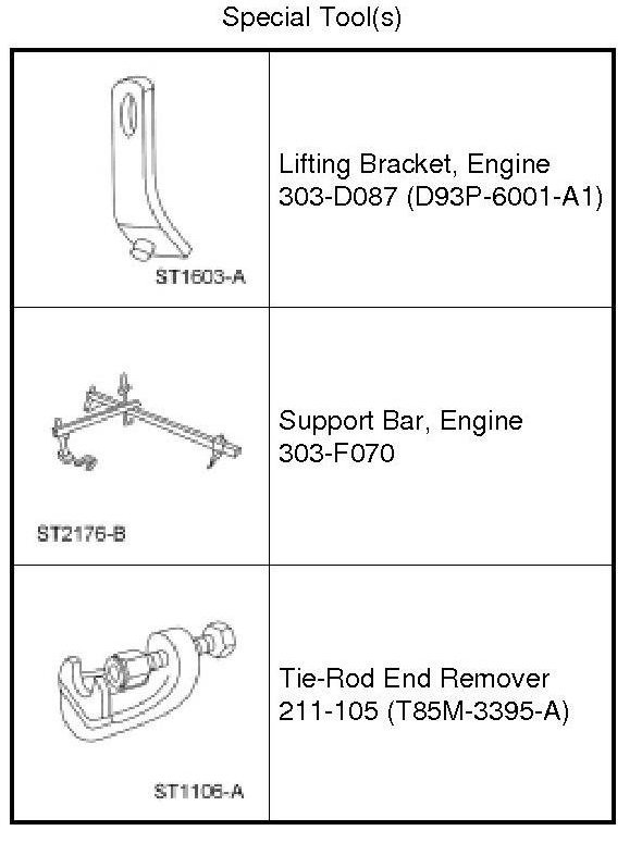

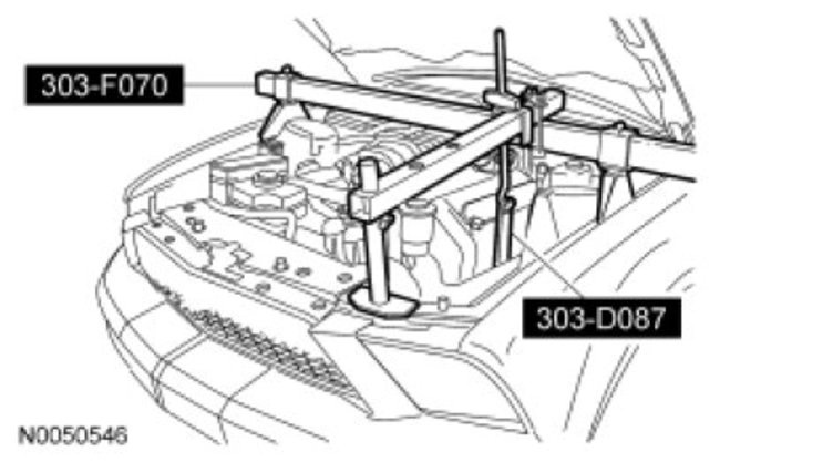

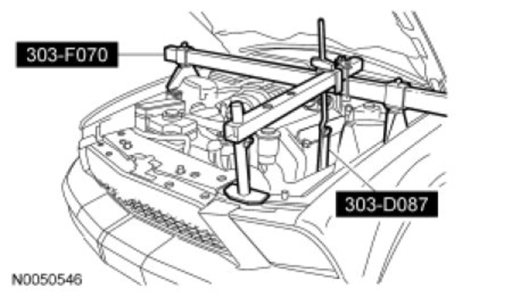

Install the Engine Lifting Bracket.

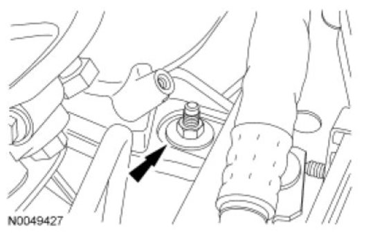

Remove the LH engine mount nut.
NOTICE: Lift engine approximately 45 mm (1.771 in) from the bottom of the engine mount to the bottom of the engine bracket ensuring that no contact is made with the bulk head or damage to components may occur.
Install the Engine Support Bar.
Using the Engine Lifting Bracket and Engine Support Bar, raise the LH side of the engine to gain clearance for removal of the LH steering gear mounting bolt.
With the vehicle in NEUTRAL, position it on a hoist. For additional information, refer to Jacking and Lifting See: Wheels and TiresVehicle LiftingService and Repair.

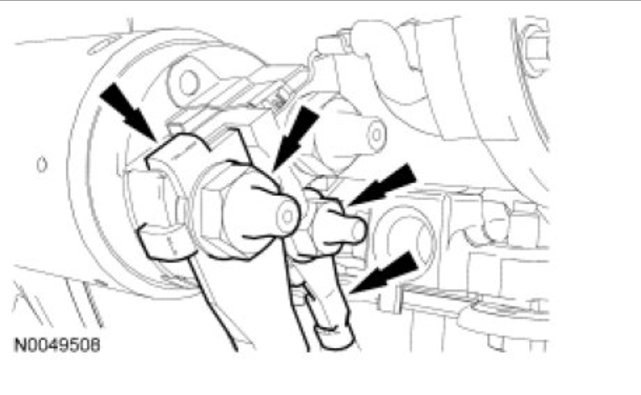

Remove the starter solenoid terminal cover.
Remove the 2 nuts and disconnect the 2 wires from the starter solenoid.
Position the wheels to gain access to the steering column shaft coupling-to-steering gear bolt.
NOTICE: Do not allow the steering column to rotate while the steering column shaft is disconnected from the steering gear or damage to the clockspring may occur. If there is evidence that the steering column has rotated, the clockspring must be removed and recentered. For additional information, refer to Supplemental Restraint System See: Restraints and Safety SystemsAir Bag SystemsClockspring Assembly / Spiral CableService and Repair.
Remove the steering column shaft coupling-to-steering gear bolt.
Discard the bolt.

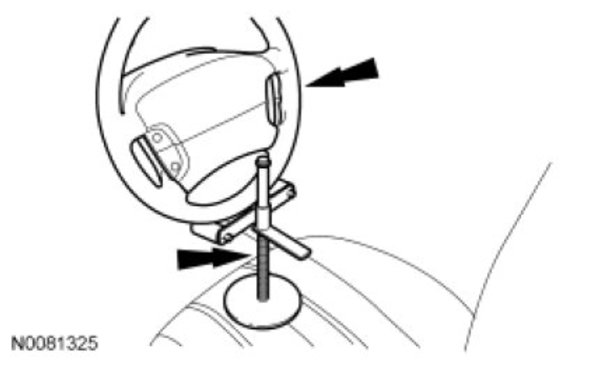

NOTE: Use a steering wheel holding device (such as Hunter(R) 28-75-1 or equivalent).
Using a suitable holding device, hold the steering wheel in the straight-ahead position.
NOTE: The steering column shaft coupling will not be completely separated from the steering gear.
Slide the steering column shaft coupling upwards on the steering gear input shaft.
Remove the wheels and tires. For additional information, refer to Wheels and Tires See: Wheels and TiresService and RepairRemoval and Replacement.

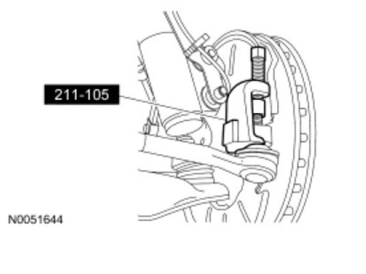

Remove and discard the 2 tie-rod end nuts.
NOTICE: Do not use a hammer to separate the outer tie-rod end from the wheel knuckle or damage to the wheel knuckle may result.
Using the Ball Joint Separator, separate the tie-rod ends from the wheel knuckles.

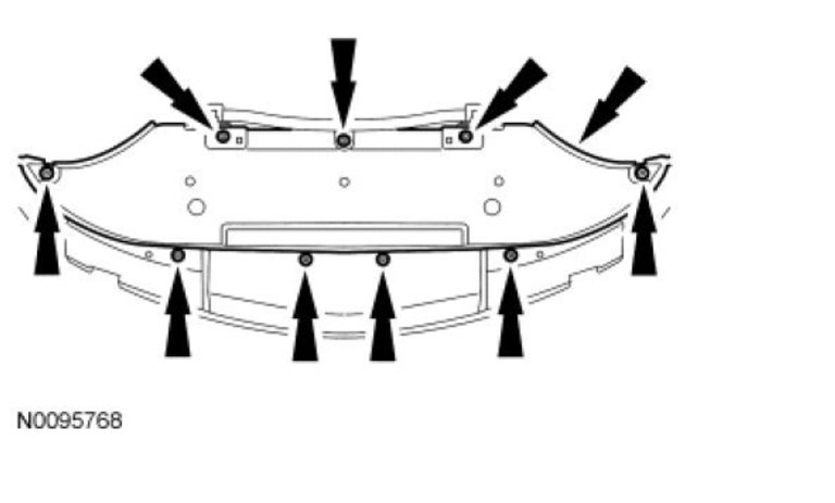

Remove the 9 screws and the lower splash shield.
If equipped, loosen the 2 cross member brace nuts.
If equipped, remove the 6 cross member brace bolts and the cross member brace.
Vehicles with automatic transmission
Remove the 2 transmission cooler line bracket nuts and position tubes aside.
All vehicles
Remove the 4 rearward subframe crossmember brace nuts and crossmember brace.

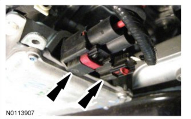

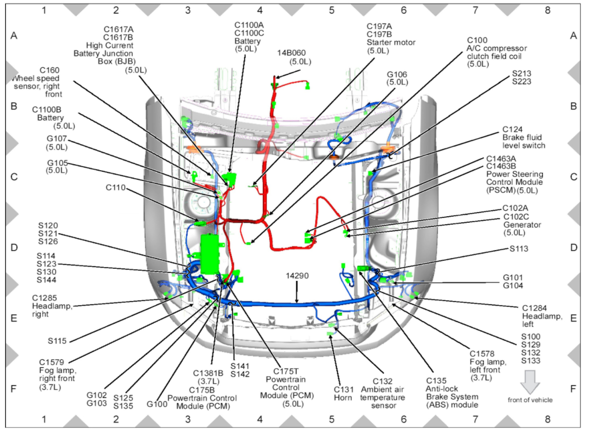

NOTICE: The ignition must be off when disconnecting Electronic Power Assist Steering (EPAS) electrical connectors. Failure to follow this direction may lead to DTCs being set in the EPAS module that can not be cleared, and result in the need to install a new EPAS assembly.
Release the 2 red Connector Position Assurance (CPA) features and disconnect the 2 Electronic Power Assist Steering (EPAS) electrical connectors.
Detach the wiring harness pin-type retainers.
NOTE: If equipped with a 5.4L (4V) engine, it may be necessary to use a pry bar between the LH engine mount and engine bracket, pulling the engine forward slightly to remove LH steering gear bolt

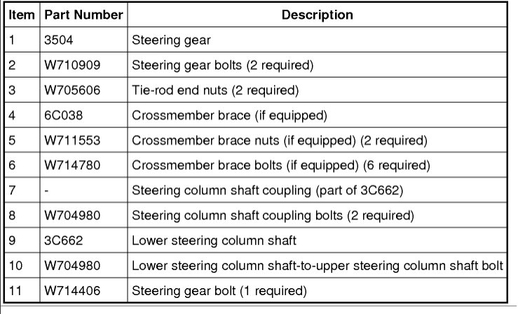

Remove the 3 steering gear bolts and the steering gear.
Discard the bolts.

Position the steering gear, attach the steering column coupling and install the 3 steering gear bolts.
Tighten to 115 Nm (85 lb-ft).

Install the LH engine mount nut.
Tighten to 63 Nm (46 lb-ft).

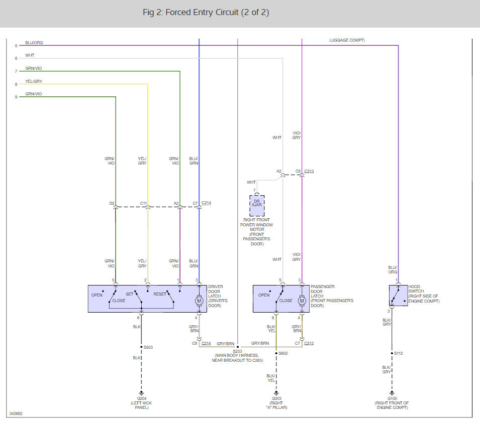

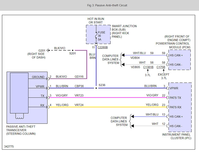

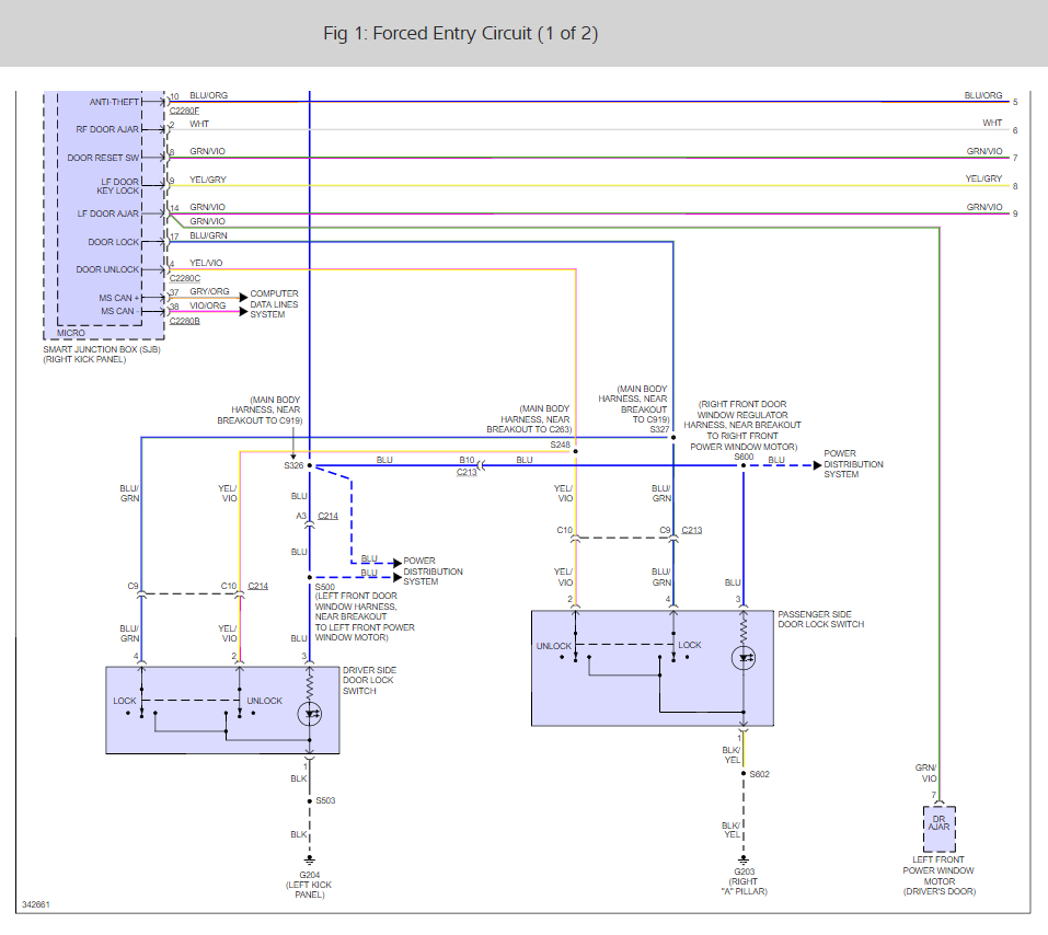

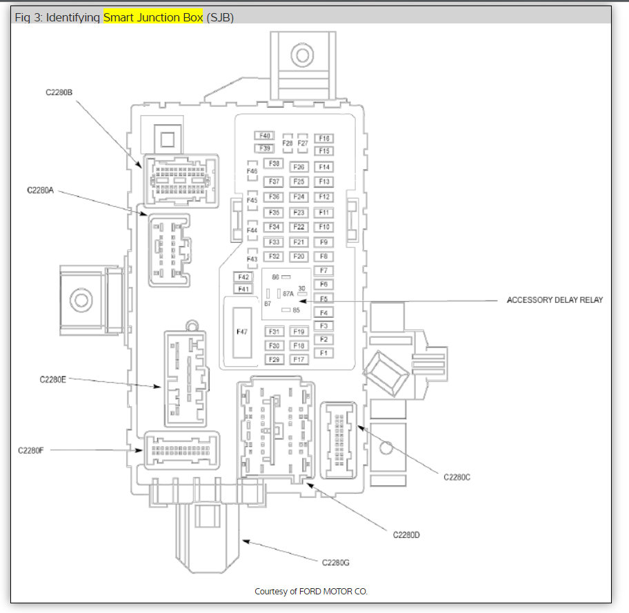

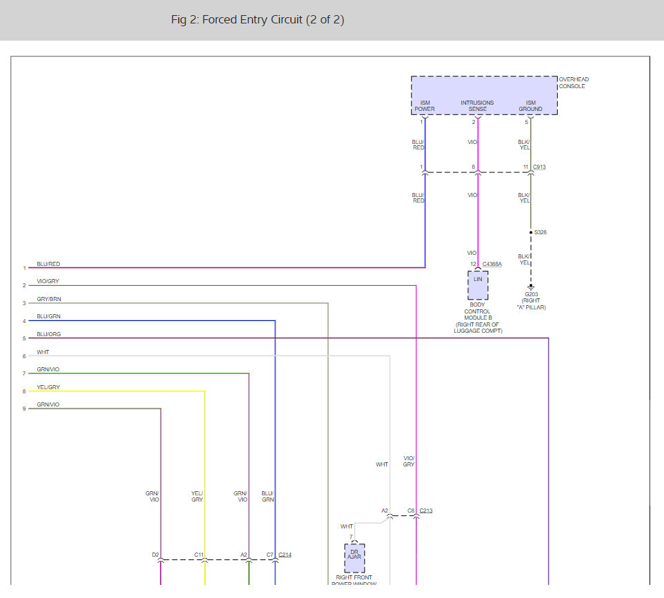

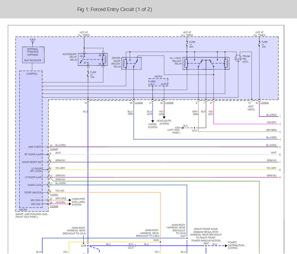

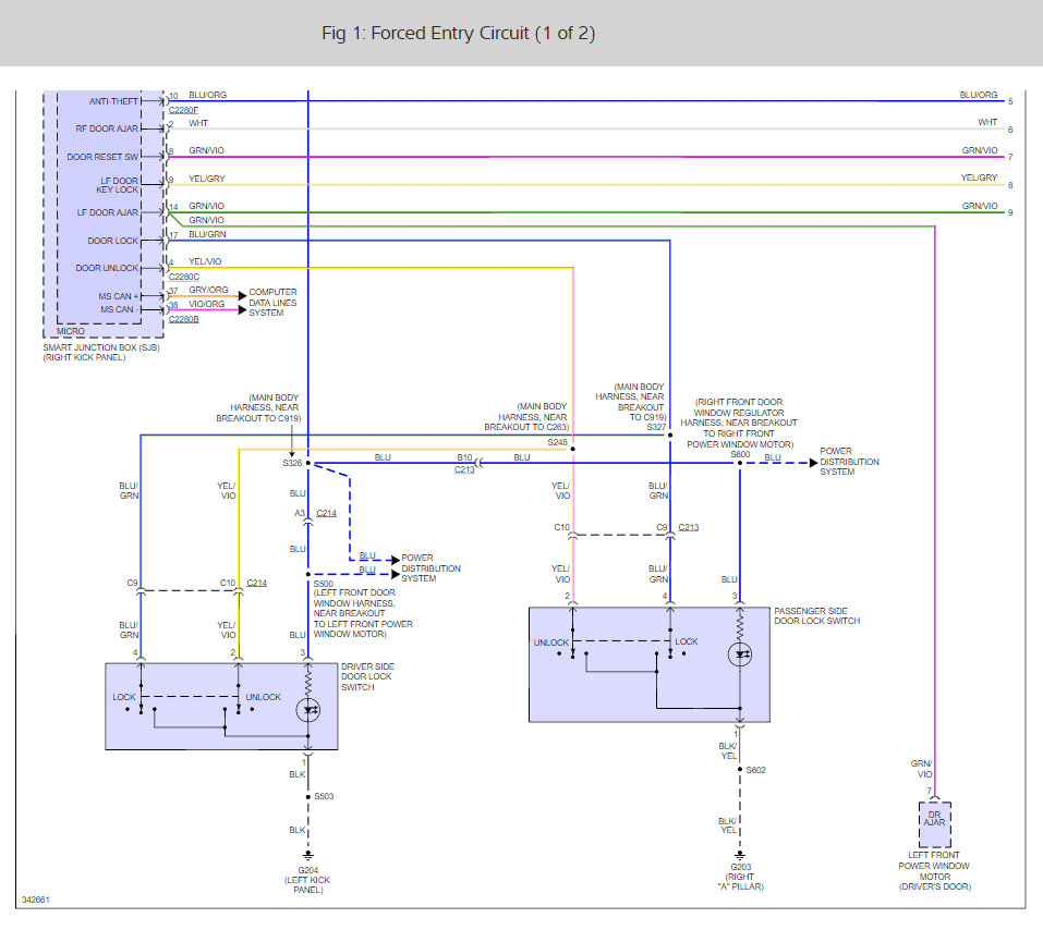

Okay I see, I don't know why they would tell you to sell the car the problem is something it not magic. There are two things I suspect the problem can be either the passive anti theft transceiver is out or the smart junction box is weak and needs to be replaced. Here are some diagrams of the system (below)
Normal Operation [ Pinpoint Test K: The Autolock Does Not Operate Correctly ]
The Smart Junction Box (SJB) energizes the lock relay based on input from the ajar switches, the ignition switch, the Transmission Range (TR) sensor and the vehicle speed signal. The SJB locks the doors when the following conditions are met:
All the doors are closed
The ignition switch is in the ON position
The vehicle is shifted into any gear putting the vehicle in motion
The vehicle attains a speed greater than 20 km/h (12 mph)
This pinpoint test is intended to diagnose the following:
Wiring, terminals or connectors
Programming
Door ajar switches
Vehicle speed signal input from the Instrument Panel Cluster (IPC)
SJB
and
Pinpoint Test A: The Alarm System Does Not Arm/Disarm From The Driver Door Lock Cylinder
Refer to SYSTEM WIRING DIAGRAMS article, Remote Keyless Entry and Alarm, for schematic and connector information.
NOTE: The intrusion and inclination protection features cannot be activated when locking the vehicle with the door lock cylinder. This allows raising the vehicle on a hoist, transporting or towing the vehicle, or when authorized motion inside the vehicle is likely.
Normal Operation
The Smart Junction Box (SJB) monitors the driver door lock through the set/reset switch (part of the driver door latch) and the set and reset input circuits. When a key in the door lock cylinder is turned to the lock position it grounds the set circuit signalling the SJB to arm the alarm. When a key in the door lock cylinder is turned to the unlock position it grounds the reset circuit signalling the SJB to disarm the alarm. The driver door latch has a dedicated ground circuit that is used for the door ajar and set/reset switches.
DTC B2100 (Door Driver Key Cylinder Switch Failure) - an on-demand that sets when the SJB detects a short to ground on the driver door lock cylinder set or reset input circuits.
