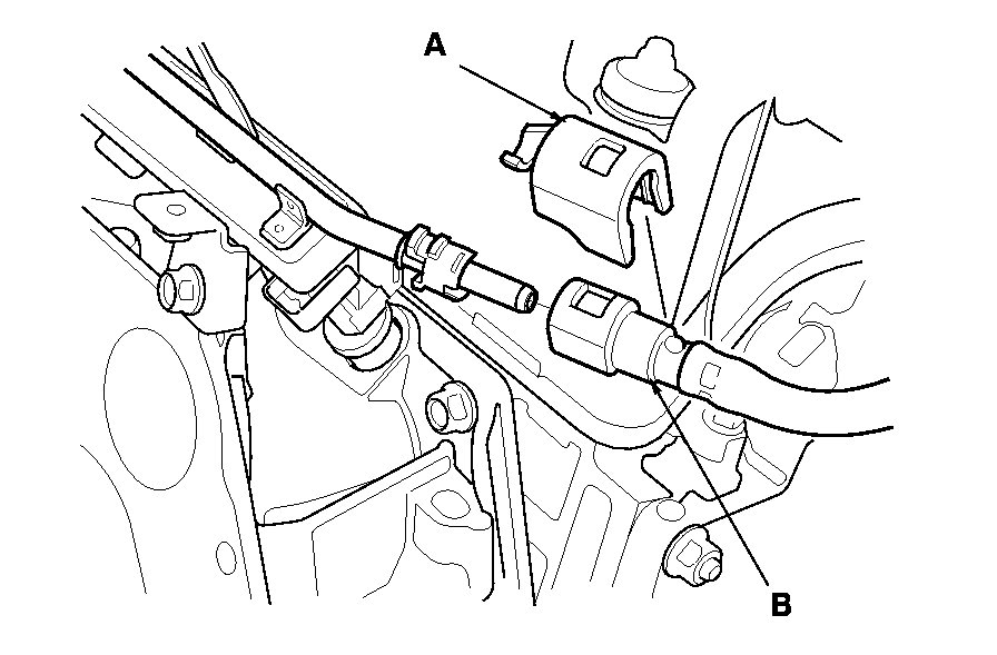

Cranks but won't start. replaced cam position sensor, crank sensor, checked spark plug to make sure they fire checked, fuel pump, all fuses. mechanic connected code reader it had read cam sensor, so he switched out. then gave up pretty much due to no more codes. hired different mechanic he changed crank sensor and and checked the rest above I stated and now he saying it might when the timing chain.
Mar 6, 2019 at 10:54 AM
  • 110,240 POSTS
If you have good spark to the plugs and the engine is getting fuel, it should run. However, if the timing is off, it may have too little of compression to run. With that, I suggest this. First, see if the engine starts for a couple seconds using starting fluid. If it starts, then you have a fuel related issue. If it doesn't start, then recheck spark to the plugs. If there is spark, then suspect low compression due to a timing issue or internal engine problem. Note that if timing is off, often times the engine sounds differently than normal when cranking it.
If you don't want to use starting fluid, here are links that show how (in general) to test all the things I suggested:
Try these tests and let me know the results. Once I know what is found, I can then tell you the most likely problem and how to repair it.
Sep 28, 2020 at 5:50 AM
HECTORM480
  • 5 POSTS
Mechanic used gasoline on a rag to test that and it still didn't start. rpm's went up to 3,000 when trying to start. he as well tested spark to plugs every plug had a spark.
HECTORM480
  • 5 POSTS
He said it has compression fuel and spark. awhile back the VSA light and engine light would go on and off then suddenly stopped and stayed off. we were told to change the VVT solenoid but never did. Do you think that can be the cause? Code was p0341. I took off the VVt and checked it on battery and it's clicking.so does that mean it's in working condition?
HECTORM480
  • 5 POSTS
If the timing chain has slack in it, does it mean it is stretched out? It jumped two teeth and is sitting on top of the teeth.
  • 110,240 POSTS
That's the problem. Either it is stretched or the tensioner is bad. The chain tensioner is actuated by oil pressure and they can go bad.
Now, this is an interference engine, meaning there isn't enough clearance between the piston and valves. If timing is off, it will (in most cases) cause internal engine damage (bent valves).
You have two choices. First, remove the head and inspect the valves for evidence of damage. Or, replace the timing chain and check engine compression.

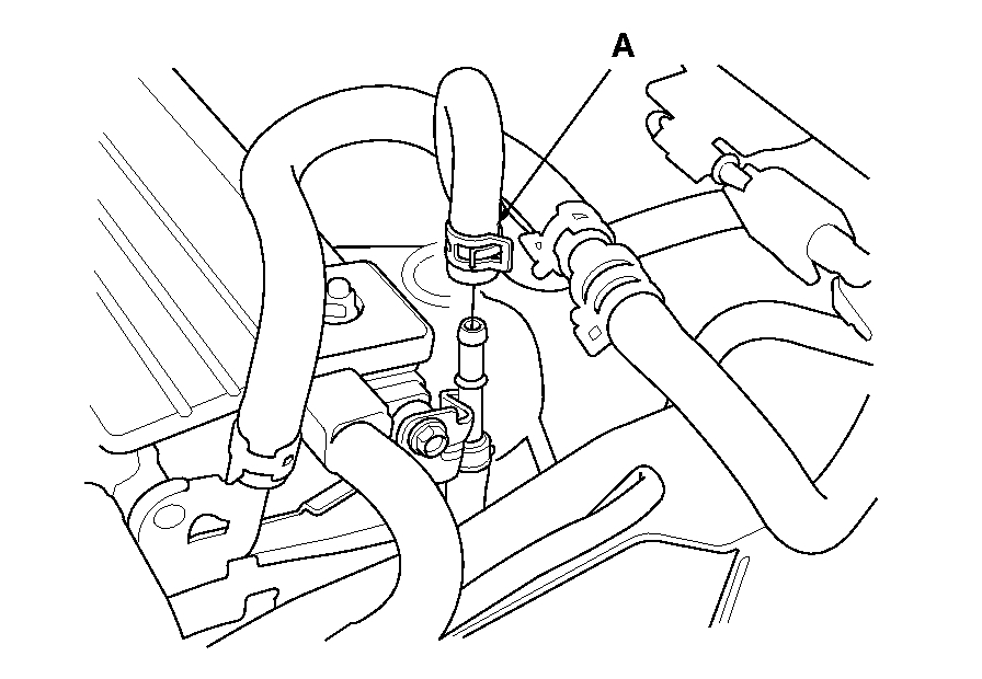

7. Disconnect the evaporative emission (EVAP) canister hose (A).
Pic 1

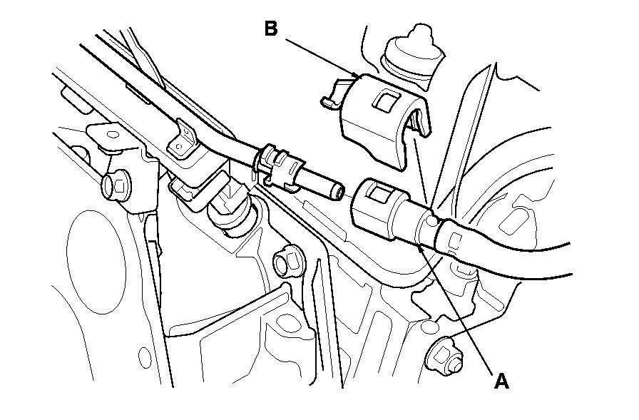

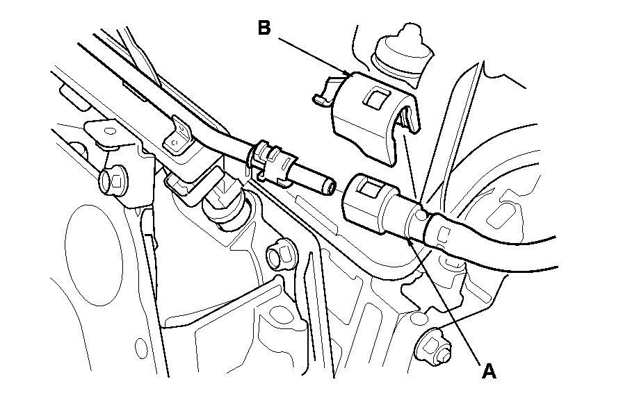

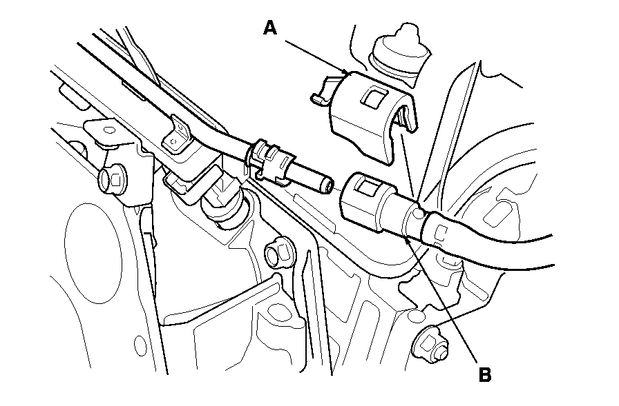

8. Remove the quick-connect fitting cover (A), then disconnect the fuel feed hose (B). See: Fuel Line Coupler > Removal and Replacement > Fuel Line/Quick-Connect Fitting Removal

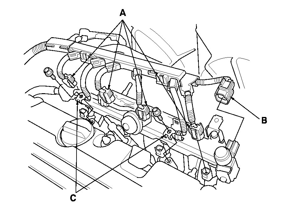

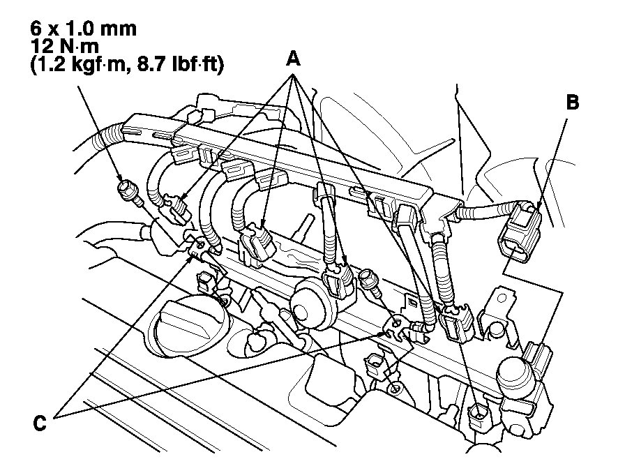

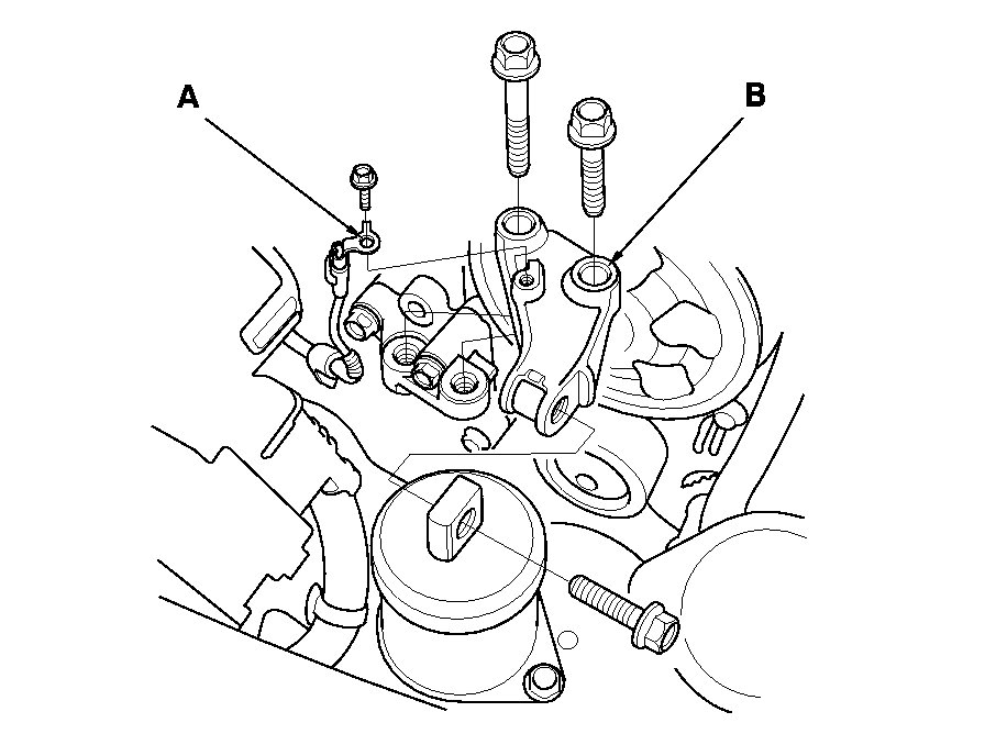

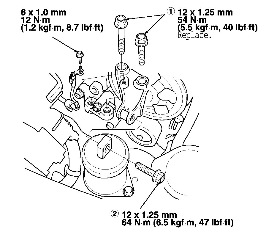

9. Disconnect the four fuel injector connectors (A), the engine mount control solenoid valve connector (B), and remove the ground cables (C).
Pic 3

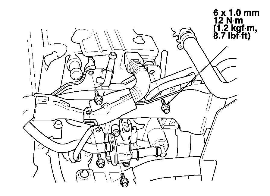

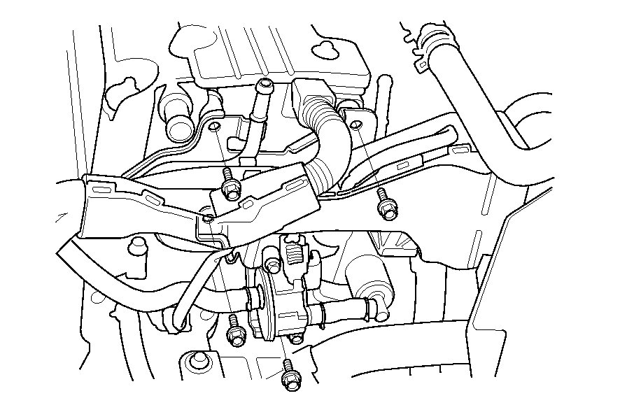

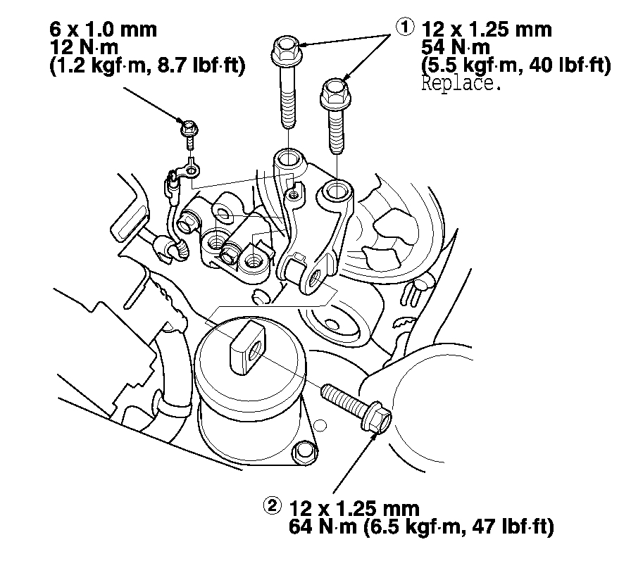

10. Remove the four bolts securing the EVAP canister purge valve bracket.
Pic 4

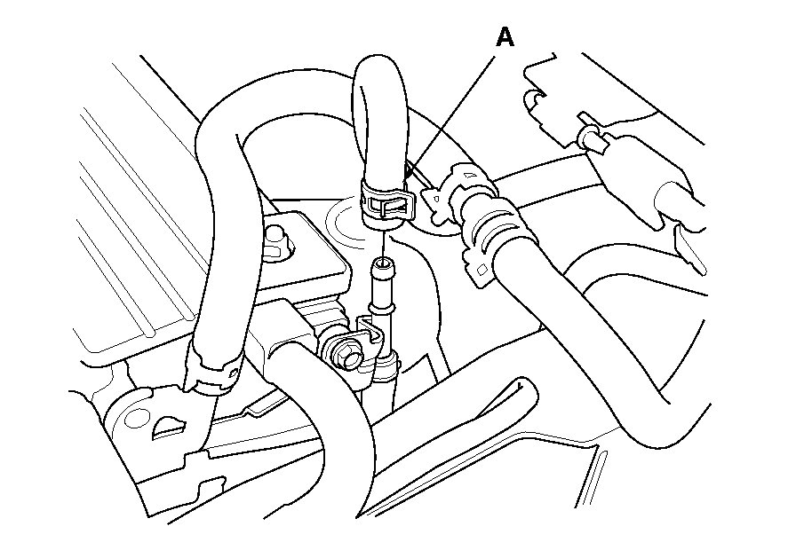

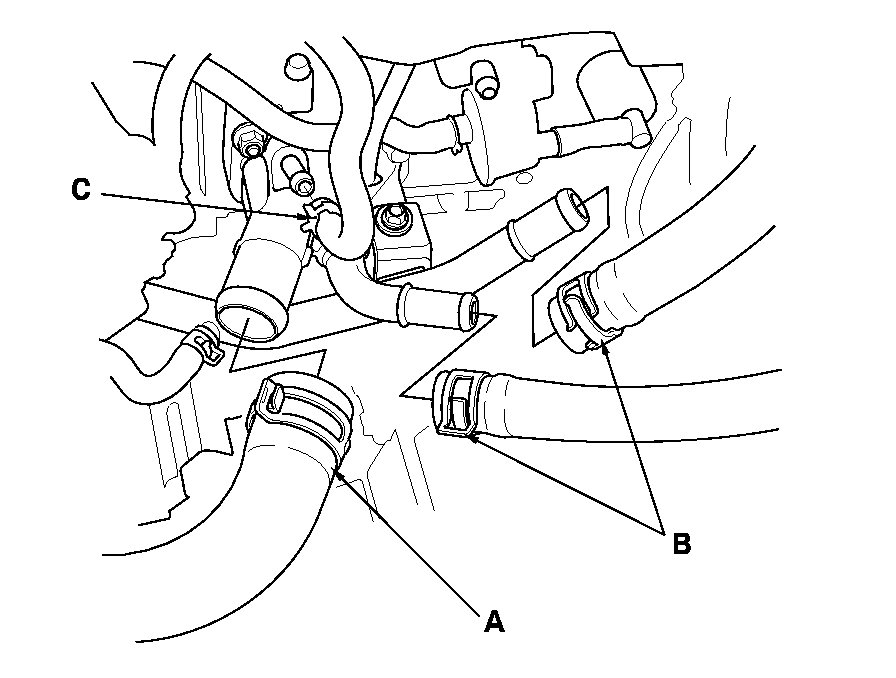

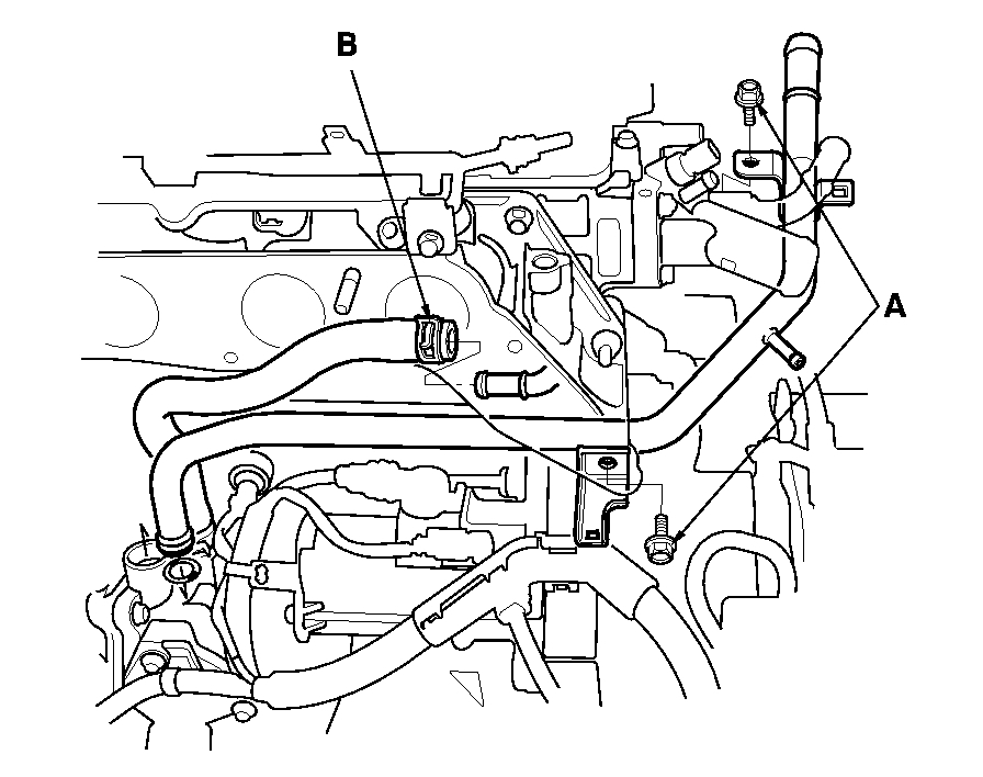

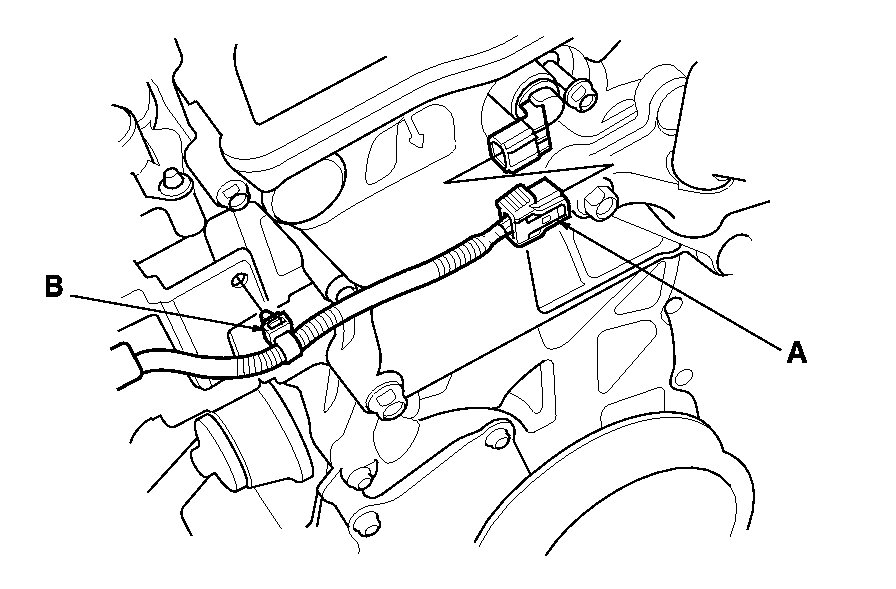

11. Disconnect the upper radiator hose (A), the heater hoses (B), and the water bypass hose (C).
Pic 5

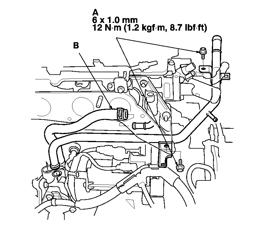

12. Remove the two bolts (A) securing the connecting pipe.
13. Disconnect the water bypass hose (B).

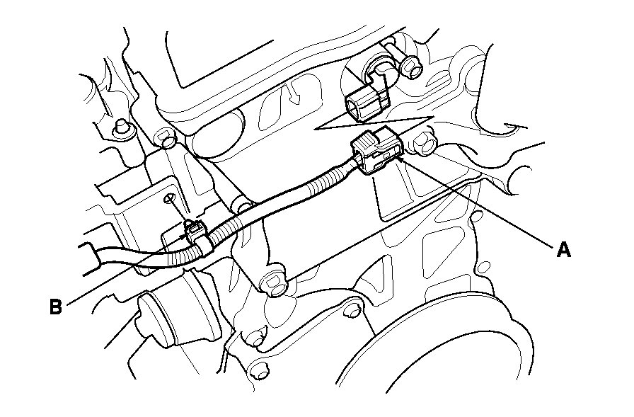

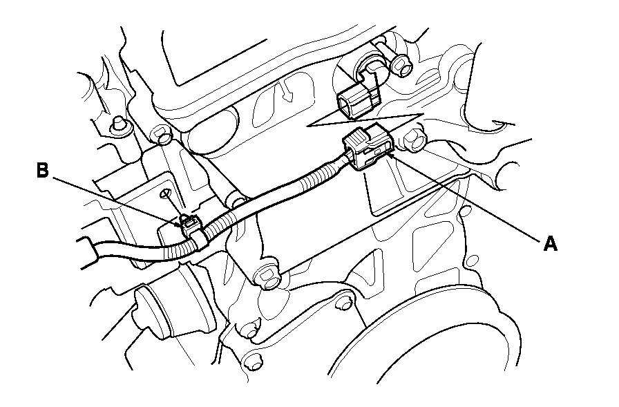

14. Disconnect the following engine wire harness connectors and wire harness clamps from the cylinder head:

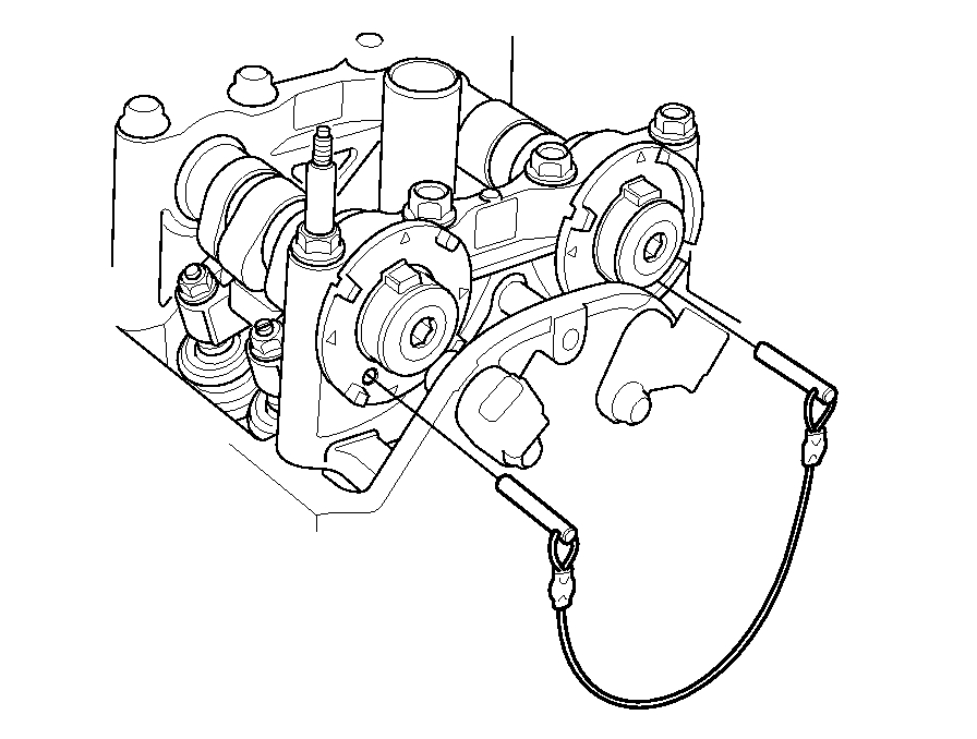

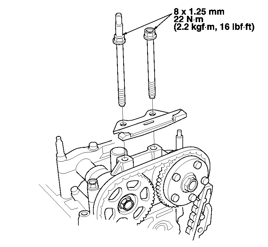

15. Remove the cam chain. See: Timing Chain > Removal and Replacement > Cam Chain Removal (PZEV Model)
16. Remove the rocker arm assembly. See: Cylinder Head Assembly > Overhaul > Rocker Arm Assembly Removal (PZEV Model)

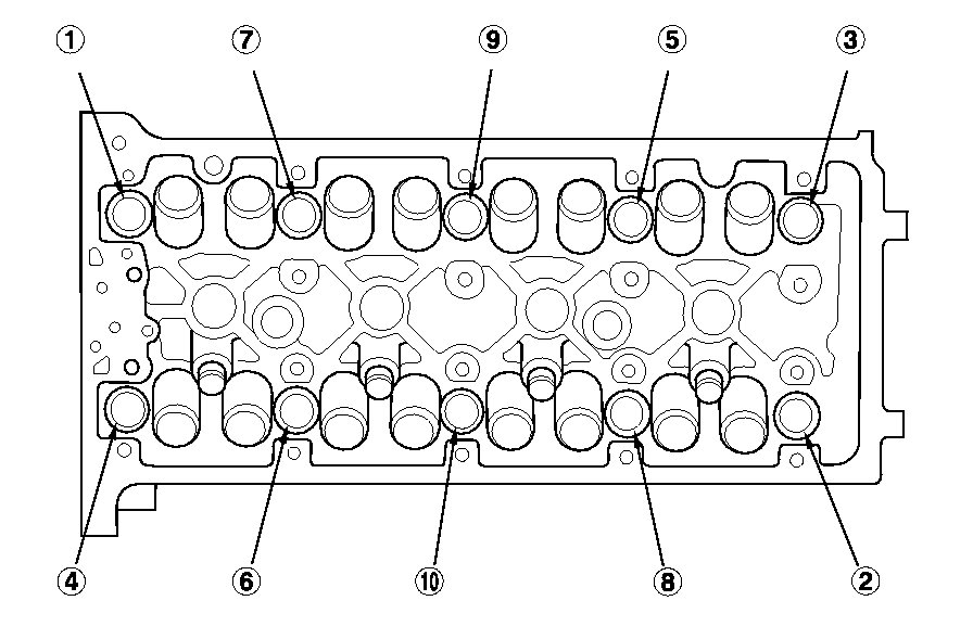

17. Remove the cylinder head bolts. To prevent warpage, loosen the bolts in sequence 1/3 turn at a time; repeat the sequence until all bolts are loosened.
18. Remove the cylinder head.

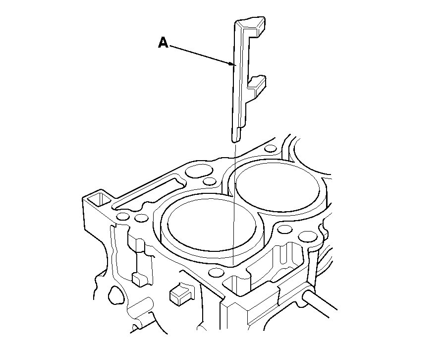

1. Install a new coolant separator (A) in the engine block whenever the engine block is replaced.
2. Clean the cylinder head and the engine block surface.
Pic 8

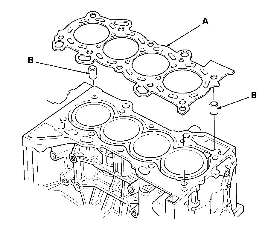

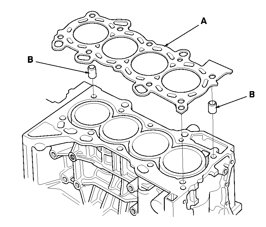

3. Install the new cylinder head gasket (A) and the dowel pins (B) on the engine block. Always use a new cylinder head gasket.

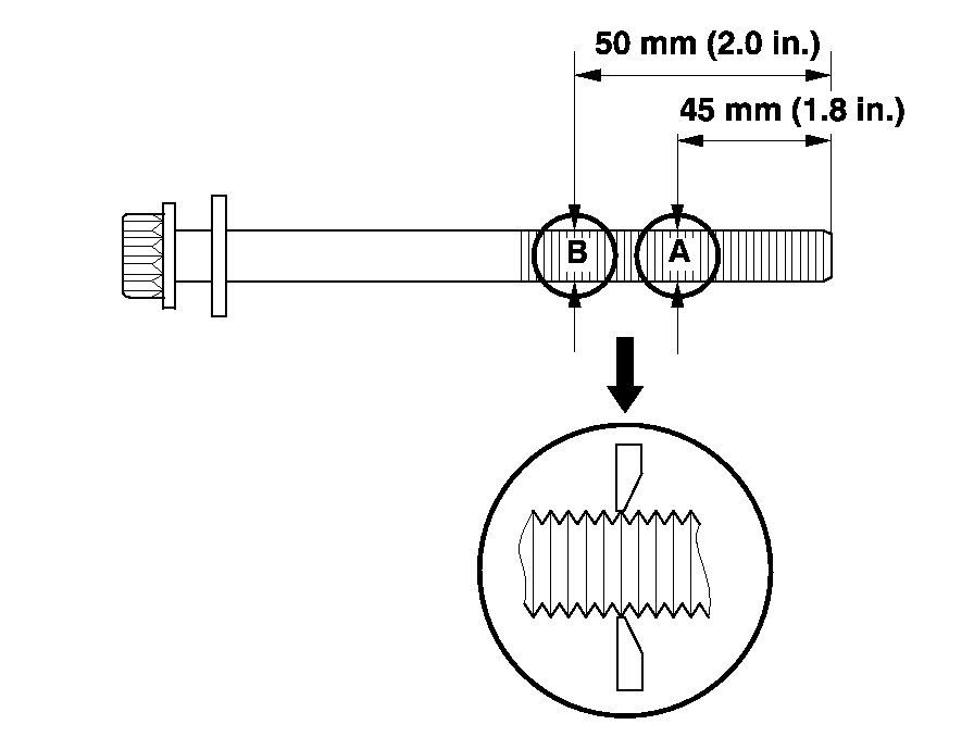

6. Measure the diameter of each cylinder head bolt at point A and point B.
7. If either diameter is less than 10.6 mm (0.42 in.), replace the cylinder head bolt.
8. Apply new engine oil to the threads and under the bolt heads of all cylinder head bolts.

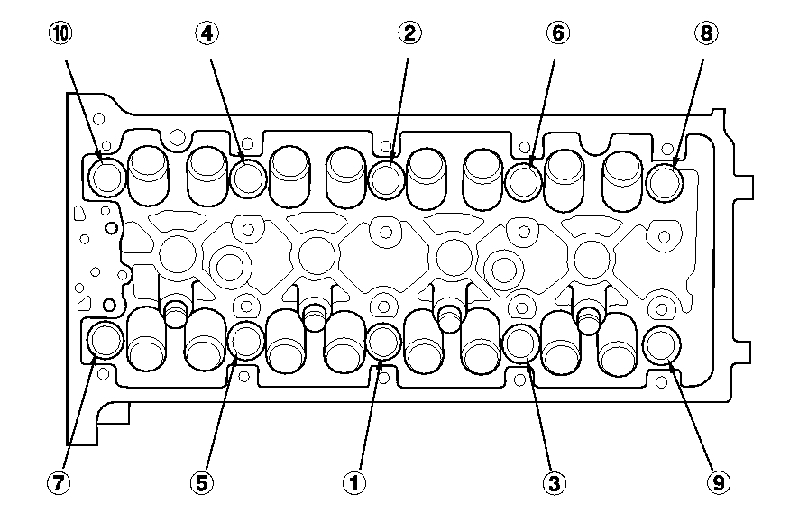

9. Tighten the cylinder head bolts in sequence to 39 N-m (4.0 kgf-m, 29 lbf-ft). Use a beam-type torque wrench. When using a preset click-type torque wrench, be sure to tighten slowly and do not overtighten. If a bolt makes any noise while you are torquing it, loosen the bolt and retighten it from the first step.
Pic 12

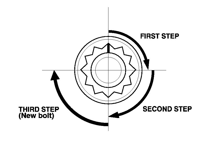

10. After torquing, tighten all cylinder head bolts in two steps (90 ° per step) using the sequence shown in step 9. If you are using a new cylinder head bolt, tighten the bolt an extra 90 °.
NOTE: Remove the cylinder head bolt if you tightened it beyond the specified angle, and go back to step 6 of the procedure. Do not loosen it back to the specified angle.

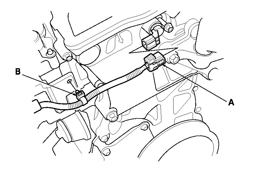

13. Connect the following engine wire harness connectors, and install the wire harness clamps to the cylinder head:
- Engine coolant temperature (ECT) sensor 1 connector
- Camshaft position (CMP) sensor A (Intake) connector
- Camshaft position (CMP) sensor B (Exhaust) connector
- Two rocker arm oil control solenoid connectors
- Two rocker arm oil pressure switch connectors
- Evaporative emission (EVAP) canister purge valve connector
- Variable valve timing control (VTC) oil control solenoid valve connector
- Engine oil pressure switch connector
Pic 13

19. Connect the fuel feed hose (A), See: Fuel Line Coupler > Removal and Replacement > Fuel Line/Quick-Connect Fitting Installation then install the quick-connect fitting cover (B).

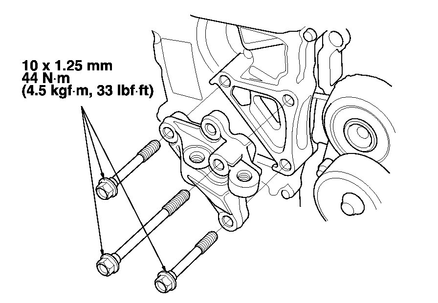

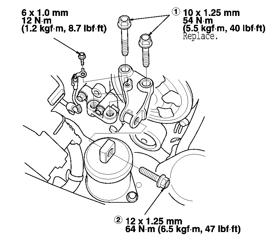

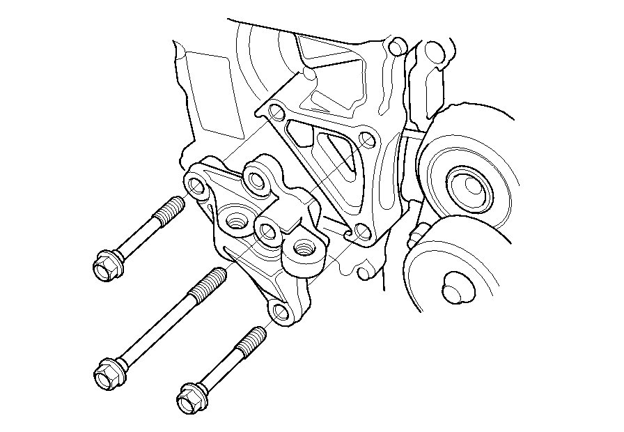

10. Remove the ground cable (A), then remove the side engine mount bracket (B).
Pic 22
11. Remove the side engine mount bracket mounting bolts.
Pic 23

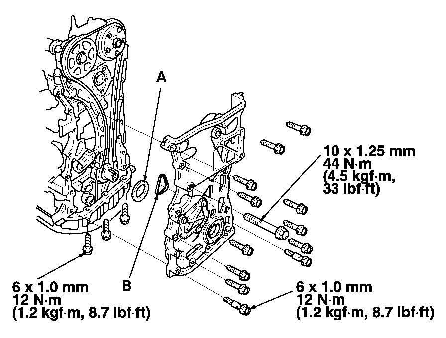

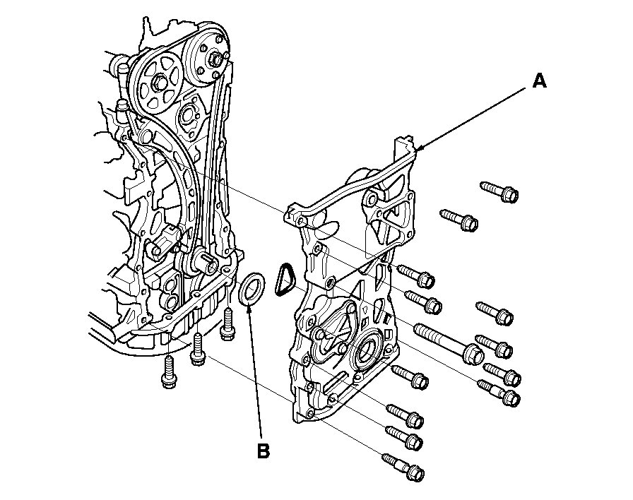

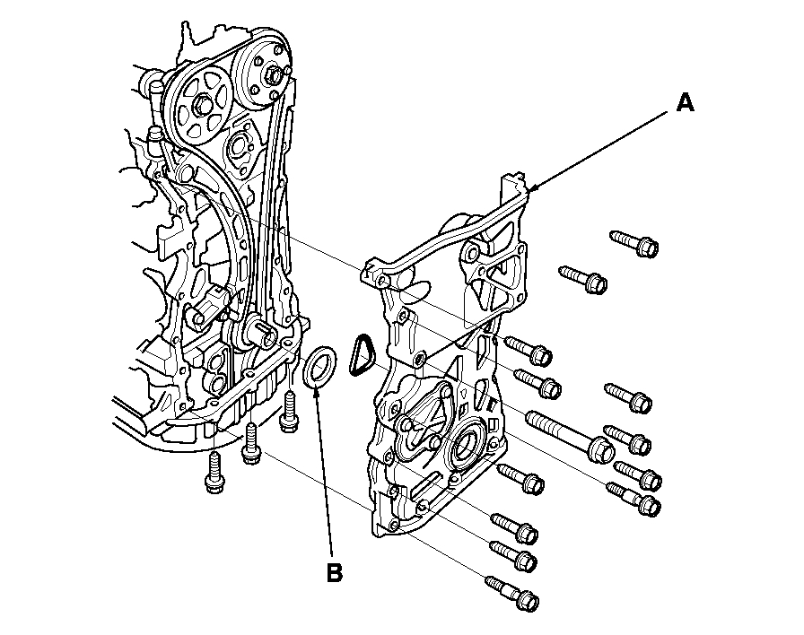

12. Remove the cam chain case (A) and spacer (B).
13. Loosely install the crankshaft pulley.
Pic 24

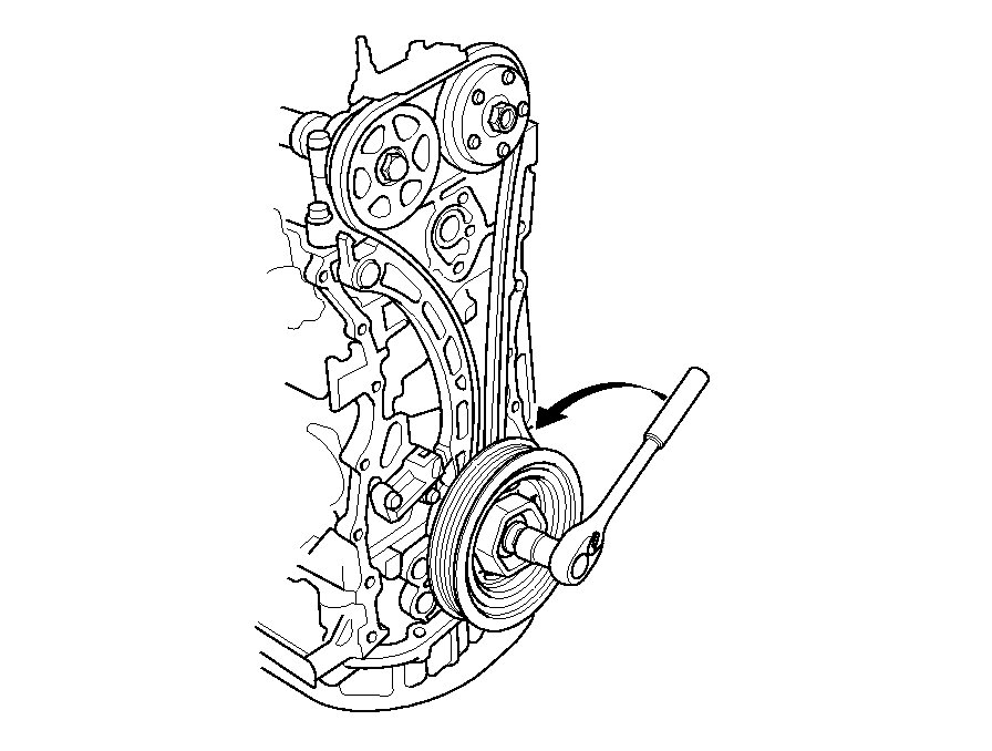

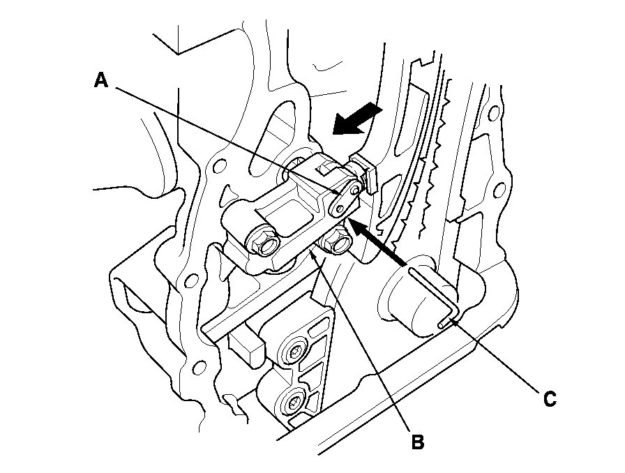

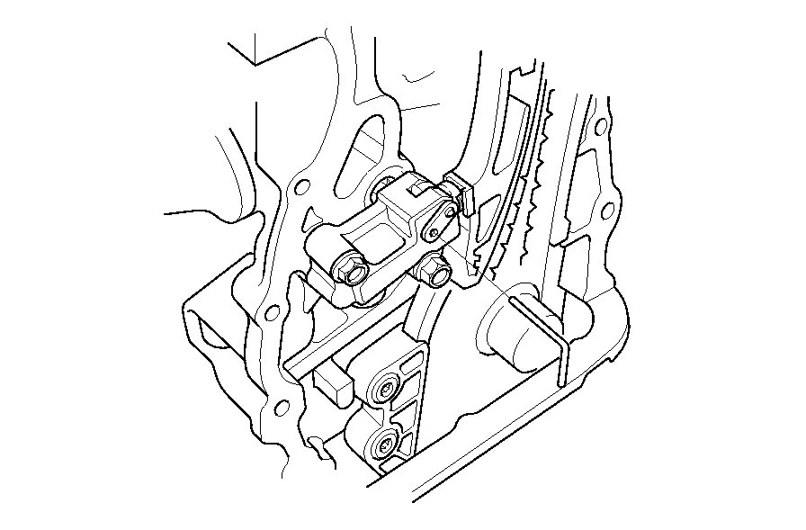

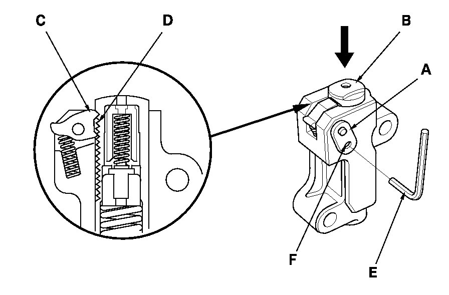

14. Turn the crankshaft counterclockwise to compress the auto-tensioner.
Pic 25

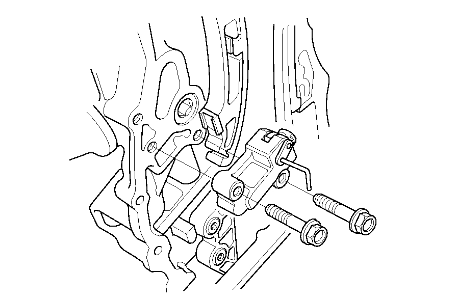

15. Align the holes on the lock (A) and the auto-tensioner (B), then insert a 1.2 mm (0.05 in.) diameter pin or lock pin (P/N 14511-PNA-003) (C) into the holes. Turn the crankshaft clockwise to secure the pin.
NOTE: Check the auto-tensioner cam position. If the position are not aligned, set the first cam to the first edge of the rack.
Pic 26
16. Remove the auto-tensioner.
Pic 27

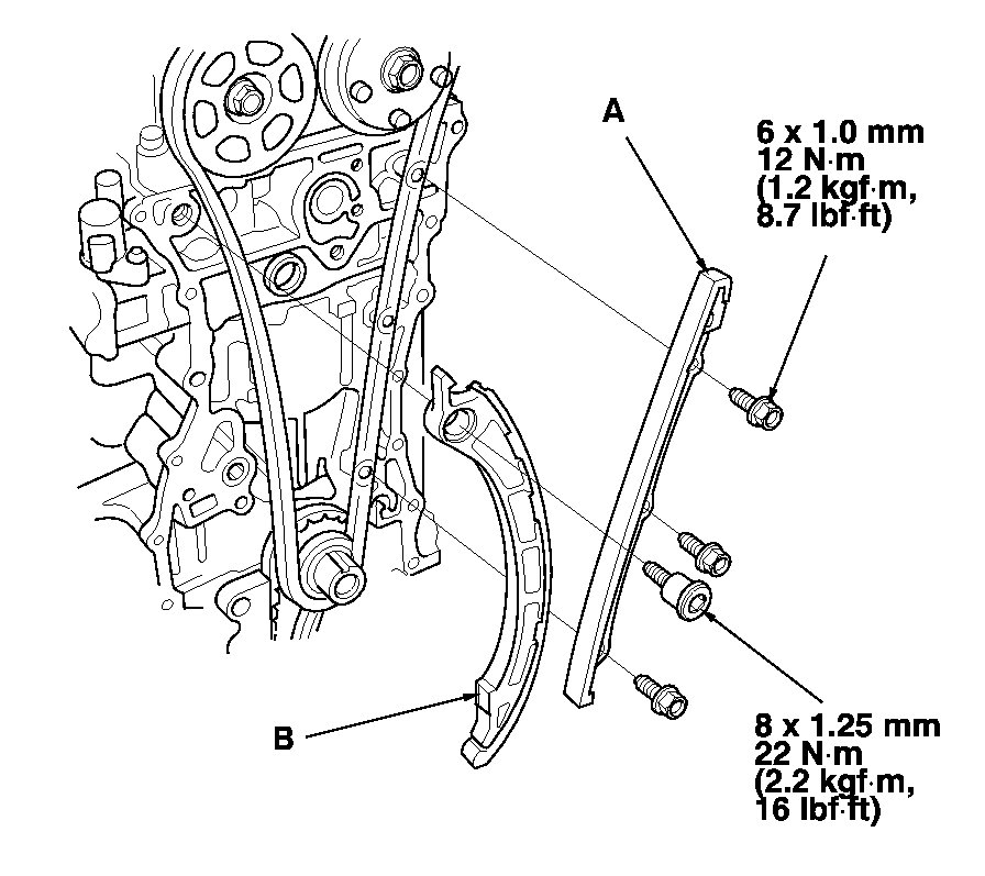

17. Remove cam chain guide B.
Pic 28
18. Remove cam chain guide A and the tensioner arm (B).
19. Remove the cam chain.
Pic 29

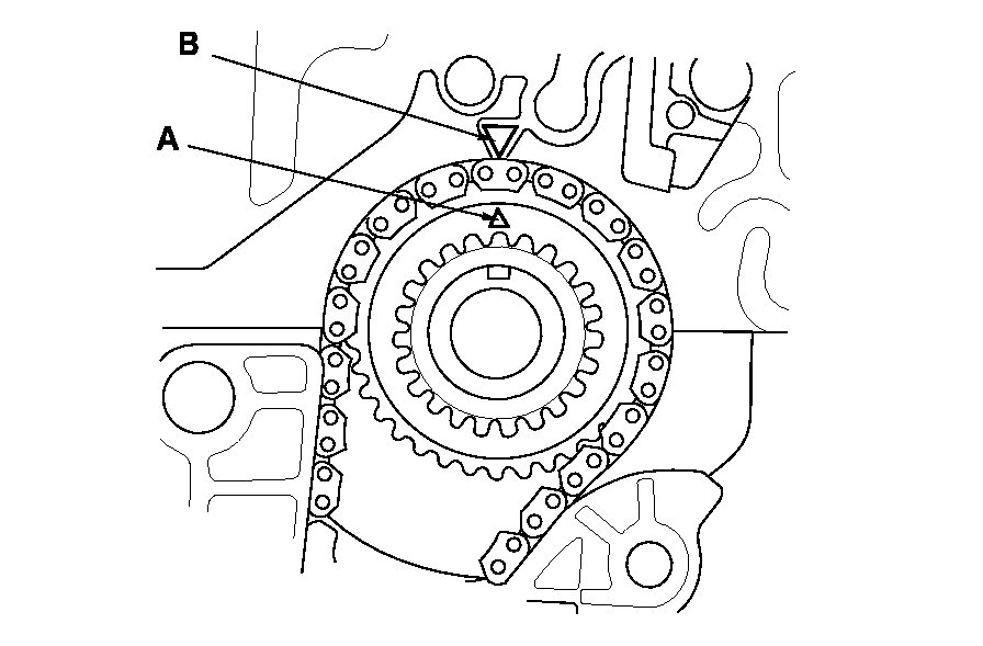

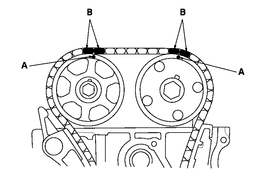

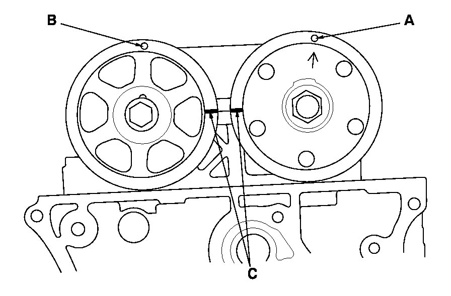

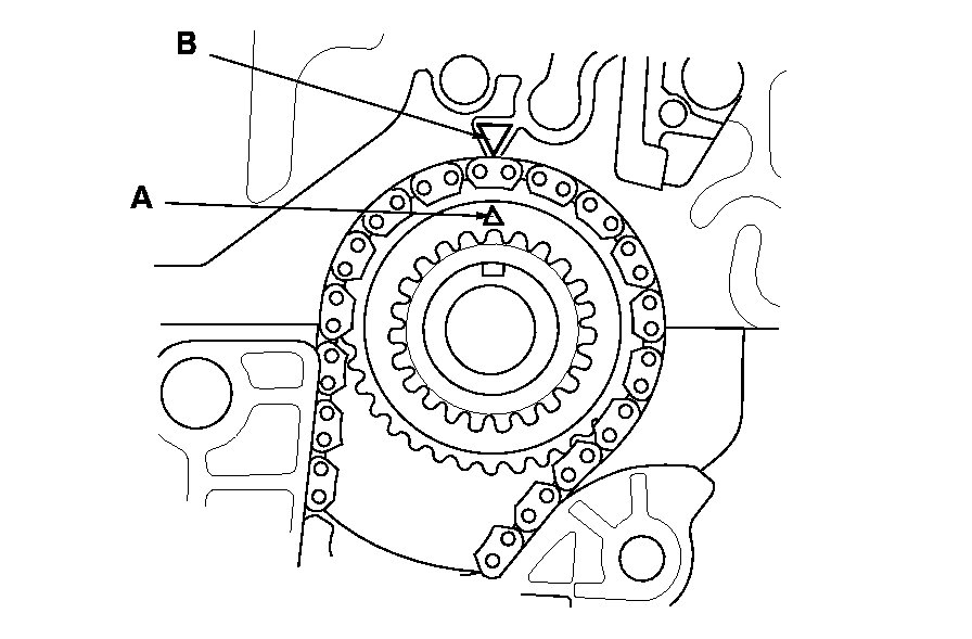

1. Set the crankshaft to top dead center (TDC). Align the TDC mark (A) on the crankshaft sprocket with the pointer (B) on the engine block.
Pic 30

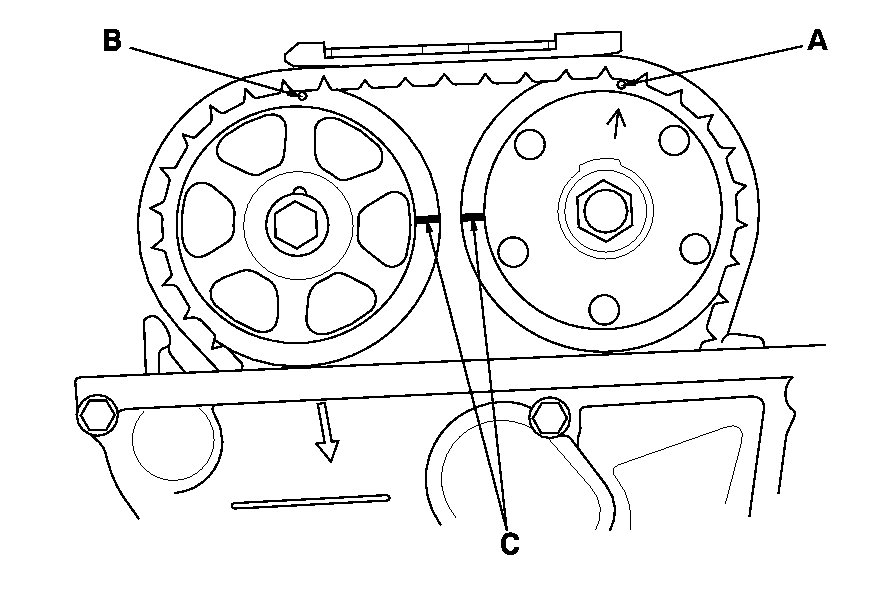

2. Set the camshafts to TDC. The punch mark (A) on the VTC actuator and the punch mark (B) on the exhaust camshaft sprocket should be at the top. Align the TDC marks (C) on the VTC actuator and the exhaust camshaft sprocket.
Pic 31

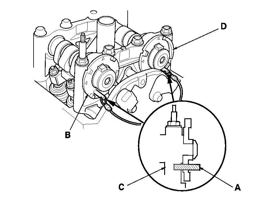

3. To hold the intake camshaft, insert a camshaft lock pin (P/N 07AAB-RWCA120) (A) into the maintenance hole in camshaft position (CMP) pulse plate A (B) and through the No. 5 rocker shaft holder (C).
4. To hold the exhaust camshaft, insert a camshaft lock pin (A) into the maintenance hole in CMP pulse plate B (D) and through the No. 5 rocker shaft holder (C).
Pic 32

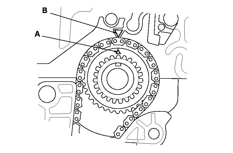

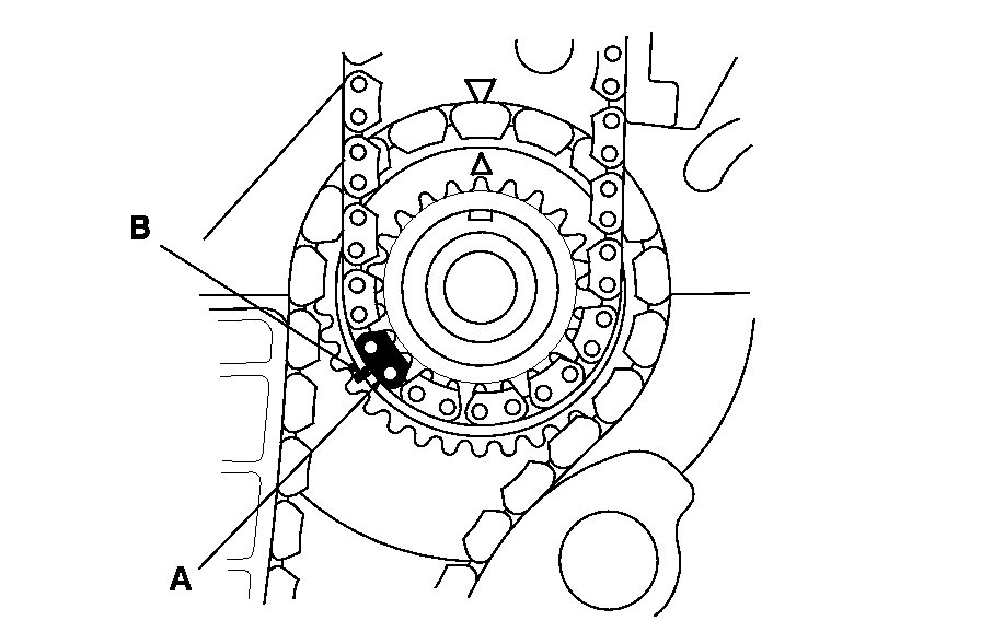

5. Install the cam chain on the crankshaft sprocket with the colored link plate (A) aligned with the mark (B) on the crankshaft sprocket.
Pic 33
6. Install the cam chain on the VTC actuator and the exhaust camshaft sprocket with the punch marks (A) aligned with the center of the two colored link plates (B).
Pic 34

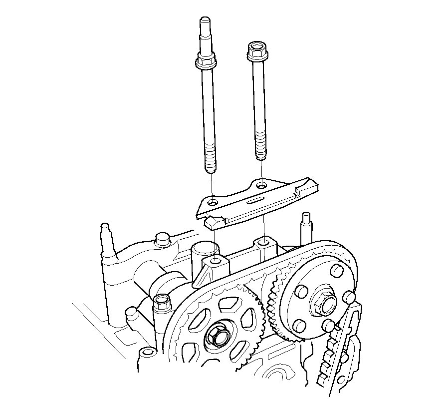

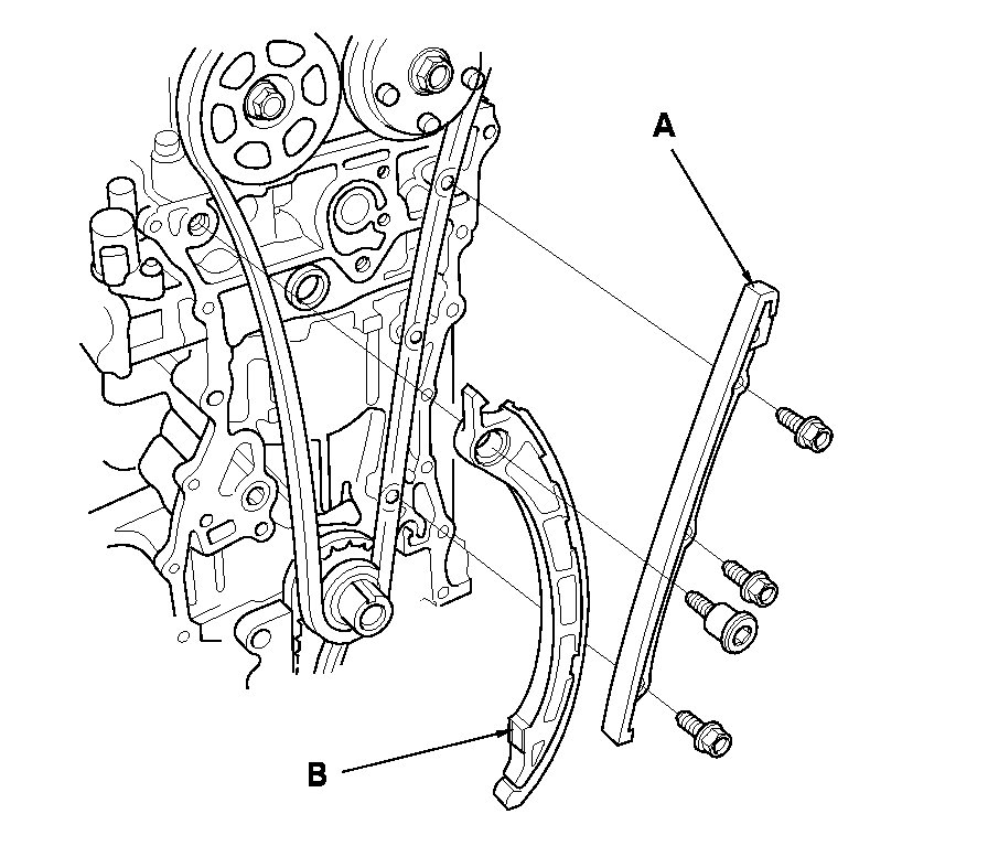

7. Install cam chain guide A and the tensioner arm (B).
Pic 35

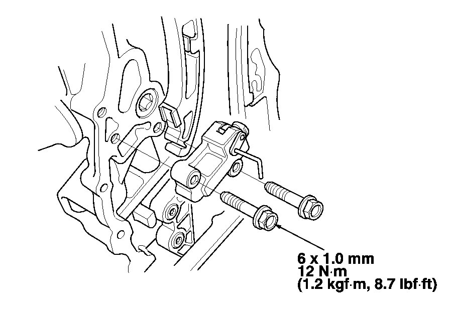

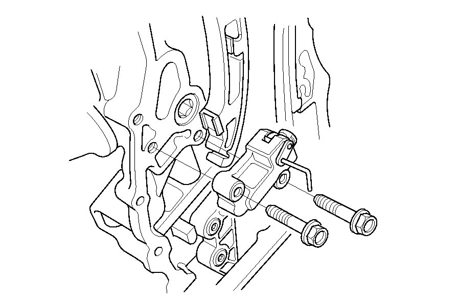

8. Compress the auto-tensioner when replacing the cam chain. Remove the pin from the auto-tensioner. Turn the plate (A) counterclockwise, to release the lock, then press the rod (B), and set the first cam (C) to the first edge of the rack (D). Insert the 1.2 mm (0.05 in.) diameter pin or lock pin (P/N 14511-PNA-003) (E) into the holes (F).
NOTE: If the chain tensioner is not set up as described, the tensioner will become damaged.
Pic 36
9. Install cam chain guide B.
Pic 37
10. Install the auto-tensioner.
Pic 38

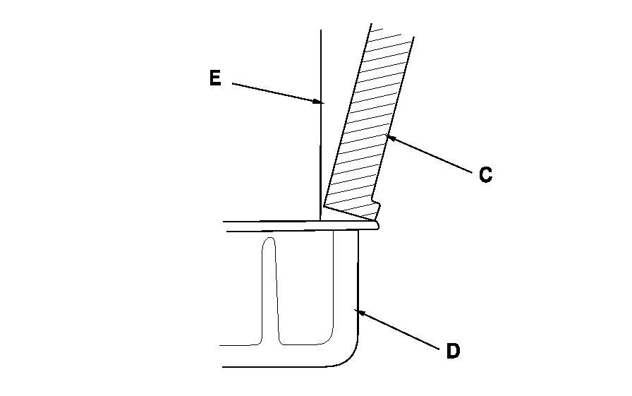

13. Check the chain case oil seal for damage. If the oil seal is damaged, replace the chain case oil seal. See: Front Crankshaft Seal > Removal and Replacement > Cam Chain Case Oil Seal Installation (PZEV Model)

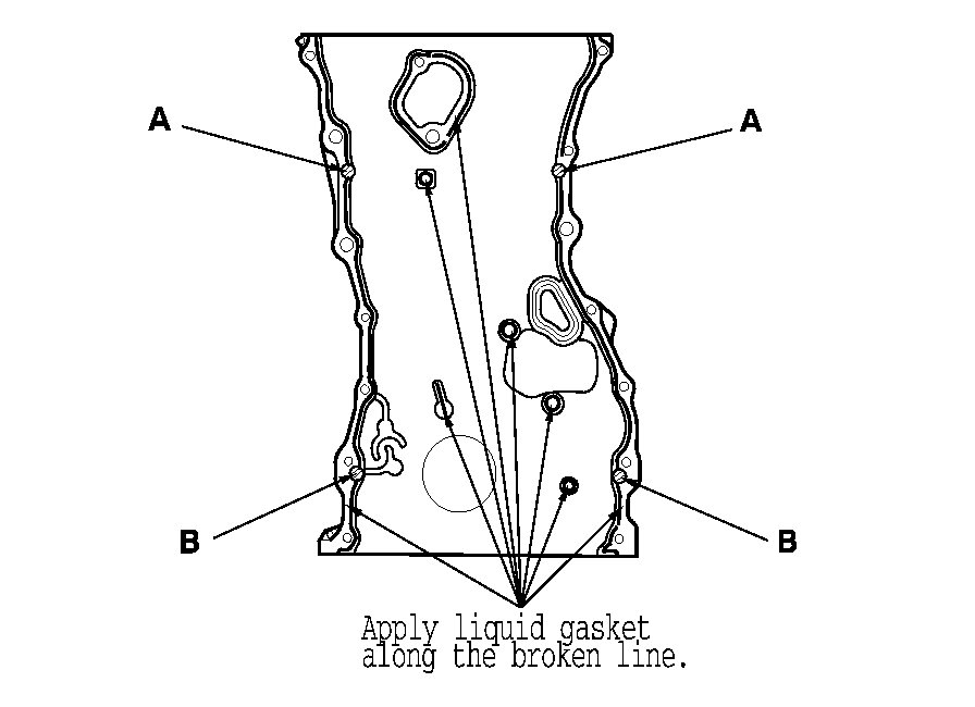

14. Remove the old liquid gasket from the chain case mating surfaces, the bolts, and the bolt holes.
15. Clean and dry the chain case mating surfaces.
Pic 40

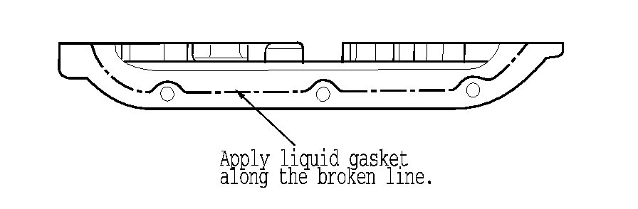

16. Apply liquid gasket, P/N 08717-0004, 08718-0001, 08718-0003, or 08718-0009, evenly to the engine block mating surface of the chain case, and to the inside edge of the threaded bolt holes. Install the component within 5 minutes of applying the liquid gasket.
NOTE:
- If you apply liquid gasket P/N 08718-0012, the component must be installed within 4 minutes.
- If too much time has passed after applying the liquid gasket, remove the old liquid gasket and residue, then reapply new liquid gasket.
17. Apply liquid gasket to the engine block upper surface contact areas (A) on the chain case and lower block upper surface contact areas (B) on the chain case.

18. Apply liquid gasket, P/N 08717-0004, 08718-0001, 08718-0003, or 08718-0009, evenly to the oil pan mating surface of the chain case, and to the inside edge of the threaded bolt holes. Install the component within 5 minutes of applying the liquid gasket.
NOTE:

19. Install the spacer (A), then install the new O-ring (B) on the chain case. Set the edge of the chain case (C) to the edge of the oil pan (D), then install the chain case on the engine block (E). Wipe off the excess liquid gasket on the oil pan and chain case mating surface.
NOTE:
- When installing the chain case, do not slide the bottom surface onto the oil pan mounting surface.
- Wait at least 30 minutes before filling the engine with oil.
- Do not run the engine for at least 3 hours after installing the chain case.

20. Install the side engine mount bracket, then tighten the side engine mount bracket mounting bolts.
Pic 45
21. Tighten the new side engine mount bracket mounting bolts in the numbered sequence shown.
22. Install the ground cable.
23. Remove the jack and the wood block.
Pic 48
Pic 49
3. To hold the intake camshaft, insert a camshaft lock pin (07AAB-RWCA120) (A) into the maintenance hole in camshaft position (CMP) pulse plate A (B) and through the No. 5 rocker shaft holder (C).
Pic 50
Pic 51
Pic 54
Pic 55
NOTE: Check the auto-tensioner cam position. If the position is not aligned, set the first cam to the first edge of the rack.
Pic 56
NOTE:
Pic 63
