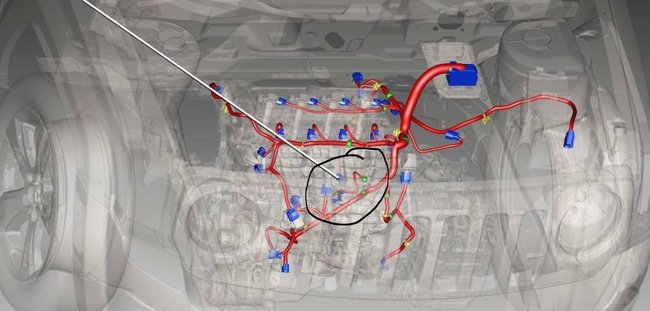

I’m trying to find the location of the crankshaft position sensor. If you can show me a diagram of its location I would really appreciate it.

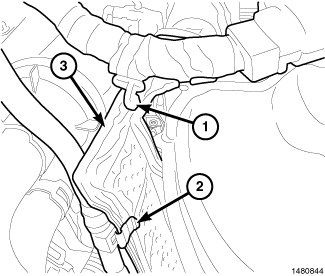

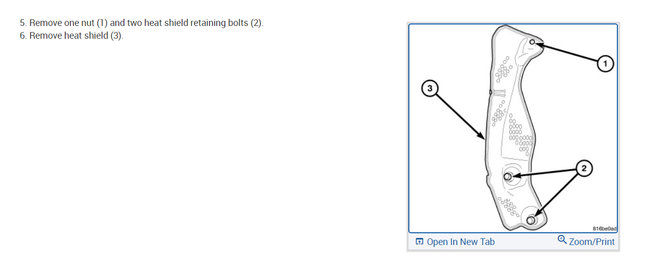

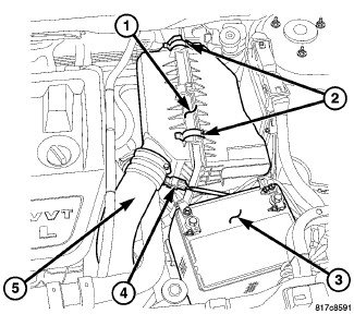

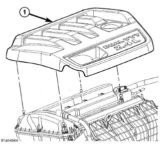

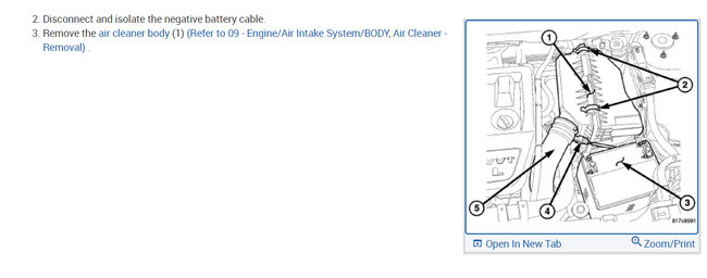

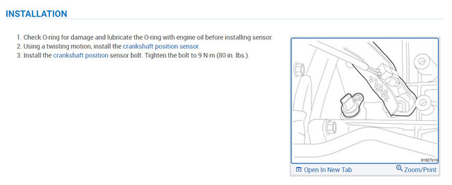

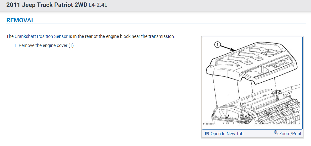

Picture 1 below shows in general its location. I also included the directions for removal and replacement. It is easier to see location that way. The attached pictures correlate with the directions. Check out the diagrams (Below). Please let us know if you need anything else to get the problem fixed.
2010 Jeep Truck Patriot 2WD L4-2.0L
Crankshaft Position Sensor - Removal
CRANKSHAFT POSITION SENSOR - REMOVAL

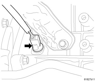

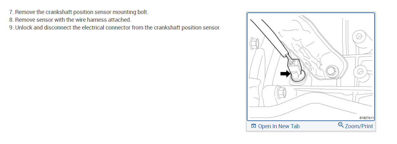

The Crankshaft Position Sensor is in the rear of the engine block near the transmission.

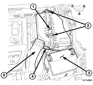

1. Remove the engine cover (1).
2. Disconnect and isolate the negative battery cable.
3. Remove the air cleaner body (1) See: Air Cleaner Housing > Removal and Replacement > Air Cleaner Body - Removal.

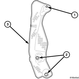

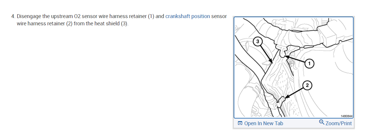

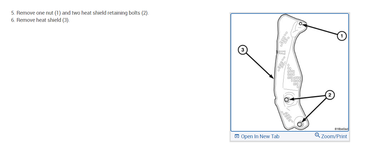

4. Disengage the upstream O2 sensor wire harness retainer (1) and crankshaft position sensor wire harness retainer (2) from the heat shield (3).
5. Remove one nut (1) and two heat shield retaining bolts (2).
6. Remove heat shield (3).

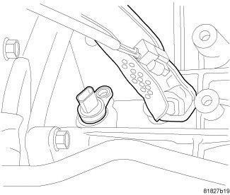

7. Remove the crankshaft position sensor mounting bolt.
8. Remove sensor with the wire harness attached.
9. Unlock and disconnect the electrical connector from the crankshaft position sensor.
INSTALLATION
1. Check O-ring for damage and lubricate the O-ring with engine oil before installing sensor.
2. Using a twisting motion, install the crankshaft position sensor.
3. Install the crankshaft position sensor bolt. Tighten the bolt to 9 Nm (80 in. lbs.).
