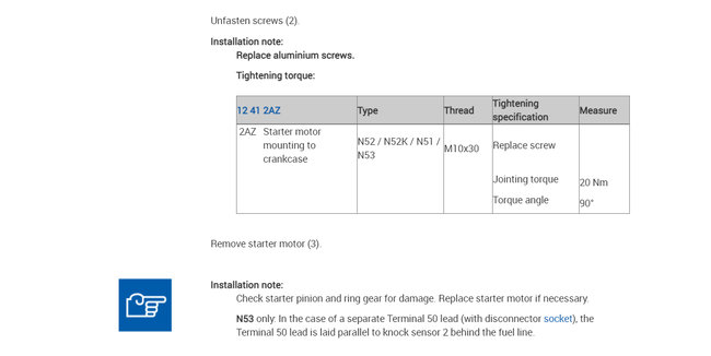

I have the car listed above SI Xdrive, when I push the button to crank it all the instrument panel lights come on as well as the A/C headlights etc. But before it actually cranks, I hear one click under the hood and then nothing. The lights and everything will stay on like in the accessory position, but it won't start.
Aug 7, 2022 at 3:53 PM
  • 55,412 POSTS

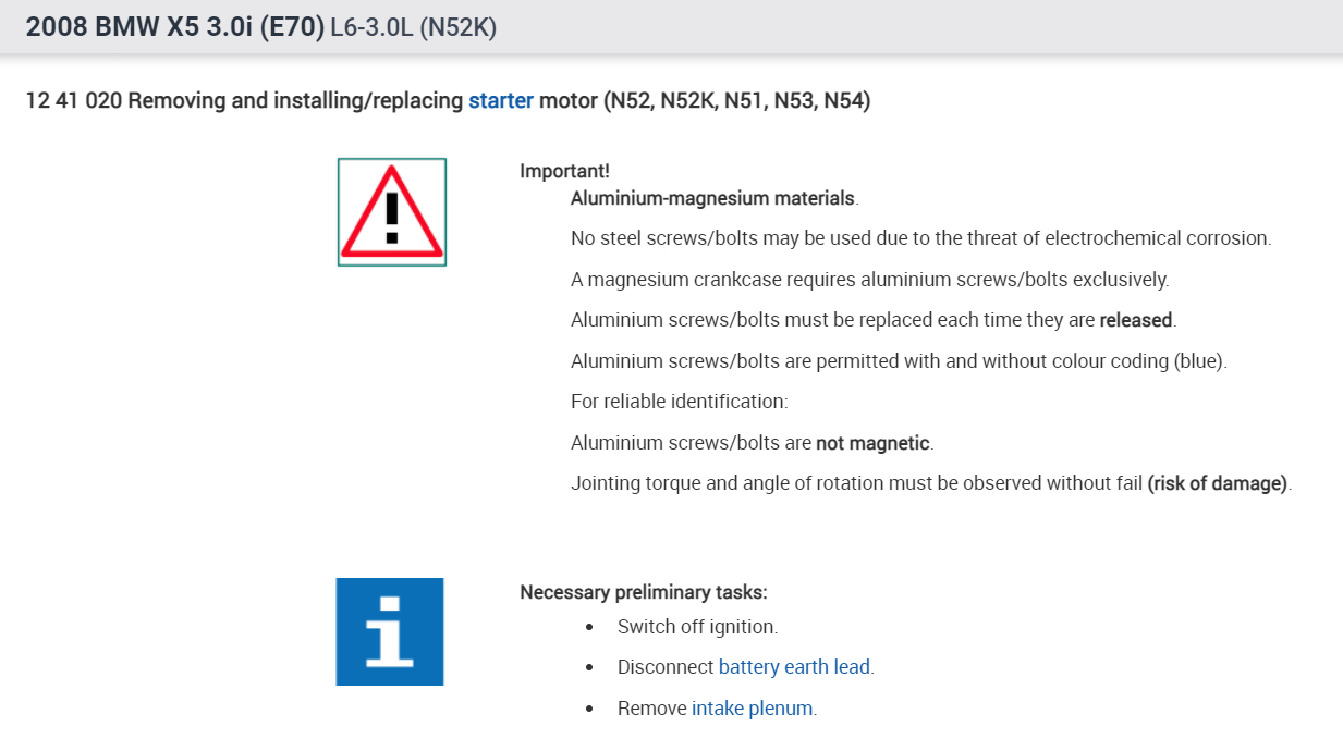

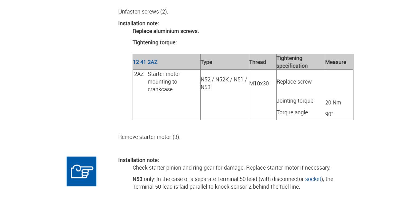

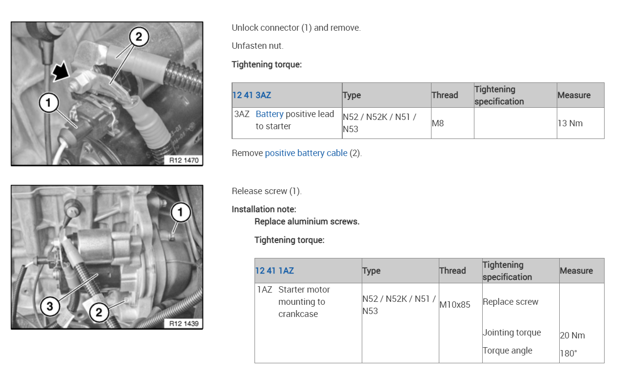

This is common when the starter motor goes out. To be sure we need to test the trigger wire of the starter which this guide can help you with. Included is the location of the starter and how to change it out in case you need it.
Check out the diagrams (below). Please let us know what you find.
