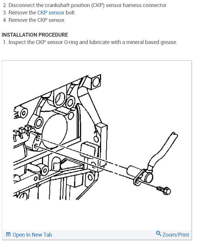

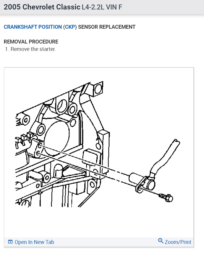

Thanks! we like it too, yes, the crankshaft sensor could affect the spark and RPM and lave no codes, here is the location of the sensor, you might have a defective part. Also, I would use the starting fluid to see if the problem is ignition or fuel related. This guide can help:
https://www.2carpros.com/articles/car-not-running-advanced
to check for spark video.
https://youtu.be/baq_aEWNQ0Y
There is no camshaft sensor, you are correct about that. Check out the images (below). Please let us know what happens.
