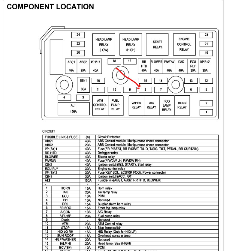

Ignition locked up on me. Car sat for over a year. Finally got around to replacing the ignition switch, lock cylinder, the whole ignition set up is new. Paid locksmith to come out and program the key. Still won't start. Fuel pump isn't coming on. All fuses, relays etc., have been checked. All good. I don't know what the issue is but I'm so fed up I'm ready to either sell it or haul it to the scrapyard. I'd do not want to have to do that because I love the car and when the ignition locked up the car didn't even have a check engine light on. It was in perfect running condition. Please someone help!

Will the engine run on starting fluid? If so, let's check for power at fuse for the fuel pump (f/pump) which is under the hood inside the fuse panel.
This guide can help, Check out the images (below). Please let us know what you find.

No, won't run on starter fluid.
