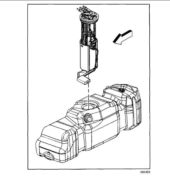

My truck is not starting. I replaced the alternator, belt, camshaft position sensor, spark plugs, distributor.so I checked the fuel pump and got a spark plug tester both are good. when you stop at a stop sign it would shut off or when you put it in gear it will just shut off. and Friday I was going up a hill and it shut off and now I have a crank but no start.

1. Fuel pump. You need to test the actual pressure. Low pressure would cause all these issues.
2. Spark. Check and see if the tachometer moves up a little while cranking to see if the crank sensor is sending a signal to the PCM.
3. Compression. I would check the compression as well.
Is the check engine light on or was it on when it was running?

The check engine light was on. I reset the computer to rule out a fail-safe. I also have checked the fuel pressure and it was good.
Dec 4, 2019 at 11:38 PM
Okay, what was the code? You should never reset a code without investigating why it was set.
What was the pressure?
What about spark and compression?
Dec 4, 2019 at 11:45 PM
NICK123456#
before I reset the codes I had 5 codes (p0404, p0405, p1345, p0300, p0341). when I did the pressure test it was around 50 psi. I got a spark plug tester and it light up when I tried to start it. I have not done a compression test yet.
Dec 4, 2019 at 11:53 PM
Okay, the fuel pressure is no good. It should be 60-66 lbs. I would start by replacing the fuel pump.
https://www.2carpros.com/articles/how-to-replace-an-electric-fuel-pump
When you order it, tell them the 8th digit of the VIN number. Otherwise, you could get the wrong one and it will not start.
