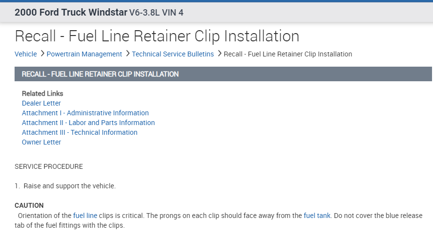

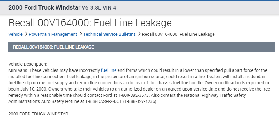

Has spark but no gas pressure. Looked under the van and saw a fuel leak about under the driver's seat. Will not be able to get under the van until tomorrow. It appears there is a joint in that location that was subject to a recall. I do not know if the recall was ever performed.

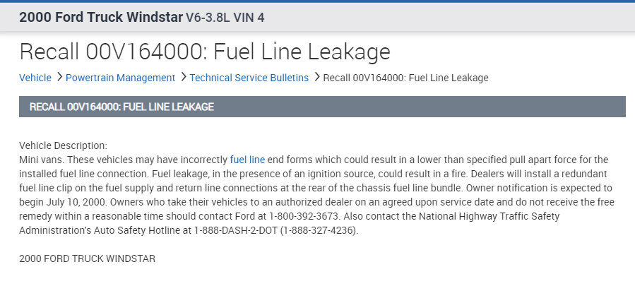

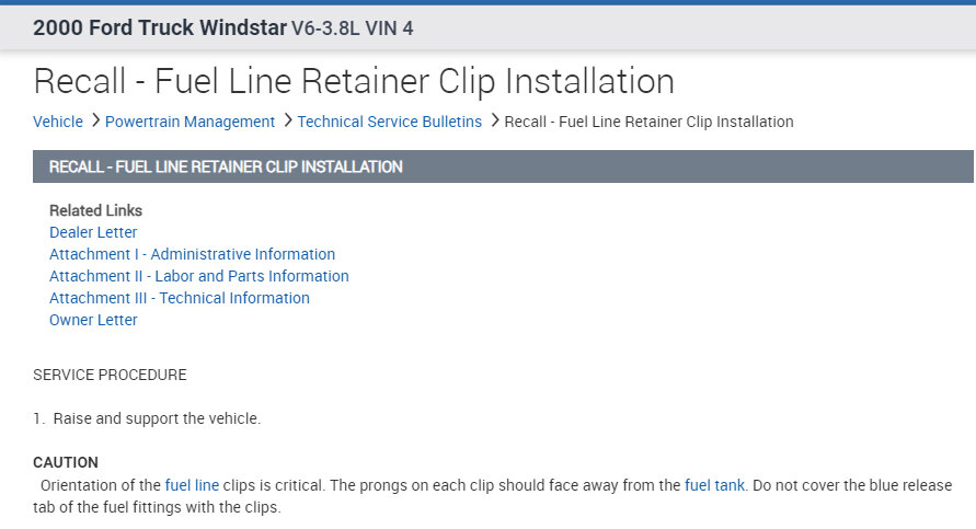

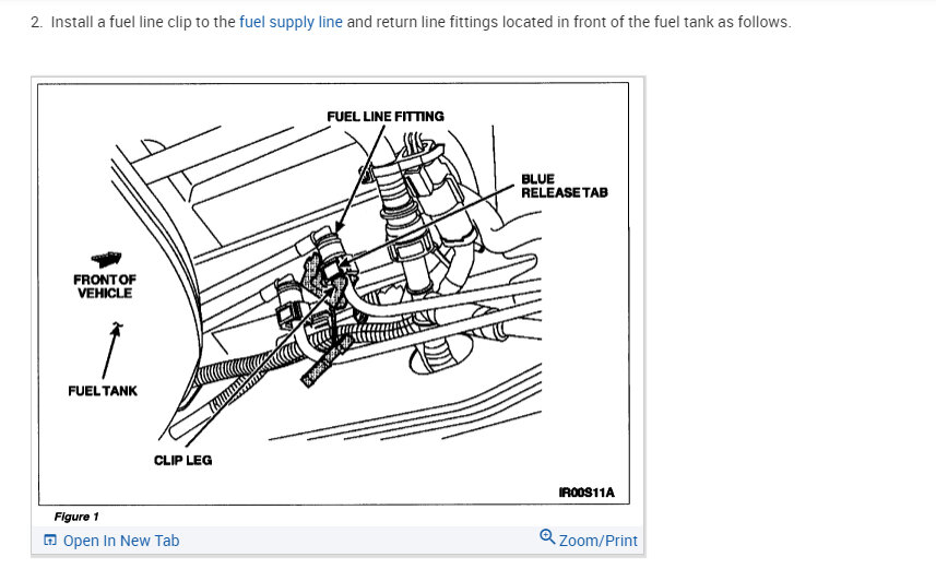

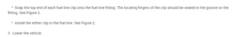

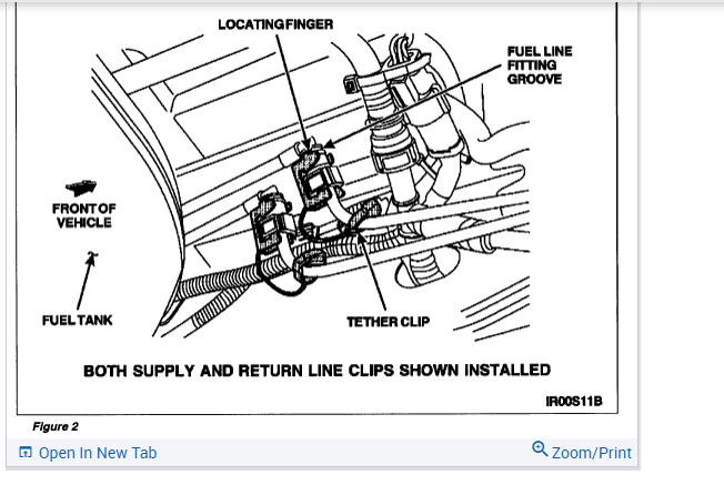

If you contact a Ford dealership, they should be able to tell you if the recall was done. You will need to provide the VIN number for them.
I did a little research for you and found there are actually two recalls related to the fuel line. One is for a retainer clip and the other is for a leak. I attached them below for you.

I found the fuel line separated at the joint just forward of the fuel tank. There were no clips on either joint. Reattached the joint and inserted the clips. The van then started with no problems. I went to the dealership to check on the recall and they have no record of those recalls on that model. I gave them the numbers and they denied any knowledge of the recalls. Oh well, it's running now. Thank you for your assistance and I will give some money to your gofund me page later this week.
