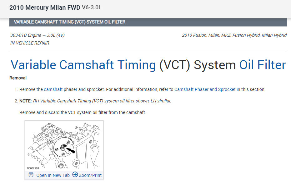

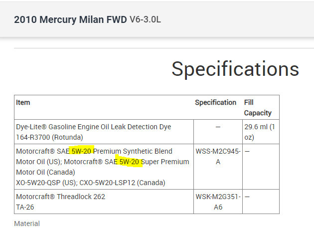

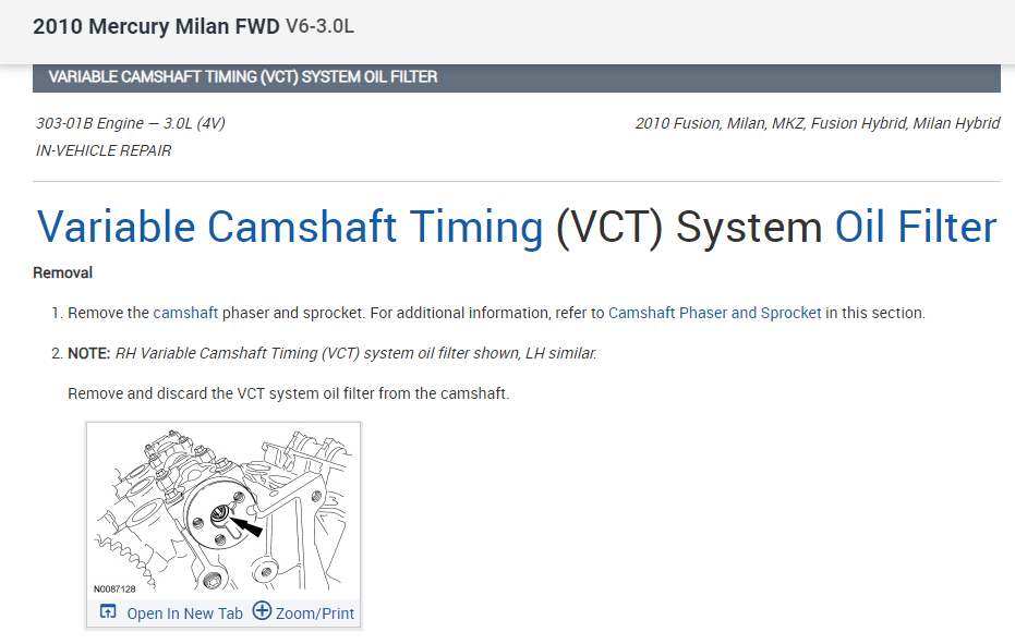

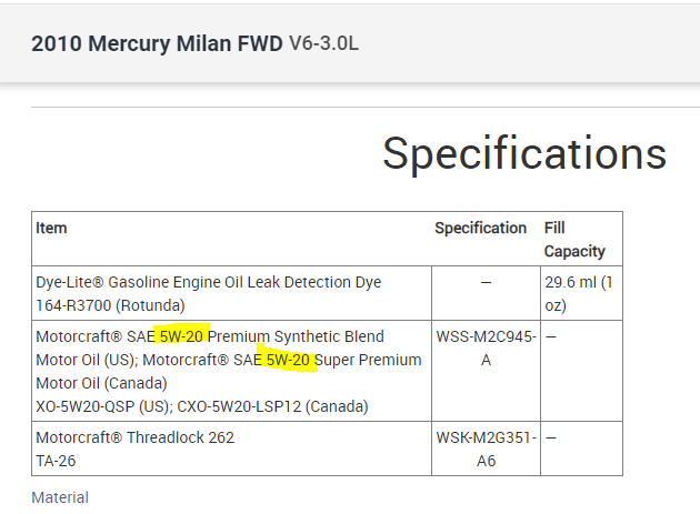

What weight was used in the vehicle? As far as the coil, that is an easy fix. The P0012 and P0022 are timing related issues. At 100,000 miles, there shouldn't be an issue with the timing chain. However, I suspect it may need replaced. Keep in mind, there are other things that can cause this to happen. For example, the vehicle has camshaft position sensors that can be causing it.

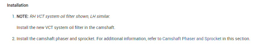

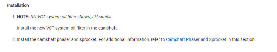

Additionally, the vehicle has what is called variable valve timing. This is controlled by oil pressure. There is a filter/screen that can be replaced if plugged. And yes, that can cause the codes. I attached a pic below showing the location of the filter.

Let me know your thoughts and questions. Also, let me know what weight oil was used. The vehicle requires 5w20. (pic 1 below)
See pic below. The pics are the directions for replacing the filter.
