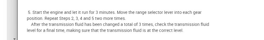

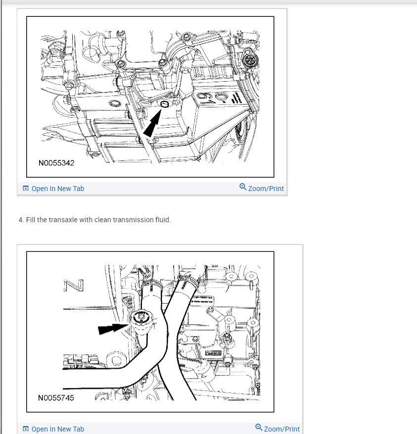

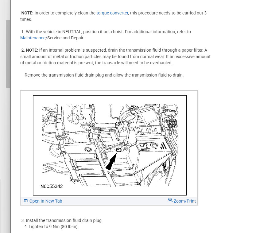

So as for the transmission issue, that could be a fluid issue, but it sounds more like a possible pressure issue. So, I would suggest checking the fluid and making sure it is the correct level and condition.
https://www.2carpros.com/articles/how-to-check-and-add-transmission-fluid
I am attaching the info below from the manual on how to change the fluid. Clearly this is recommended if the fluid is not in good condition.
I would suggest we start with this and go from there.
