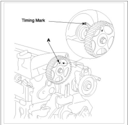

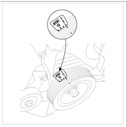

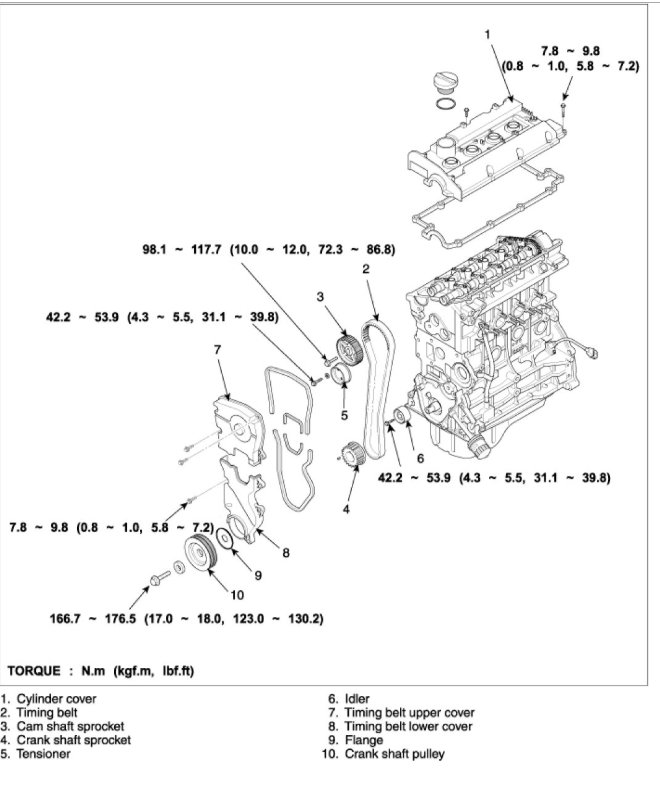

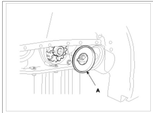

Have my unit checked because of oil leak beneath that was so much. They discovered my crankshaft oil seal should be replaced. When I got my unit, at first it was running smoothly, thought everything was okay, now it runs like I cannot seem to accelerate and say I am running at thirty kmh, and try to push to accelerate, it trembles or cough.
Jun 19, 2018 at 12:11 AM
  • 55,412 POSTS

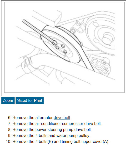

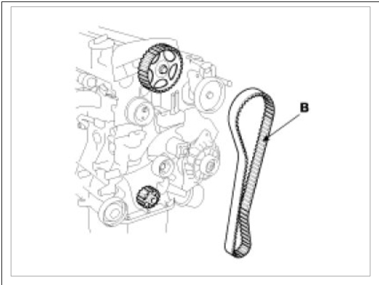

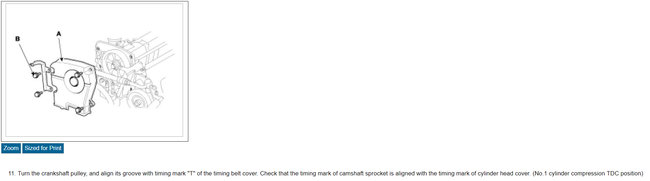

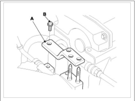

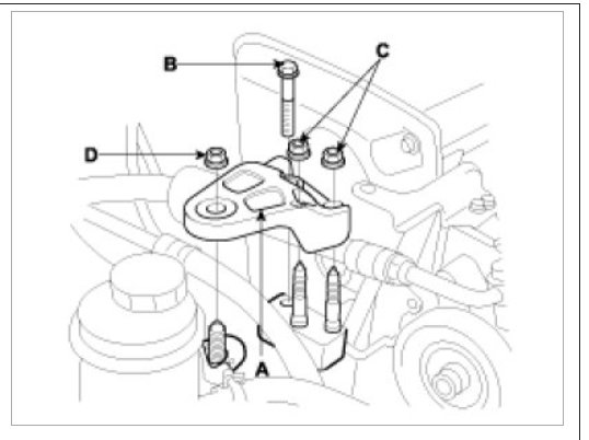

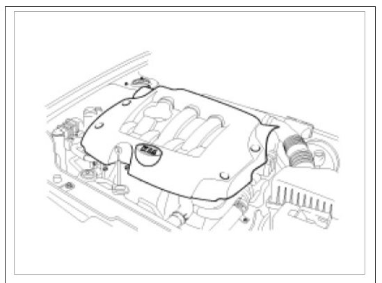

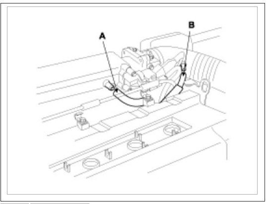

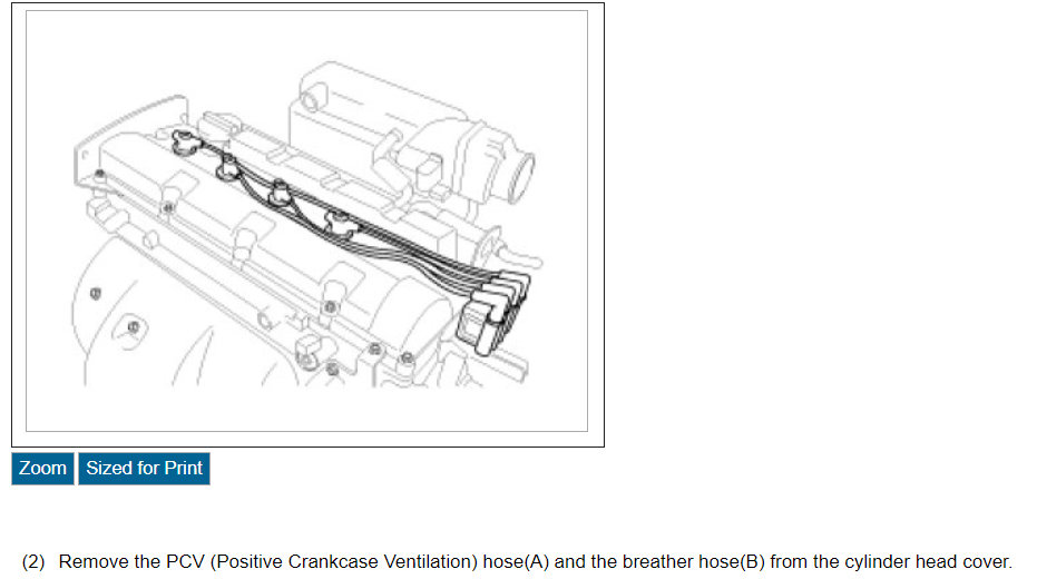

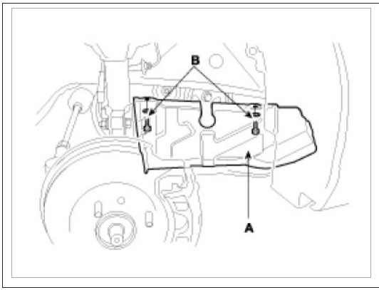

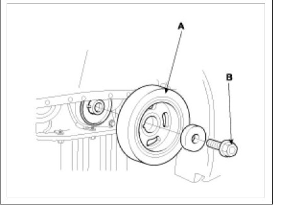

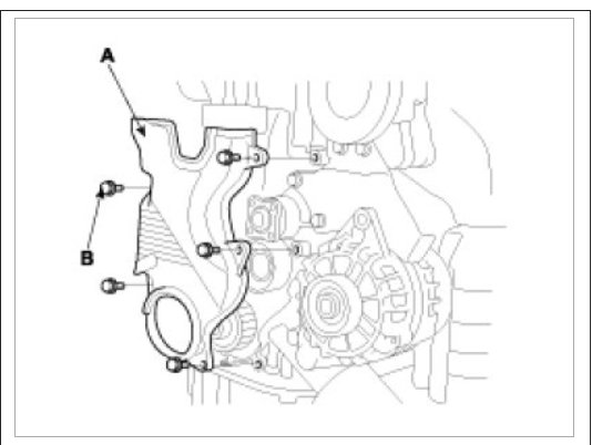

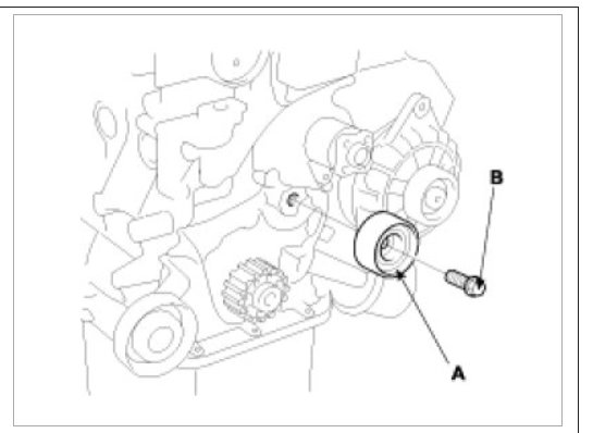

When the front crankshaft seal leaks it can get on the timing belt which will make the engine lose time which sounds like what has happened. Here is a guide to show how to remove the harmonic balancer and the front seal along with diagrams to show you how to replace the timing belt:
https://www.2carpros.com/articles/front-main-seal-replacement
