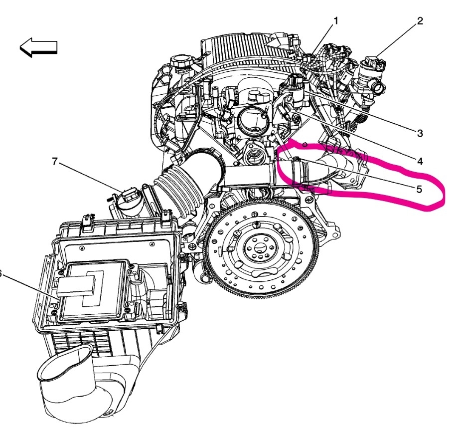

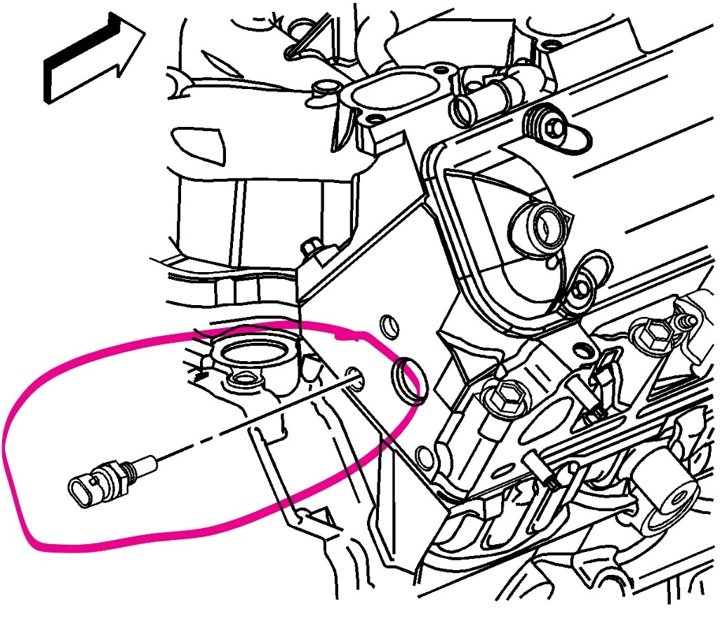

Where is the Cooling Temperature Sensor located?
176,000 MILES • 3.5L • 6 CYL • 2WD • AUTOMATIC
GLEN'S
I can't find it.
Jan 24, 2023 at 11:20 AM
STEVE W.
  • 15,409 POSTS
It is screwed into the right-rear cylinder head on the bellhousing end of the engine. If you are changing it, you either drain the coolant or do the shop vac trick to suck the coolant out. Then unscrew the sensor. Apply thread sealer to the new one and carefully screw it in.
You may need to remove the air cleaner duct to get room.
Jan 25, 2023 at 12:12 AM
GLEN'S
Thanks Steve W. I can see it, now I just have to get at it. The diagrams were a big help.
