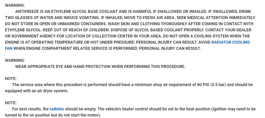

Yes, that's what i mentioned the coolant system was open during some work, didn't mesn 231, meant over the middle where it should not be. What an asking is if there is a coolant relief screw for bleeding these like the grand caravan do. I am familiar with how to so it just need to know if there is one.
Nov 22, 2022 at 9:13 PM
  • 110,244 POSTS

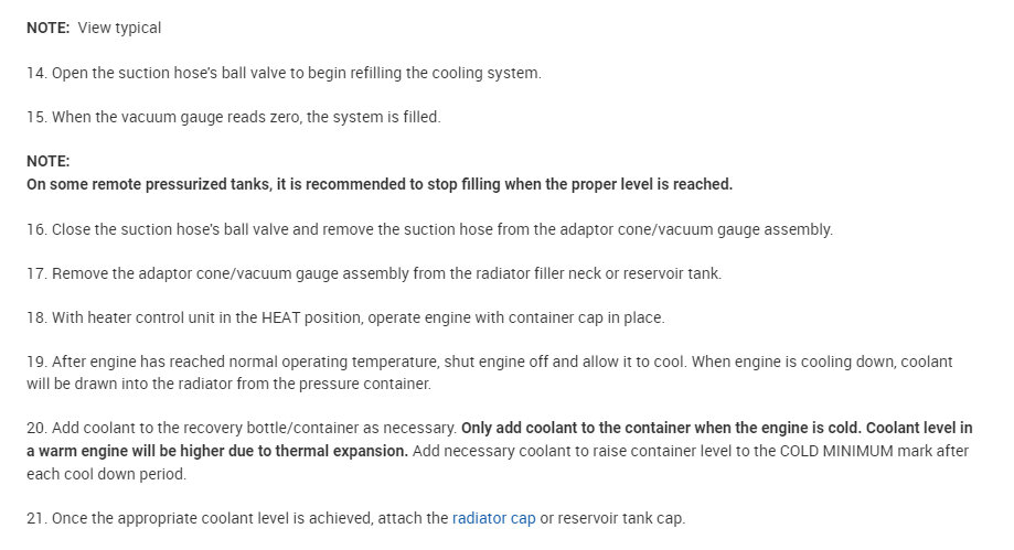

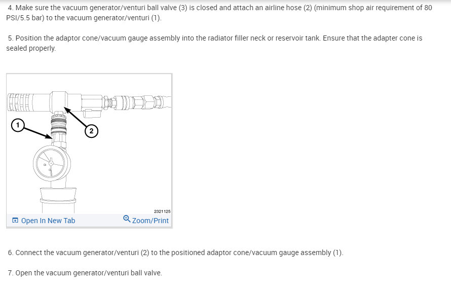

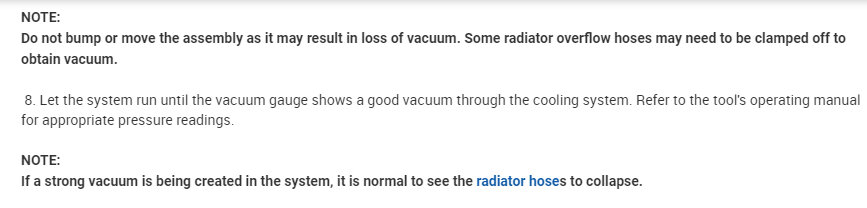

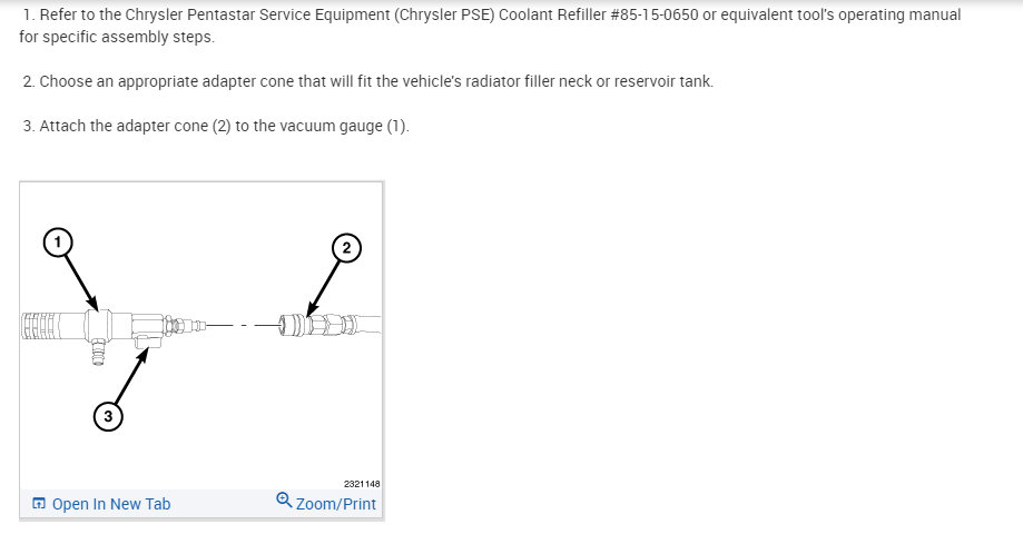

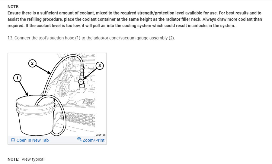

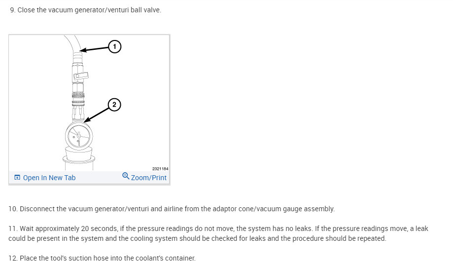

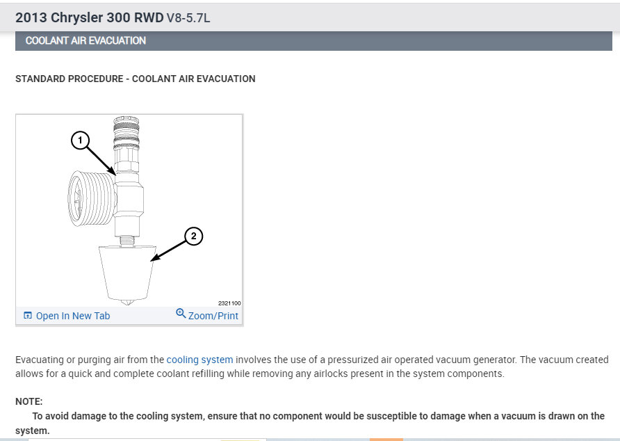

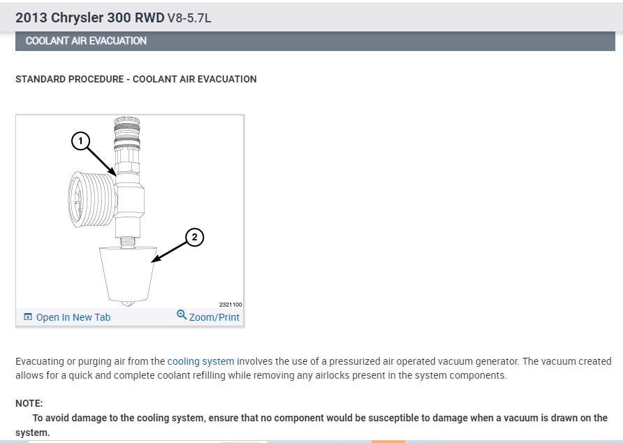

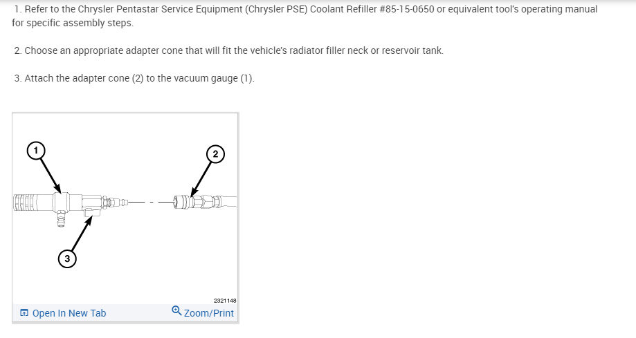

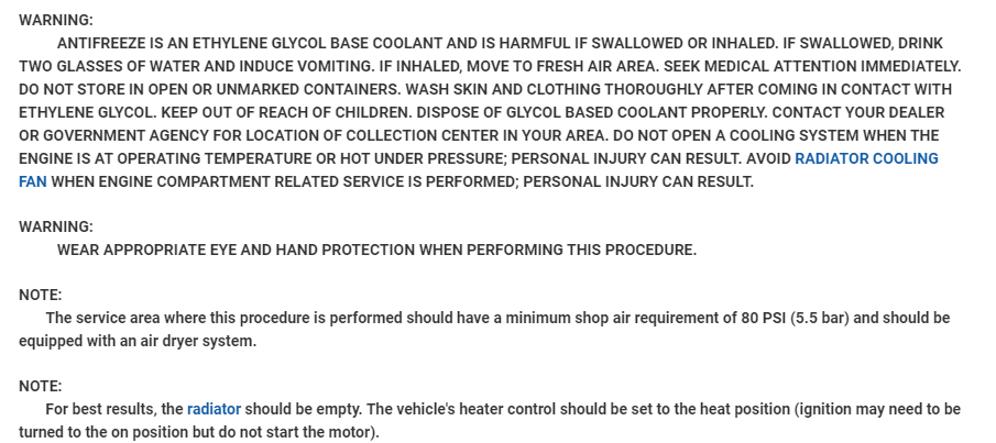

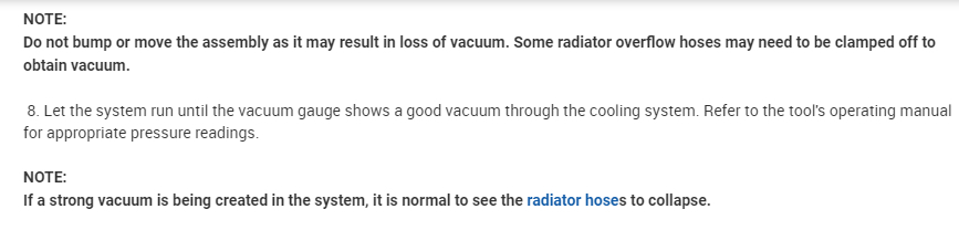

No, there isn't a bleeder. The procedure requires specialized tooling (vacuum generator).
I attached the directions below specific to this vehicle. Take a look through them and let me know if you have questions.
Take care and Happy Thanksgiving.
