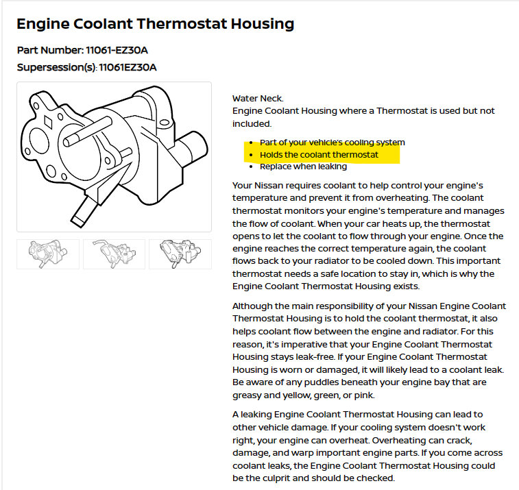

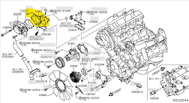

Why can't I find just the thermostat for my truck? All I can find for sale is the thermostat housing. Is this because I have to replace the housing to replace the thermostat or do they sell the thermostat separate for the truck listed above SV model?

Yes, in this instance the housing contains the thermostat. Here is the part number I found 11061-EZ30A.
I am adding a picture from my Nissan catalog as well as a picture of the part on Nissan's parts website. Here is the URL for you:
https://parts.nissanusa.com/p/89453815/11061-EZ30A.html
When replacing it you will need these 2 gaskets:
11062EZ30A-Gasket-Water Outlet
130501CA1A-Gasket
If you go to the dealer, bring your VIN with you as well as these part numbers. Part numbers change constantly so it is best for them to look them up with their information since it will be the most up to date.
You should also be able to give these part numbers to someone at a parts store and they should be able to cross-reference in their system. More than likely you might still have to go to the dealer for the gaskets.

Thank you, Brandon, that answered my question. I have now ordered the part and can get my truck back on the road. This service is great!
