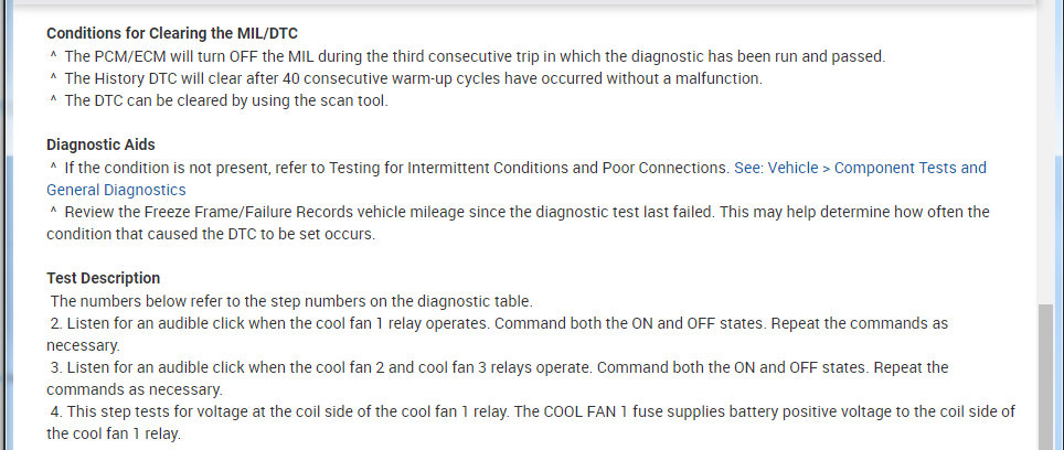

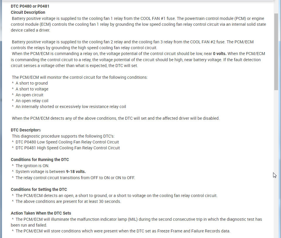

I have a p0481 code on my vehicle and have re­set it and it keeps com­ing back. I check the re­lays, wiring, and fans and they all work as they should. The motor was change about 2 months ago. I heard that there needs to be refrigerant in the compressor for the cooling fans to run but i don't know if that's true. I also don't think it's the temperature sensor because it works on the dashboard. Any help would be appreciated.
Feb 24, 2021 at 2:17 PM

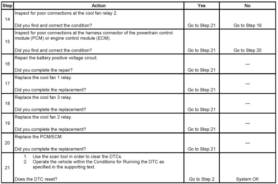

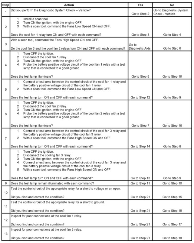

This is not true. The compressor will not run if the system is empty but the PCM will still command the fans on if it needs it.
We need to run through the testing for this code that I attached below. More then likely you have a wiring issue or a relay issue but if you checked the relay then that would leave wiring.
Let me know if you have questions with this testing and we can work through it.
Thanks
Feb 25, 2021 at 7:39 AM
JOSUE RODRIGUEZ2
  • 23 POSTS
It was the PCM.
