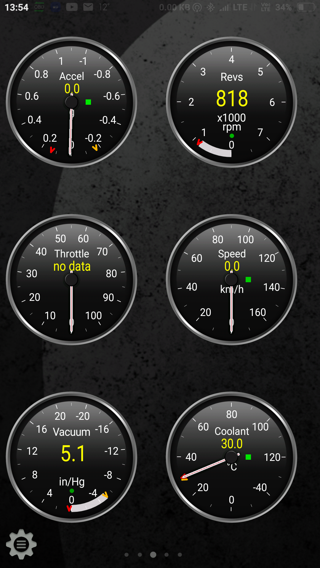

In my car listed above 2.2 I-ctdi, four minutes after starting (as soon as cooling fluid temperature reaches 30 Celsius) the car cooling fans go on and the car starts giving little white smoke out of the exhaust. Changed cooling fluids (no oil in the cooling fluid). Car worked normal for a couple of days, then the problem returned. Changer cooling temperature sensor on the radiator, didn't helped.
Where else to look for solution? Did someone had this problem? Need help.

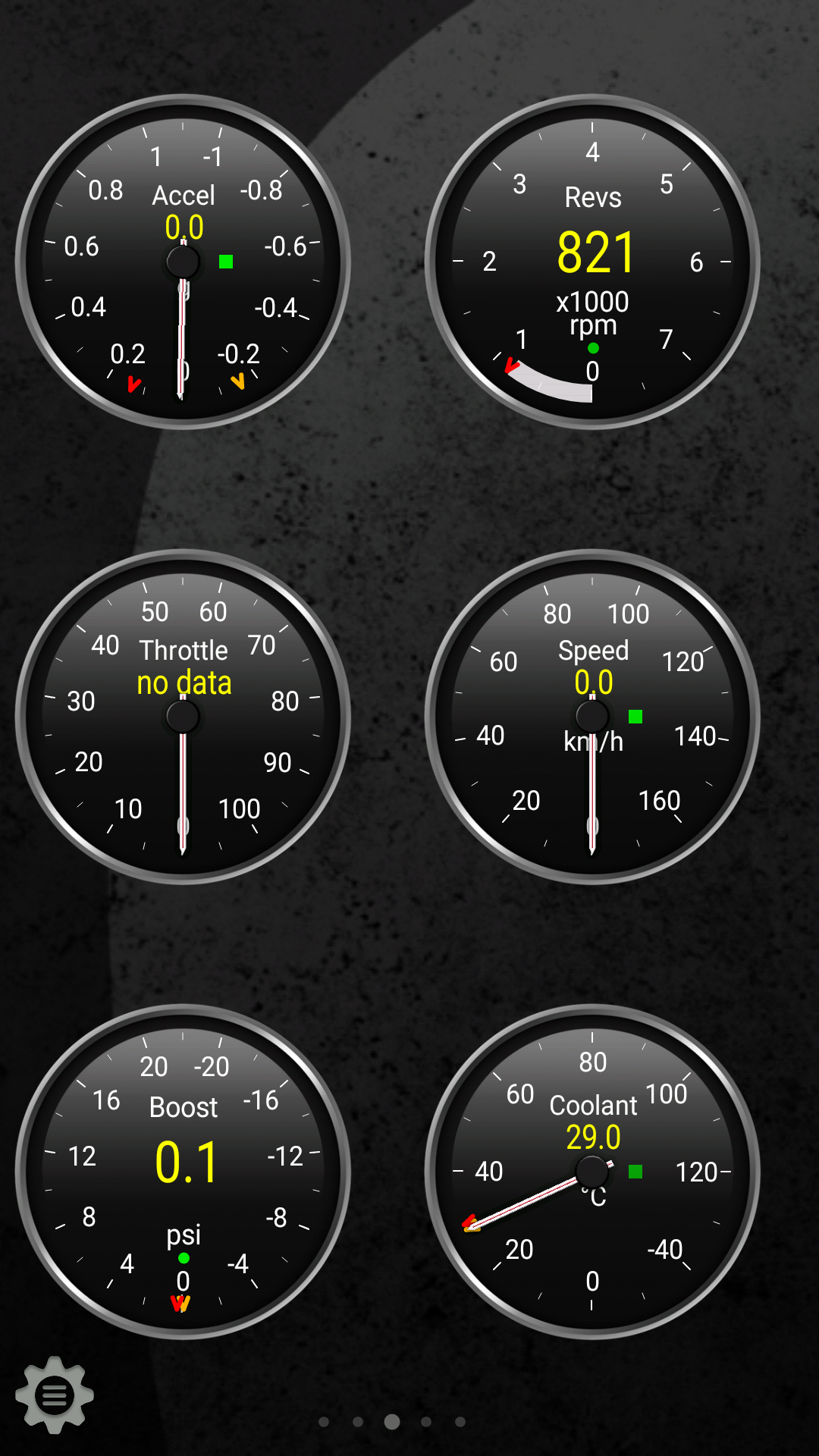

I have Honda Civic VIII FK3 whit 2.2 i-CTDi N22A2 140HP/103KW Diesel (Assembled in Britain). No milky goo on the oil cap, and no Leakages from motor. No overheating(after more than an hour work cooling fluid temperature stay at 75 Celsius) and no indications on missing cooling fluid. Have a couple of screenshots from OBD there's a difference right after cooling fluid temperature reaches 30 fans start to work on high, turning A/C on/off switches fans to low/high.But they don't go off. Before the cooling fans kick in everything is fine after 30 degrees Celsius fans kick in. White smoke is so little that you almost don't see it only when sun shines on the exhaust is it slightly visible.
