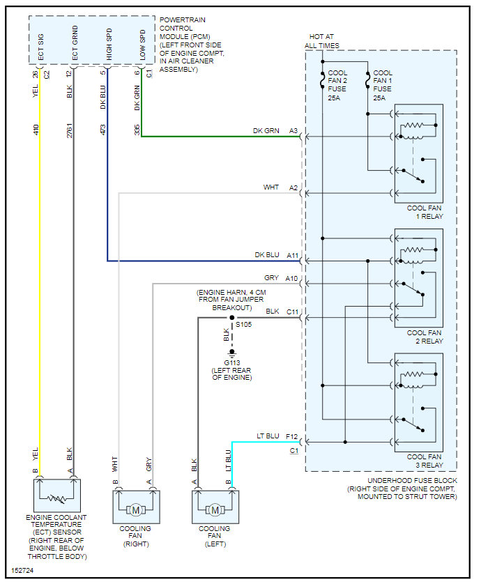

A/C does not blow cold and fans don’t come on. checked all fuses and relays and #2 relay for fan does not work and the plug in for fan has no power.

Take a look at this wiring diagram when you say relay 2 doesn't work, where do you have power and where do you not? The PCM grounds relay number 1 and number 2 in order to get relay number 3 to be grounded and turn on the left fan.
So we just need to find out where we have power and where we do not. If the number 2 relay is not working have you swapped it out?

okay, so i jumped the fan on left and it works but the fan on right threw sparks when i tried to jump it and i have no power to 2nd relay.
Aug 27, 2020 at 10:28 AM
So you jumped power directly to the fan and the right one didn't work?
Then when you check power at relay 2 you have no power from the fuse or the PCM? Take a look at the wiring diagram and tell me where you have no power. Which terminal of the relay?
The relay 2 is the high speed relay so both fans are run off of relay 1 on low speed and 2 on high speed. So we just need to start narrowing down which terminal we we don't have power.
I am starting to think we have an issue with the PCM but we need more info to confirm this. Let me know and we can go from there. Thanks
