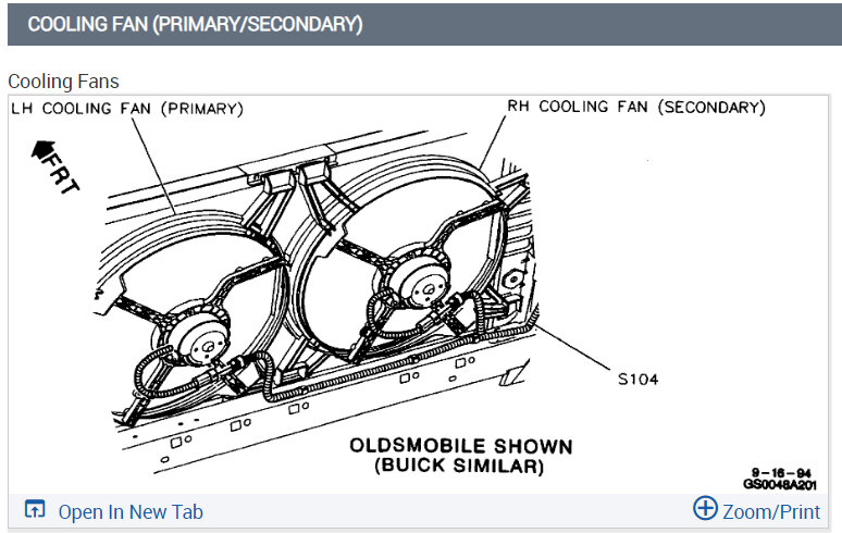

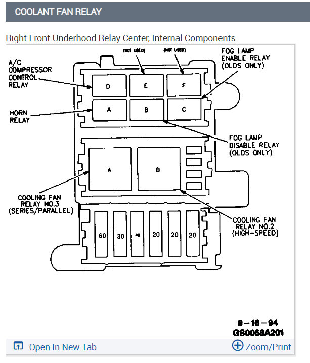

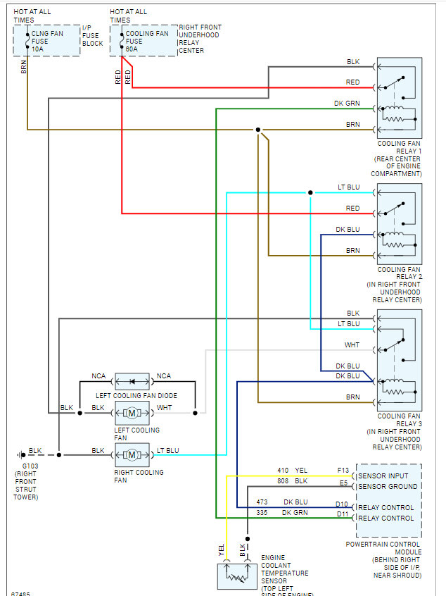

The fans are controlled by the PCM, can I ask you if you turn the A/C system on do the fan kick on? Here is the fan relay location and the cooling fan wiring diagrams so you can check out how the system works. I have also seen the cooling fan motor itself go out which is common. Please go over these guides to help you fix it.
Here is how to change the radiator motor out which once you have it out you can bench test it. The fan motor on the left is the main motor while the right-hand fan motor is the auxiliary fan. Check out the images (below). Please upload pictures or videos in your response to any problems so we can see what to help you with.

Next i will test the fans themselves with 12 volt just to make sure they run at high speed, but if they're running at low speed then i imagine they should run at high speed as well, from what i can see these fans run parallel on low speed so they each get 6 volts for low speed.

Okay, yes, the fans will not work correctly without the climate control working. The reason I asked if the fan worked with the A/C system is because the fans will run with the A/C on which are controlled through the PCM. Also, recheck the system fuses to make sure they have power, you can tell which fuses are used by checking the wiring diagrams above.

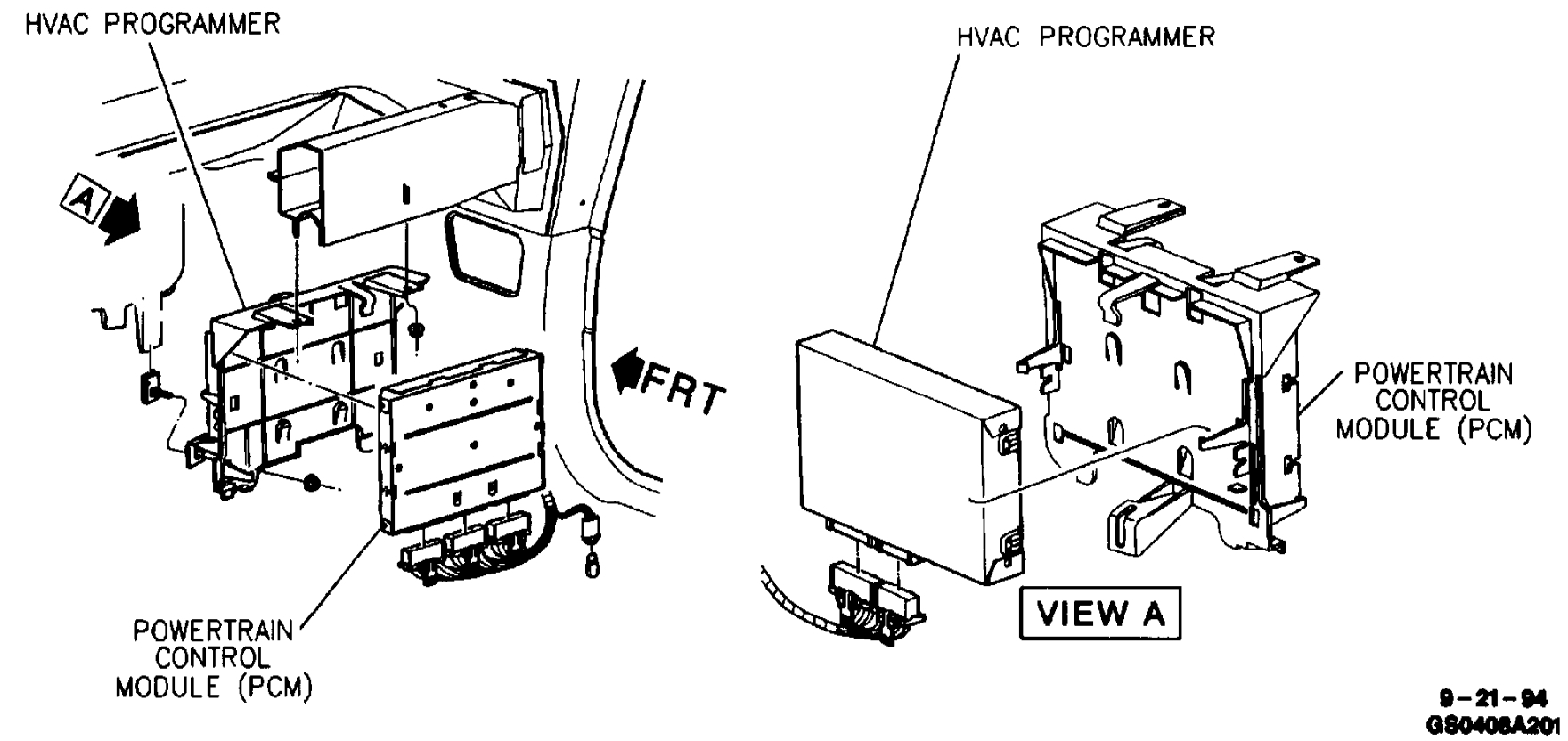

Yep, the HVAC programmers go out in these cars, they are difficult to check without the correct equipment so you might need to send it into a rebuilder to have it checked. Here is the location so you can check it out. Check out the images (below). Let us know how it goes.

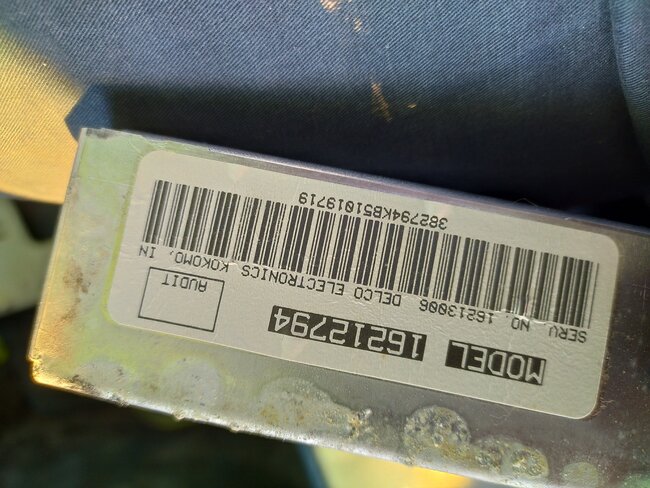

Okay, so i went ahead and ordered an HVAC Programmer from Swan Auto. It's a used one, but that's fine. I installed it and now i have ventilation inside the car. When i turned the air on i still didn't see anything from the cooling fans in the engine bay.
